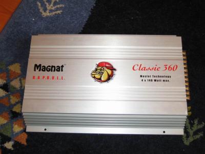

Zasilanie to wysłużony pochodzący z mojego starego zestawu MAGNAT
CLASSIC 360 R.A.P.B.U.L.L. 4X140W Output Power at 20Hz-20kHz nad THD <1%: 4 x 60W @ 4 ohms 4 x 75W @ 2 ohms 2 x 120W @ 4 ohms bridged Output Power DIN 45324, 14,4V: 4 x 70W @ 4 ohms 4 x 90W @ 2 ohms 2 x 140W @ 4 ohms bridged THD: 0.05% (1khz) S/N Ratio: >105 dB Channel Separation: >60 dB Freq. Response: 5Hz ~ 80kHz (-3dB) Fuse: 2 x 20A
