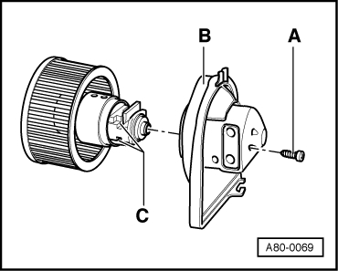

    jezeli jestes pewny, iz to dmuchawa, to prosze bardzo:
    skoda octavia 1.6 rok 1998. wymiana dmuchawyskoda octavia 1.6 rok 1998. wymiana dmuchawy
    CZESC I

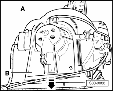

    Removing and installing fresh air blower -V2-
    – Remove series resistor - N24- czytaj czesc II
    – Pull fresh air blower -B- towards the bottom out of the heating.
    – Remove the connector -A- from the fresh air blower.
    Seperate fresh air blower -V2- and base plate
    – Screw out screw -A-.
    – Pull fresh air blower out of the base plate -B-.
    – Installation is carried out in the reverse order.
    Notet Pay attention to the correct fitting position of the connectors -C- when installing the fresh air blower into the base plate.
    t After installing the fresh air blower, check for correct positioning in the heating.

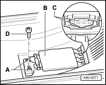

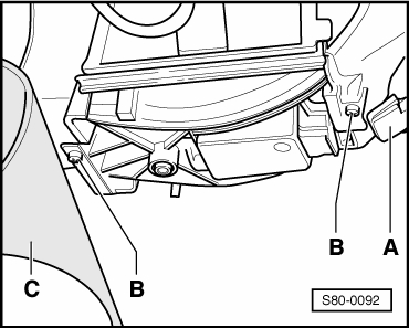

    Removing and installing series resistor for fresh air blower -N24 -
    – Remove screw clip for foam cover.
    – Swing foam cover -C- to the side.
    – Remove the connector -A- from the series resistor.
    – Release screws -B- and remove resistor carrier.
    Remove series resistor from the resistor carrier
    – Bore out or break off attachments -A-.
    – Press back -C- catches.
    – Remove series resistor -B-.
    NoteWhen installing, fix series resistor with sheet metal screw -D- of 3.2x10 mm.
