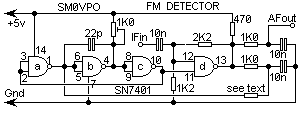

  • Często profesjonalne detektory są złożone z dużej ilości elementów, a ich ceny przekraczają każdego możliwości. Prezentuję tutaj bardzo prosty w wykonaniu i uruchomieniu detektor fm. Potencjometr 1k0 służy do ustawiania środkowej częstotliwości, a rezystor seetext wynosi odpowiednio dla częstotliwości: np. 10k na 250kHz, 560ohm na 1MHz. Odpowiednio musi wzrastać pojemność kondensatora 22pF np.: 570pF dla 455kHz.

    Many times I have been experimenting with QRP and VHF FM and needed a very simple FM detector. Detecting FM requires an amplifying limitor stage as well as coils and diodes. Many IF chips have a built-in detector but these cost a couple of 'bucks/quid/spän', yet still require a bit of setting up. FMIF-DET is based upon a SN7401 quad NAND gate with open collector outputs and perform the same function. The 1K0 pot controls the centre frequency and the 'see text' resistor is selected for the PLL lock range, depending upon the amount of deviation you are to detect. Use 10K for 250KHz to 560 ohms for 1MHz. Increase the 22pf capacitor to 560pf if you want to use this PLL with a 455KHz IF sub-system. The IF input must be at least 350mV for good reliable locking of the PLL.
    Alignment is easy, adjust the 1K0 preset pot with a 10.7 MHz input, whilst watching DC output of the filter (AF out). At some setting the PLL will be in-lock and the voltage will follow the movements of the control. Set the control for 1.8 - 2.2 volts DC.
    This circuit can also be added to commercial HF receivers and transcievers not equiped with FM mode. Additional RF filtering may be necessary in the AF output
