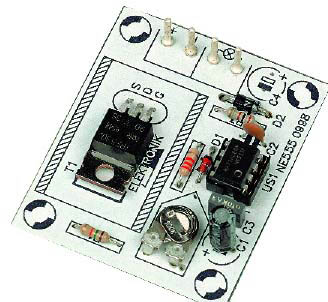

Schemat stroboskopu na 12V, NE555.
Popak 28 Paź 2004 13:18 35280 42
  • Witam wszystkich
    Przedstawiam schemat stroboskopu na 12V z użyciem łatwo dostępnego i taniego układu NE555. Nie jestem autorem tego schematu i całość pochodzi ze strony http://digilander.libero.it/ddanijel/Elektor.htm Niestety tekst jest po angielsku. Ale myślę że poradzicie sobie z tym.

  • #2 944796
    zasoby
    There are inexpensive stroboscopes on the market that can be screwed directly into an
    E27 socket. Such devices already have the circuit to the right of mains transformer Tr 1
    in the diagram. To enable the stroboscope to be operated from 12 V, a 12-240 V
    converter needs to be fitted inside the housing.
    The circuit of the converter is simplicity itself. Diode D1 is a polarity protection device
    that may be omitted. A 555 is used as an astable with a frequency of about 0.7 Hz. When
    T1 is on, a current flows through the 6 V winding of Tr 1. The voltage across the 240 V
    winding must be such that D2 does not conduct. This may be ensured with the aid of an
    oscilloscope. When the collector voltage of T1 is nearly 0, the potential at the anode of
    D2 must be negative. When T1 becomes reverse-biased, its collector voltage rises to
    about 12 V and the potential at the anode of D2 must then be positive, so that C4 can be
    charged. Check these voltages, but carefully they may be lethal!
    Never operate the convertor without a load. It is, perhaps, advisable to shunt C4 with a
    100 kOhm, 1 W, resistor. The convertor charges C4 to about 300 V. This causes a
    potential at junction R6-C5 of about 100 V. The neon lamp then comes on, so that a gate
    current flows into the thyristor. This comes on and clears the way for C5 to discharge
    through Tr 2. This starting transformer produces a secondary voltage of a few thousand
    volts. This is sufficient for the xenon tube to strike and at the same time discharge C4.
    From then, the operation can start again.
    The circuit draws a current of about 250 mA, but this depends on the flashing rate and
    the type of xenon tube.
    no tak wygląda na stroboskop składający się z prostej przetworniczki z 12V na 230V oraz układu wyładowczego sterującego lampą. Projekt przewijał się na elektrodzie. Nie będziemy wnikać w działanie a warto opisać budowę. Z tego co widać potrzebny jest zwykły niewielki transformatorek. Po oznaczeniach widać, że wytrzymałość uzwojenia 6V wynosi 200mA. Jest to transformatorek 1,2W (VA). Później jest układ wyładowczy, zastosowano tam lampkę neonową? A może lepiej zwykły rezystor? Niemniej lampka neonowa może być dobrym sygnalizatorem poprawności generowanych impulsów. Później jest standardowy transformatorek stroboskopowy do kupienia w każdym sklepie podbijający napięcie do tysiąca wolt no i lampa wyładowcza. Konstrukcja banalna.
    Dla tych co mają oscyloskop warto zwrócić uwagę na punkty kontrolne do sprawdzenia przebiegu. Warto też sprawdzić napięcie około 300V za przetworniczką.
  • #3 945001
    oj
    Na tej właśnie neonówce został zrealizowany układ wyzwalania palnika i nie może zostać zastąpiony rezystorem
    Napięcie zapłonu neonówki w zależności od typu wynosi 60-90V i gdy ona nieświeci nie przewodzi prądu co powoduje nieprzewodzenie tyrystora >> zapłon palnika. Z przetwornicy po wyprostowanu jest ładowany kondensator C4 i rośnie powoli na nim napięcie. Dzielnik R4, R5 wyznacza napięcie układu zapłonu i przy napięciu 300V na C4 na R5 będzie ok. 81V. Z tego napięcia jednocześnie przez R6 jest ładowany kondensator C5, którego ładunek po załączeniu tyrystora w obwodzie tyrystor-kondensator-uzwojenie pierwotne TR2 spowoduje, że po przetransformowaniu na uzwojeniu wtórnym tego transformatora pojawi się impuls wysokiego napięcia. Wyzwolenie tyrystora nastąpi wtedy, gdy napięcia na neonówce przekroczy właśnie napięcie zaponu neonówki; R6-neonówka-bramka tyrystora-katoda tyrystora. Po zapaleniu się jej, na wskutek wyładowania się palnika, nastąpi szybki spadek napięcia na C4 co spowoduje wyłączenie się neonówki oraz rozłączenie się tyrystora po zmniejszenia się napięcia na Anoda-Katoda. Proces zaczyna się od początku...
    Częstotliwośc migania palnika wyznacza napięcie zapłonu neonówki oraz szybkość ładowania kondensatora C4 przez przetwornice. Częstotliwość można zmienić zmieniając napięcie dzielnika R4,R5 lub wartość pojemności C5 ale w bardzo małych granicach.
    Napięcie pracy C5 powinno być wyższe niż podano na schemacie ok. 250V-
    Szeregowo z neonówką też powinno się włączyc rezystor ze 470 omów, bo można przekroczyć maksymalny prąd bramki tego tyrystora

  • #8 977774
    Marek_RADOM
    Witam zrobiłem ten stroboskopi nawet go lekko przerobiłem. Zastosowałem kondensator na 450V i mocniejszy teanzystor sterujacy trafem. Dadalem także przekaźnik sterowany tranzystorem podłaczonym do portu LPT w komputerze. Styki przekaźnika podłaczyłem do neonu.Dzieki temu mogę sterować stroboskopem z Winampa. Szkoda, ze za wolno sie ładuje kondensator i za wolno błyska, ale jak na 12V i i tak sukces, gdyż to mój pierwszystroboskop. Jeśli ktoś wie jak zmodyfikować układ zeby szybciej się ładował kondensator niech napisze do mnie na gg 5277598 lub się odezwie na forum
  • #9 978880
    oj
    To jest bardzo prosta przetwornica i nie ma jak zwiększyć jej wydajności.
    Można spróbować zwiększyć częstotliwość przez zastosowane zamiast prostownika jednopołówkowego, zastosować dwupołówkowy z powielaczem napięcia tak jak jest to zrobione w J-23.
    Zastosowanie powielacza spowoduje, że w któtszym czasie pojawi się dostatecznie wysokie napięcie na tym kondensatorze zdolne do spowodowania wyładowania w palniku lub/oraz zastosować palnik o niższym minimalnym napięciu zapłonu.

  • #13 1007009
    Rekin1980
    Nap5teR napisał:
    Podobną, a wręcz identyczną konstrukcje oferuje Nord Elektronik. Kto wie czy to nie przypadkiem to samo.
    Ok a gdzie to kupic? i jaki tego jest symbol bo na pewno nie ne555
