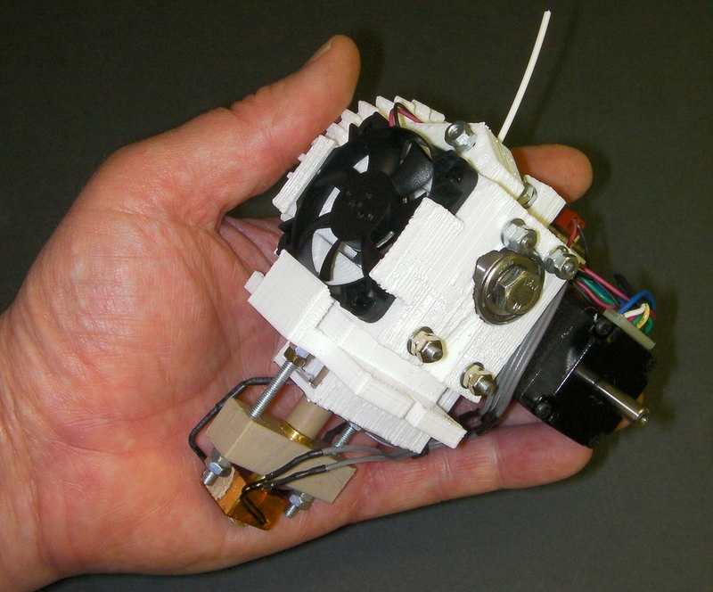

    This printable extruder is intended to work on RepRap Mendel (both standard and Prusa), RepRap Huxley, and virtually any other open-source 3D printer you can find.
    It features:
    1. 1.75 mm filament
    2. Adaptable mounting plate to attach it to virtually any 3D printer
    3. Very compact high-torque NEMA 11 motor
    4. Active ducted fan cooling for high reliability
    5. Wade-style hobbed bolt filament transport
    6. Wing-nut drive to spread the torque loading on the plastic gears
    7. Push-fit hot-end parts - no thread cutting
    8. Easily replaced PTFE liner for the hot end
    9. A single M3-threaded rod cut to lengths makes all the fixings
    10. Lightweight: 420g
    11. Compact design (110 mm x 90 mm x 80 mm)
    I based this design (loosely) on Jstkatz's extruder (Link), in particular, the idea of using a lever to trap the filament against its drive.
