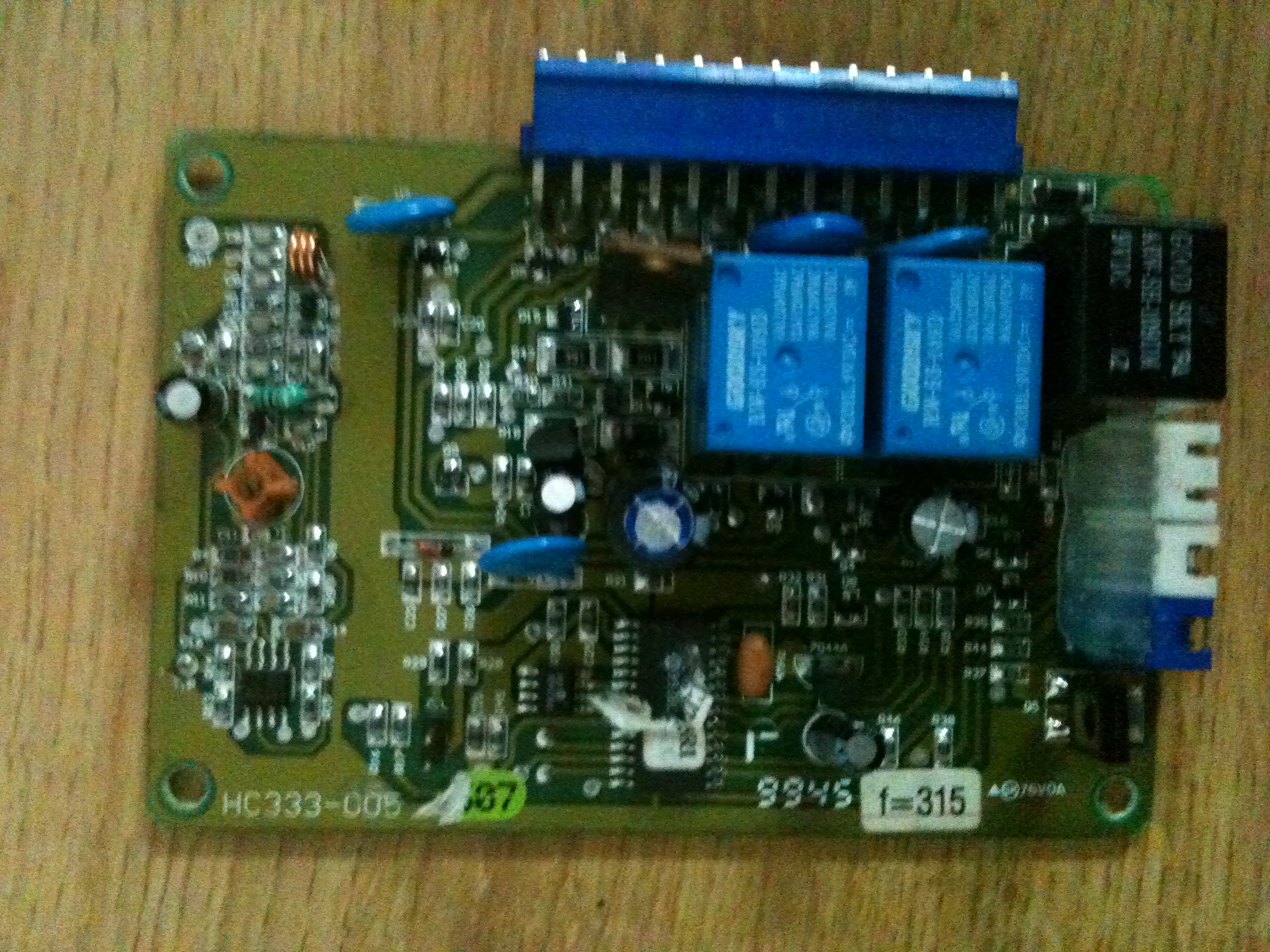

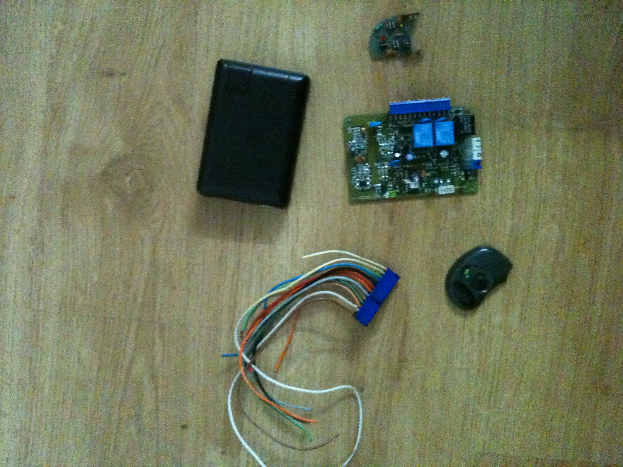

    Hello! im searching for installation manual to connect alarm to my mk4 golf. The alarm did not write which model Is, i find some similar (aps100) but I can not find a pattern linking. Can anoyne help me ? Greetings from Macedonia!

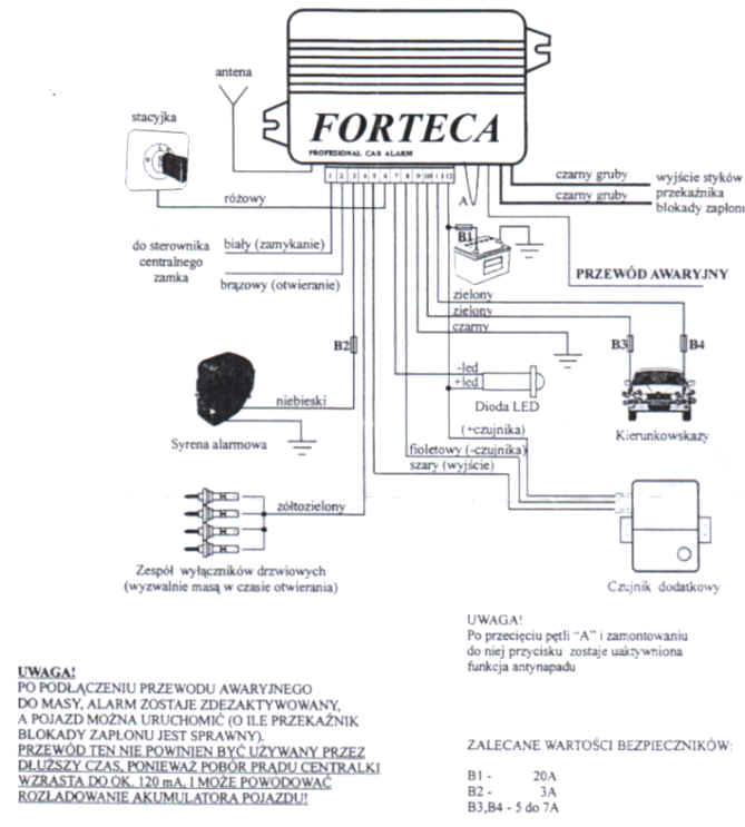

    Thanks! is it possible to find this diagram in english?
  • #4 12304077
    milejow
    1-door closed
    2-door open
    3-siren
    4-door contact switch
    5-external sensor-input signal
    6-ignition
    7-led indicator(-)
    8-external sensor-ground
    9-groung
    10-turn signal lamp
    11-turn signal lamp
    12-battery+(led indicator+)
    Thick, black cables-blockade (for example fuel pump)

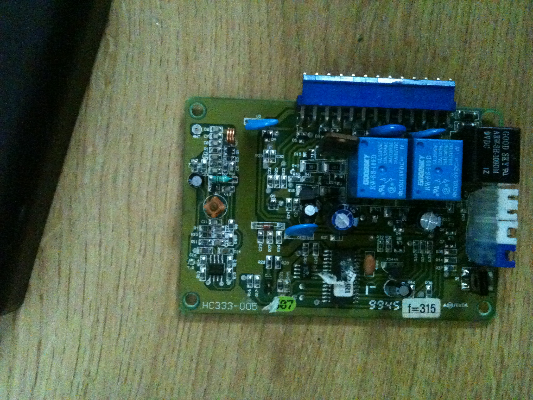

    It is not correct diagram for Your alarm system.
    It looks like Power Guard HC333 I think...
  • #6 12312233
    boko88
    Yes, it is the hc333 and i found the wiring diagram. I will use that only for remote central lock and Now i have problem with wiring the central lock on golf 1999 i want to Wire in driver door central lock multiplexer but i cant find any diagram for that
