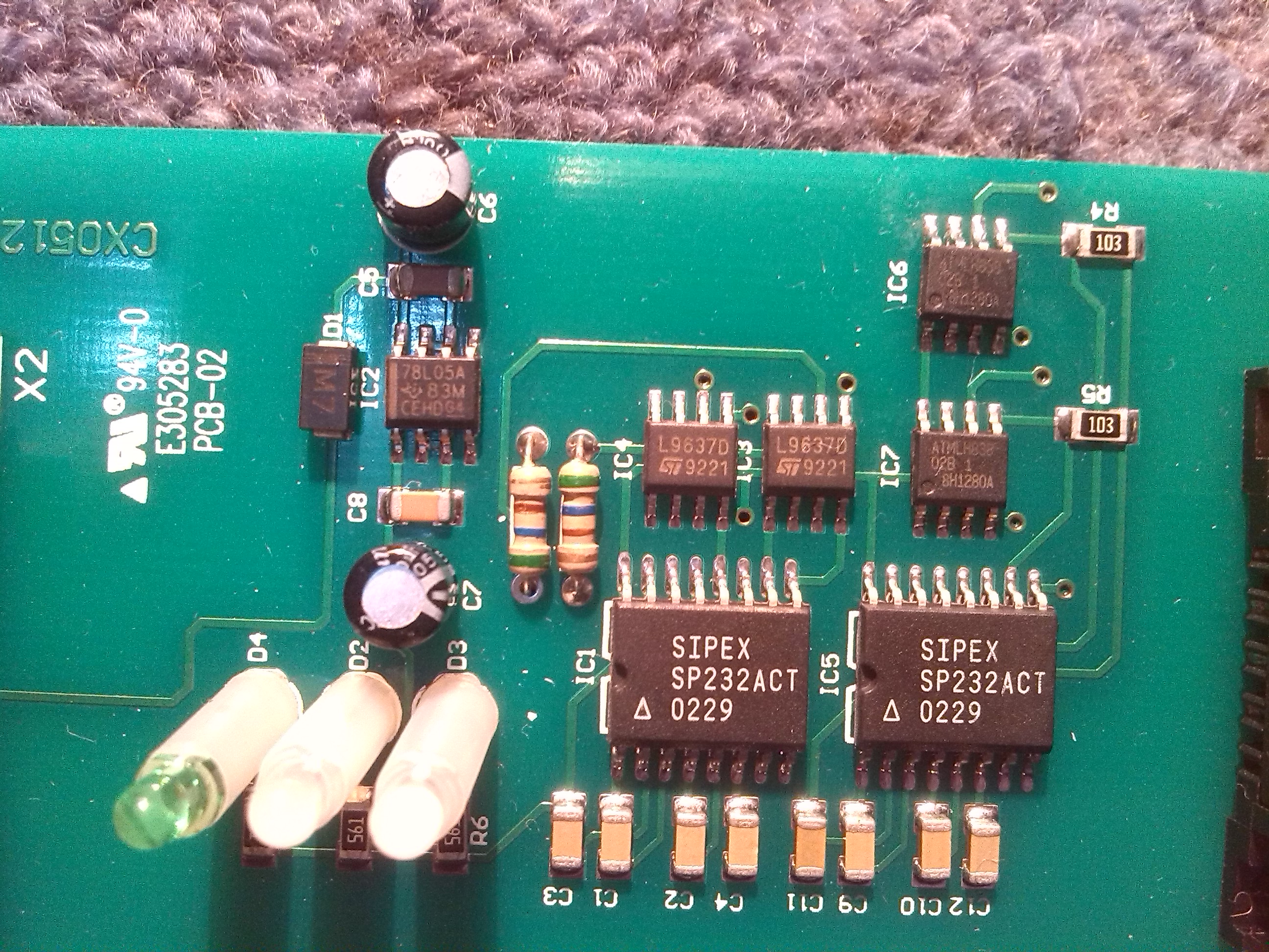

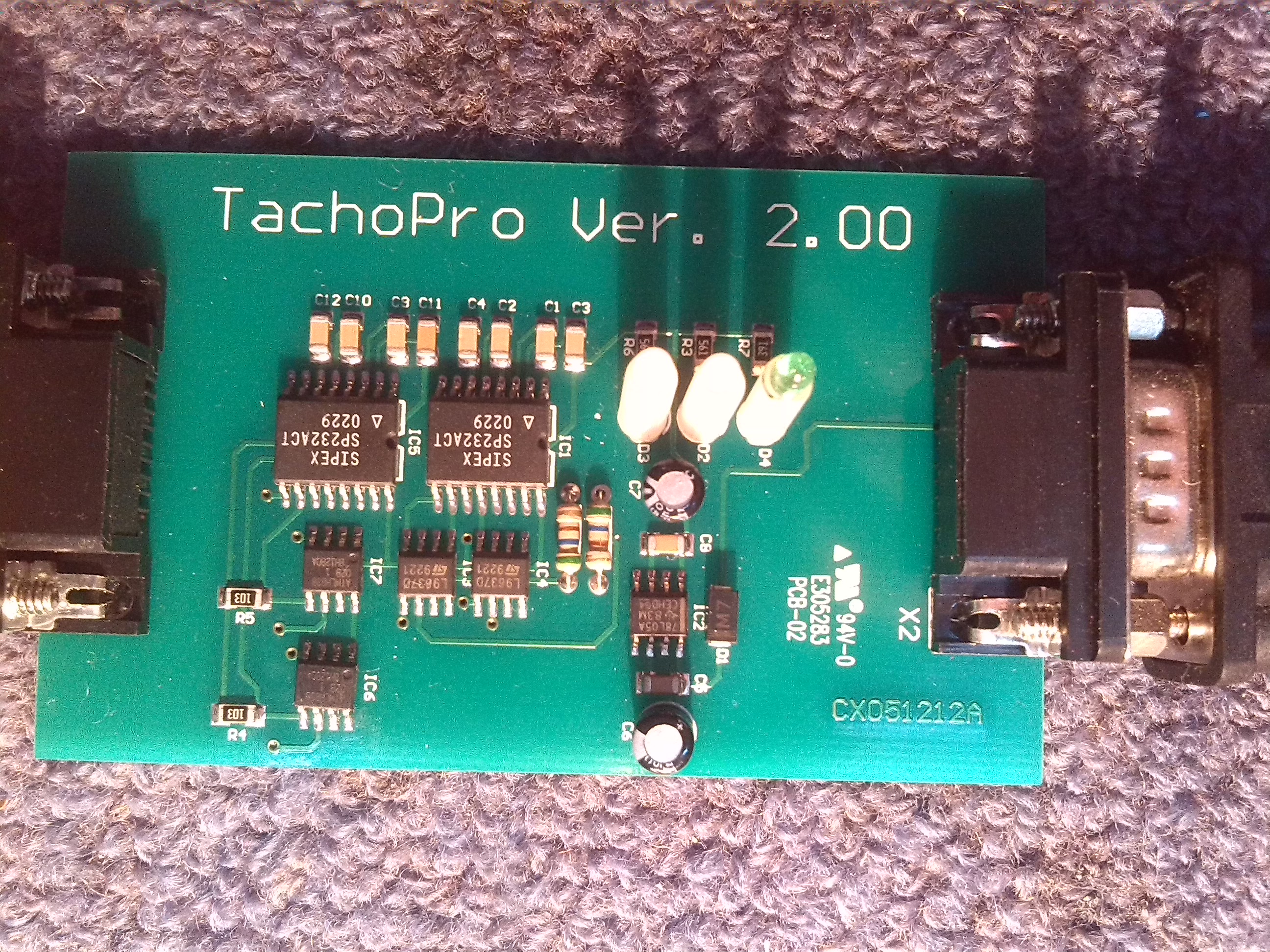

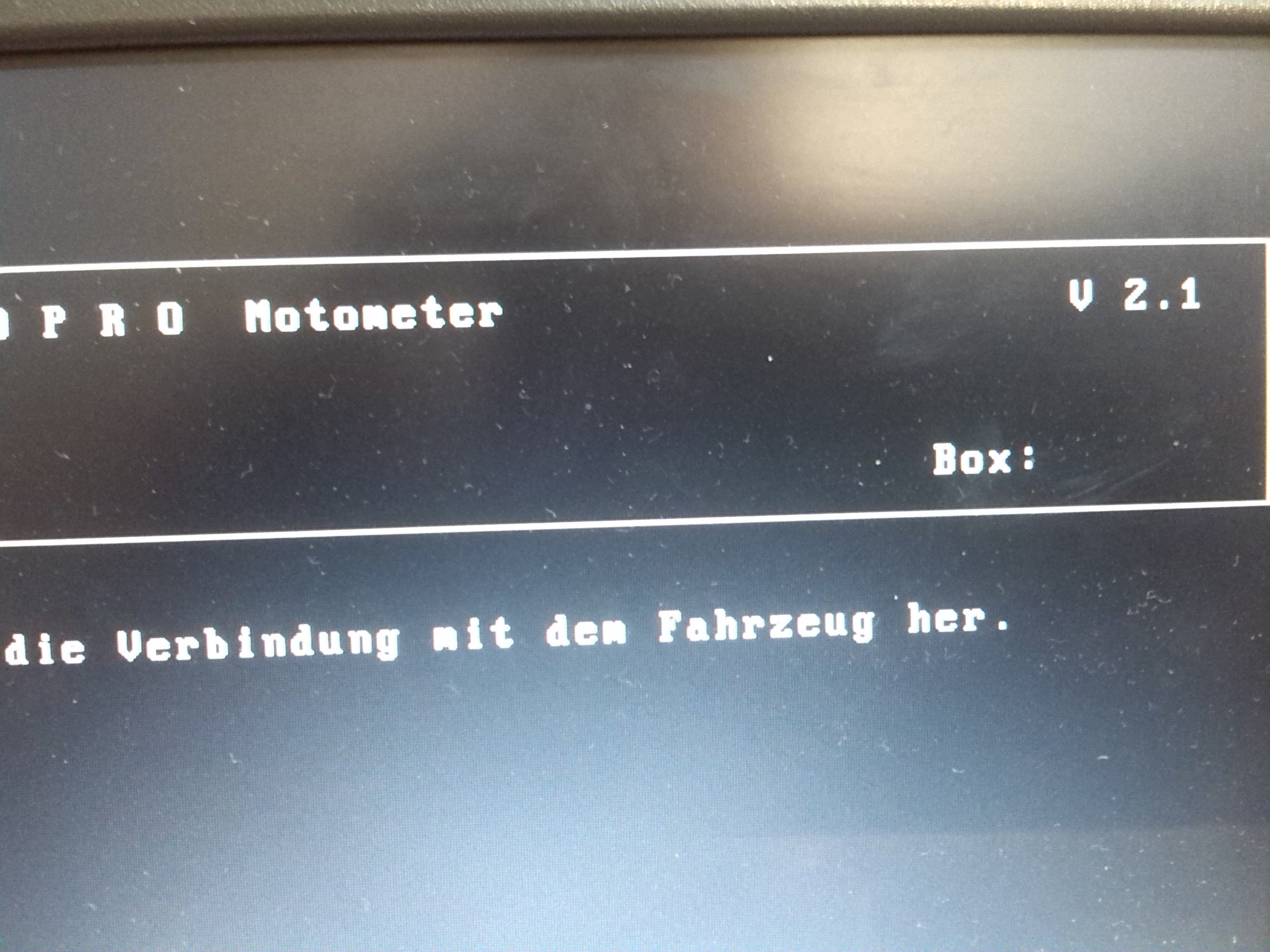

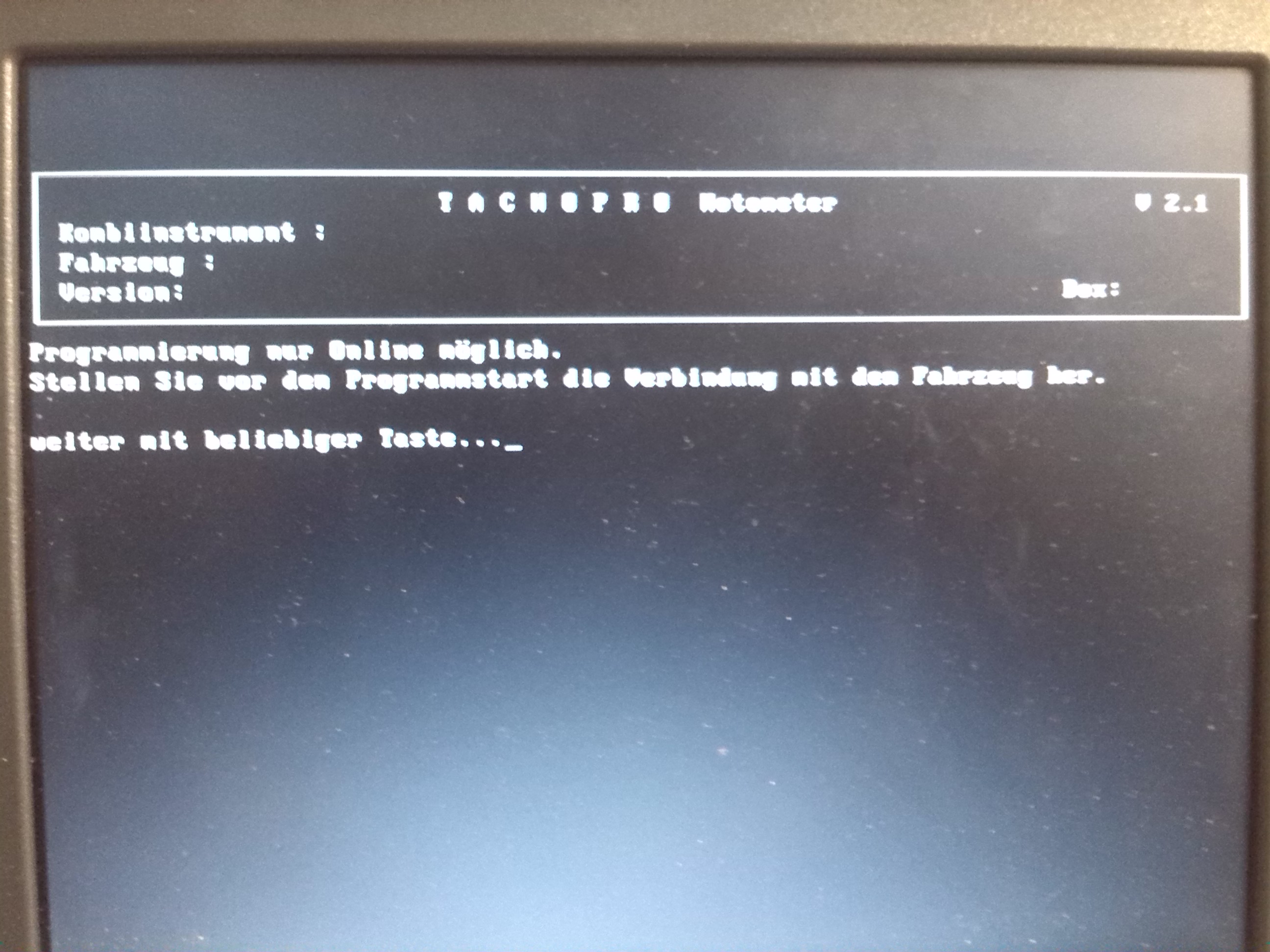

    I took it Tacho pro kit 2.0 for Sharan Galaxy Alhambra pasat magneti Marelli hc11kg4 for this need, but has not worked from the start I do not know why .. sovtwear not see interface ..why???. I have a car prog 4.01 (china) but I am not satisfied..

    well all I know. okay I made a second tacho Box 30039 works perfectly .. but I'm interested in why not this other TachoPro Kit 2.0, (clone)this black box some say that some work some do not why??it is purely out of curiosity! if someone can explain to TachoPro Kit 2.0 I see that in him there is no EEpromu 24C02 first and second how is he doing? general or why not?
