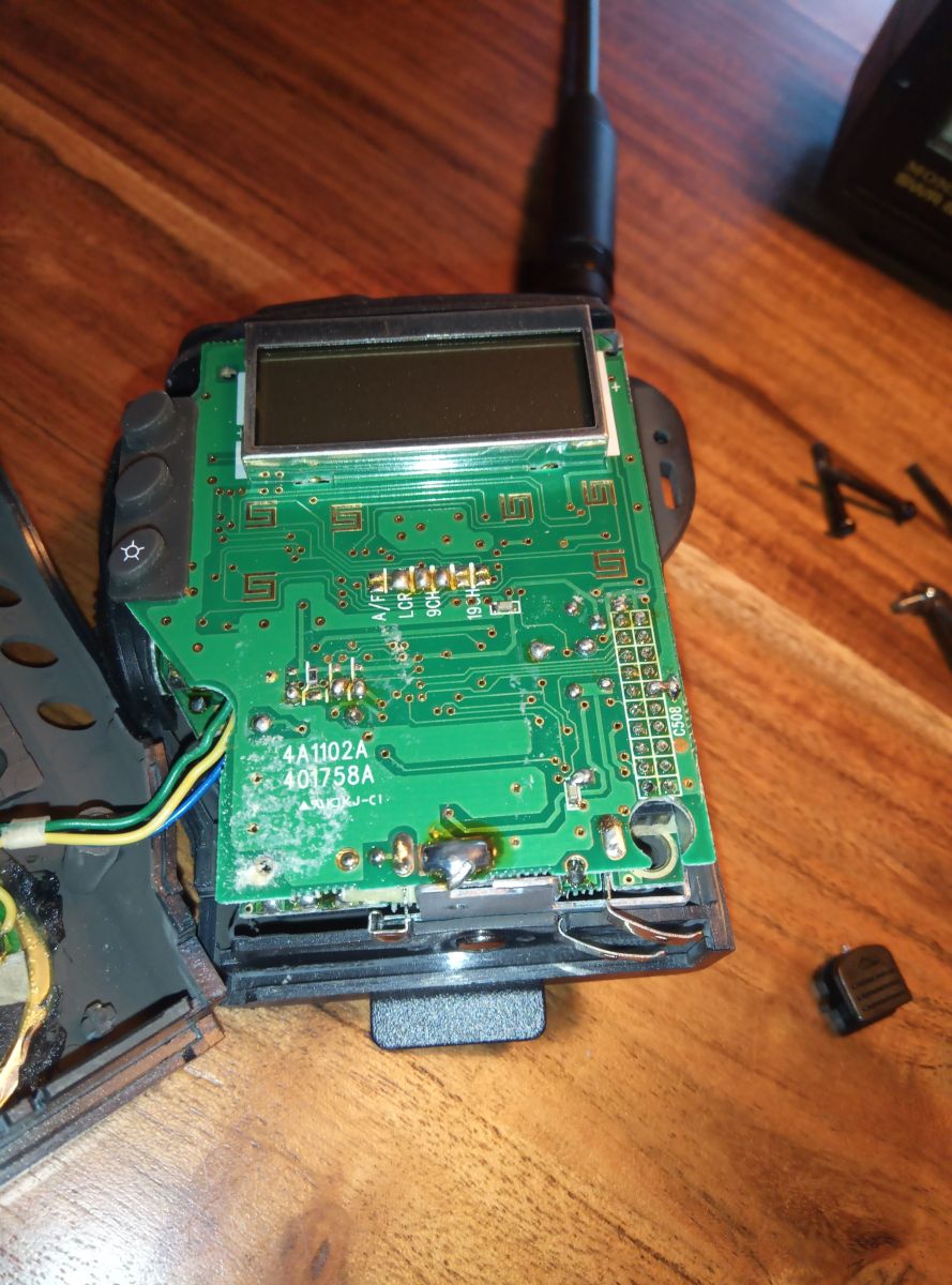

  • #11 18376351
    Wolf82
    Hello there,
    Sorry for leaving this message in English. I don't speak Polish, so I hope one of you guys will use Google Translate.
    I'm from Holland and I've bought a Midland Alan 42 E40. I want to enable all 400 channels but there's almost no information how to do this on the predecessor of the Multi.
    The 4 jumpers are open, open, closed, closed, from left to right. I've removed the 2 closed jumpers on the right, but I have no 400 channels yet.
    I also haven't found a button sequence to change the channels yet, so I think it's only done by jumpers.
    What about the jumpers underneath the display, starting from left to right with A/F, LCR, 9CH and 19 CH...
    Do I have to change something on these jumpers? Do I need to do anything else to reach the 400 channels?
    I have attached a picture of how the jumpers are when I received it.
    Hoping for a reply in any language, Google Translate will help!
    Regards, Wolfert

  • #12 18389719
    radarek
    0011 : 40CH-5kHz-all AM/FM
    you must change the setting to
    The 4 jumpers are open, open, open, open
    0000 : 400CH-5kHz-all AM/FM
    the channels are 40 in the ranges from A to L you change as before starting from A1 to L40 using the channel change buttons under the transmit button
