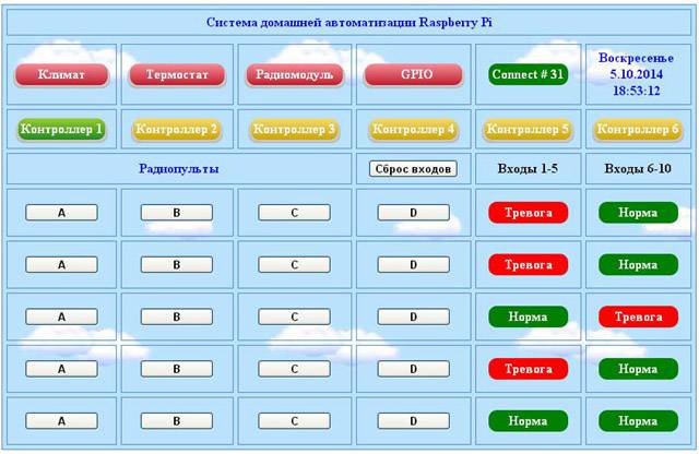

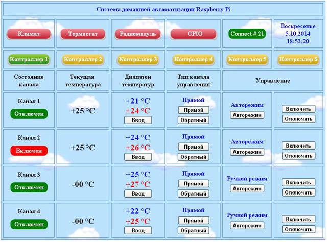

    Here I show the form of web-interfaces for various controllers. Access to the interface can be accessed via a password from your browser. This allows you to drive home from any location with Internet access
    Climate web-interface:
    System home automation Raspberry Pi
    Thermostat web-interface:
    The radio module web-interface:
    Output Ports Raspberry Pi:
    controller with a set of I / O web-interface:

  • #6 14454671
    Bar_boss
    _sebs_ napisał:
    This looks really interesting..
    Thank U!
    _sebs_ napisał:
    1. how collisions on rs485 are handled?
    2. what is the architecture of this bus? Can only master talk to slaves, or a slave can also initiate a connection to the master?
    Raspberry Pi sends a request and the controller only responds to this request. The controller can not initiate a transfer. Therefore, there are no collisions.
    _sebs_ napisał:
    3. did you roll out your own distribution? If not, which one did you adapt?
    Home automation system built on the framework - WebIOPi - http://electromost.com/news/raspberry_pi_dlja...ej_avtomatizacii_chast_vtoraja/2014-02-20-116
    _sebs_ napisał:
    4. all sensors are powered via UTP: how many sensors and what current can be sinked that way (from your experience)? What are voltage dropout with the last sensor? Is it a problem for you?
    At maximum load is not checked :( . In UTP can be free line connected in parallel - this will increase the load current
    _sebs_ napisał:
    5. How do you program your frontend (what s/w stack is used) ?
    Access to the server is done through home router. The IP address of my dynamic - so I use DDNS service – http://dyndns.com
