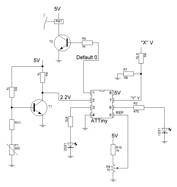

    Programowanie ATTiny w Bascom: Wybór modelu i konfiguracja pinów
    Sorry for only english .
    Here is a ATTiny connected as the above schematic. Clock must be the internal clock. Datasheet says 4.8/9.6MHz . I think 4.8 is enough.
    I want help for a program in Bascom .I see that ATTiny13 is not the perfect one for the task .
    May be ATTiny25 or ATTiny45 will be good .
    The things are :
    PIN1 default 0
    REF is a voltage external reference manually set (acting as GATE).
    If the "Y" > REF -> LED1 ON -> PIN1 ON (relay on)
    If PIN2 is >2.2V -> LED2 ON ->PIN1 ON (relay on)
    Thanks to all that can help for the program.

    DJ_DOGGY
    It have problem with Relay . It`s always ON nevermind what conditions are met.
    Leds working as they should be.

    DJ_DOGGY
    Yes, for the schematic .
    Saw the bit for External reset .I programmed it right and all is OK now.
    And now working as should be .
    Thanks for your efforts.
    Schematic was edited because i was thinking that 13 is not compatible with what i want.
    But looks like it works :)
    I simulaed in Proteus . Good program for such need.

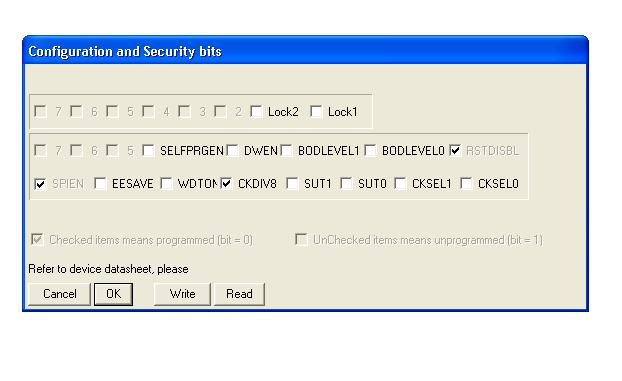

    DJ_DOGGY
    niveasoft ,
    Can you tell me if these fuses are the right for the program ?
    The RSTDisbl and SPIEN are greyed out but i manipulated the image with the "checkbox" . I think this is because i don`t have programmer connected to the ponyprog . But it will be.
    Is there any other fuses to be checked ? CKSEL fuses may not be checked because default clock for Attiny13 is 9.6MHz , and CKDIV8 is enough ?
