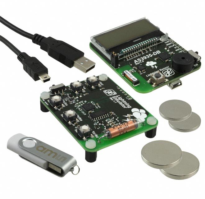

    Można kupić np tutaj - http://www.digikey.com/product-detail/en/AS3935-BQFT/AS3935-BQFTCT-ND/3182215
