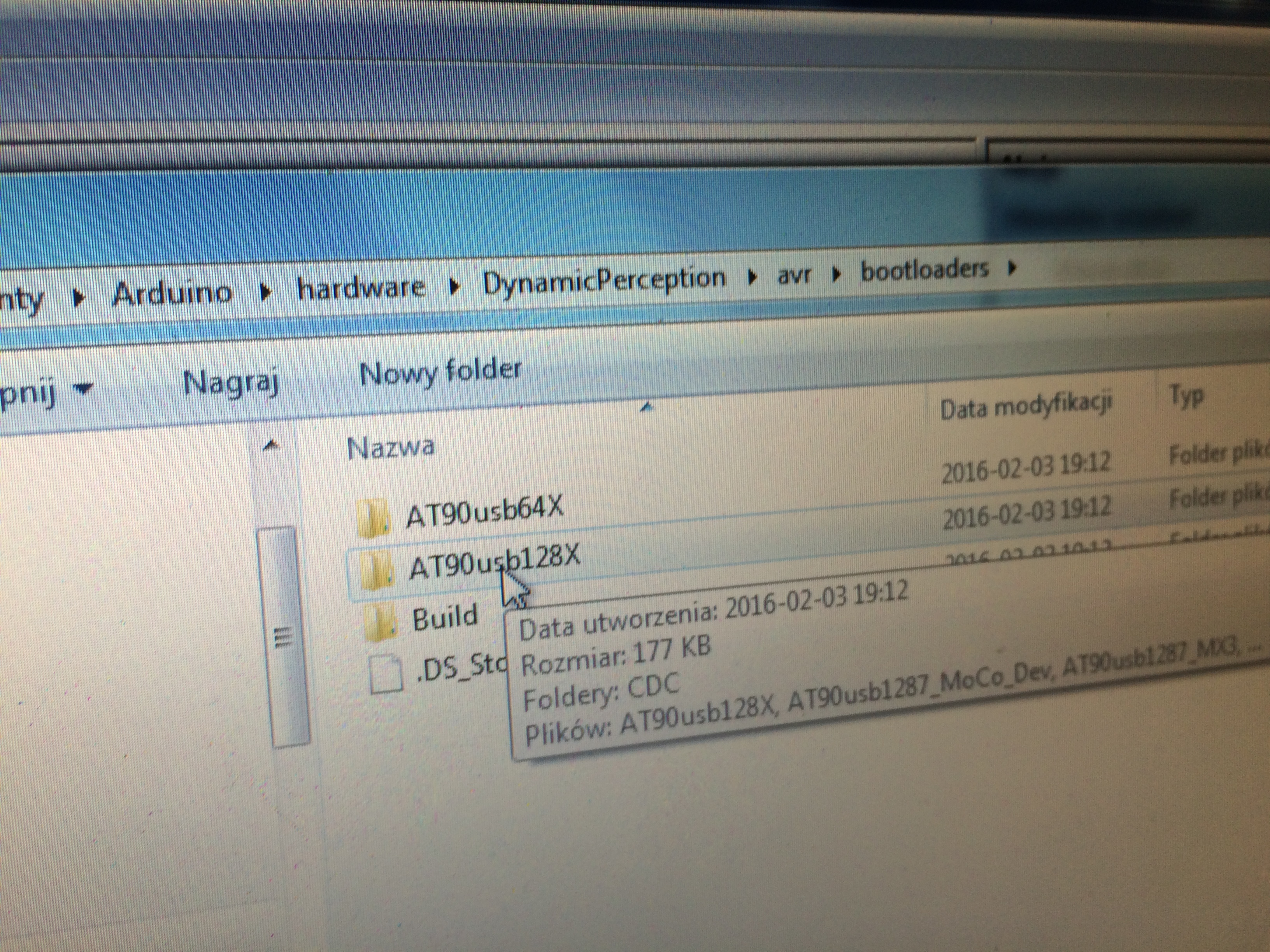

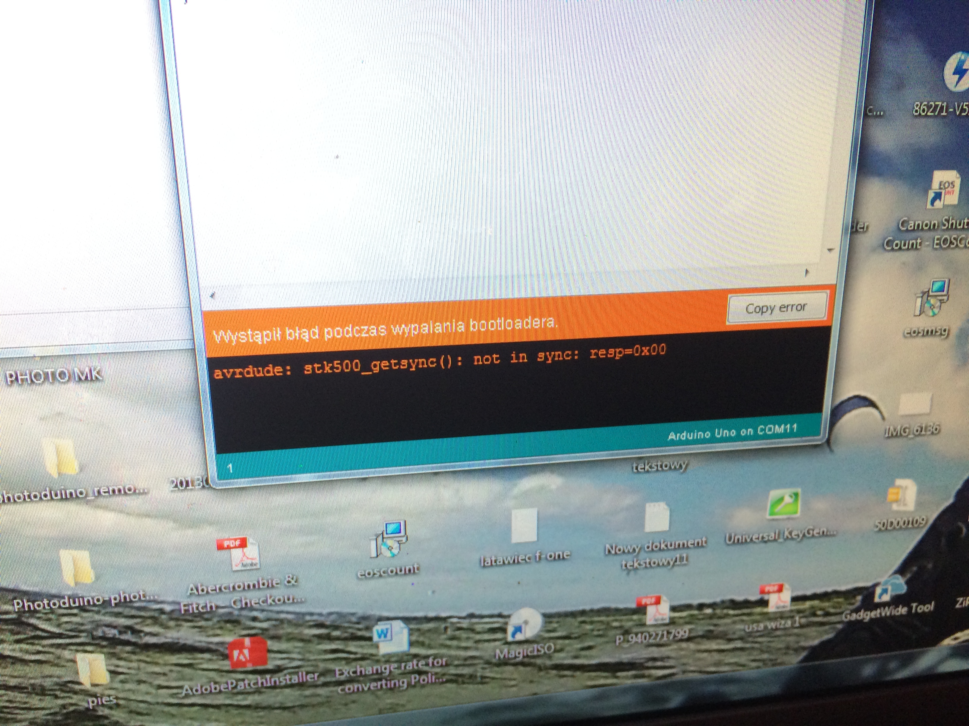

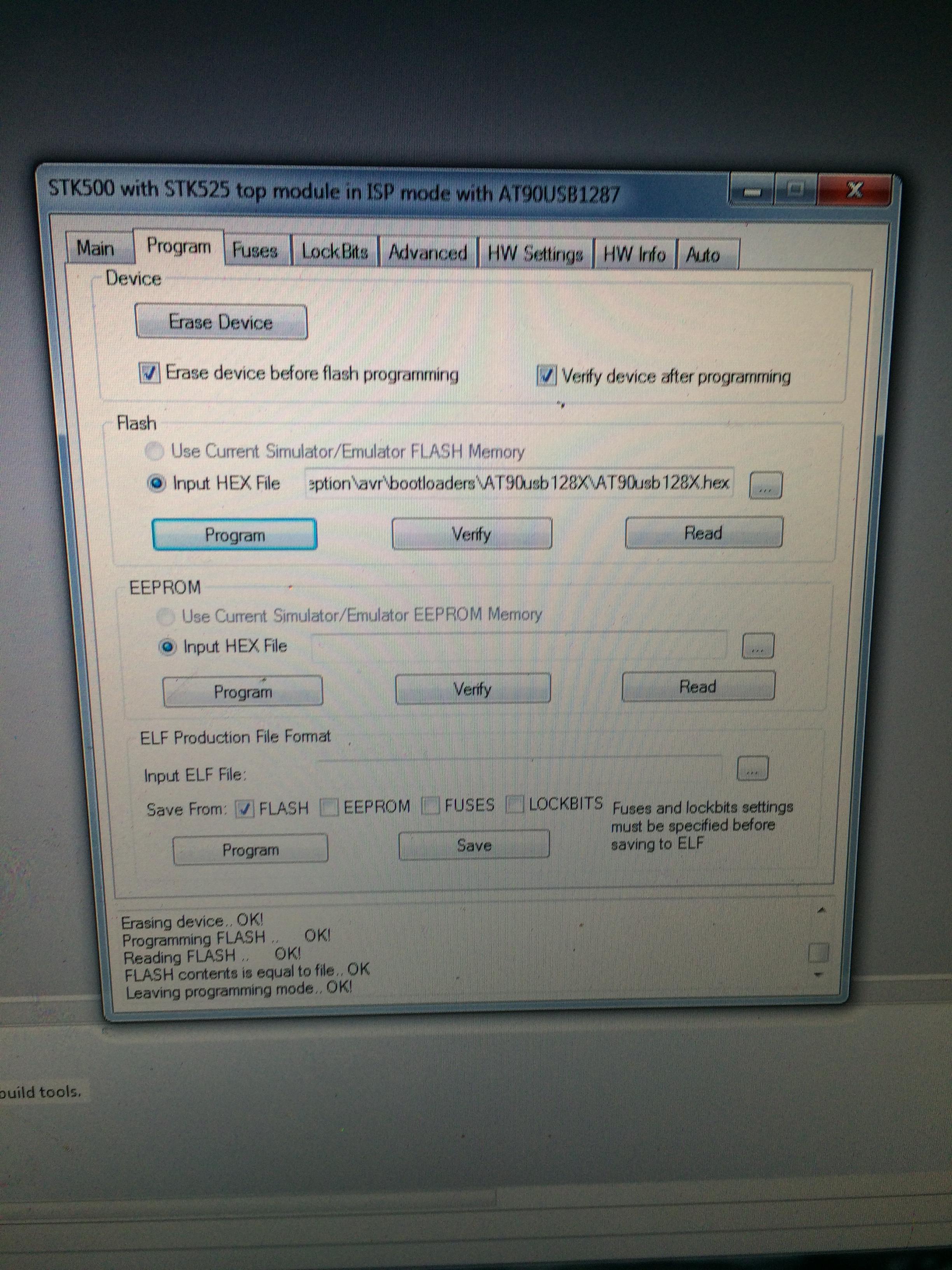

    witam!!
    niewiem jak zrobic! AVR bo nowy chip AT90USB1287 przez bootloaders aby zrobic LUFA CDC Class USB Bootloader
    dlaczego nie dziala ardunio!! zobacz foto
    a druga dziala Atmel studia 4.0 wzystko jest OK, zobacz foto

  • #2 15512057
    chemik0
    Nie wiem jak w przypadku wybranego przez Ciebie bootloadera, ale z fabrycznym DFU musisz zrobić:
    "2.5.1 Programming with USB bootloader: DFU (Device Firmware Upgrade)
    AT90USB part comes with a default factory pre-programmed USB bootloader located in
    the on-chip boot section of the AT90USB. This is the easiest and fastest way to
    reprogram the device directly over the USB interface. The “Flip” PC side application, is
    available from the Atmel website, offers a flexible an user friendly interface to reprogram
    the application over the USB bus.
    The HWB pin of the AT90USB allows to force the bootloader section execution after
    reset. (Refer to AT90USB datasheet section “boot loader support”). To force bootloader
    execution, operate as follow:
    􀀀 Press both “RST” and “HWB” push buttons
    􀀀 First release the “RST” push button
    􀀀 Release the “HWB” push button"
    Sprawdź też jak masz ustawiony fusebit HWBE
