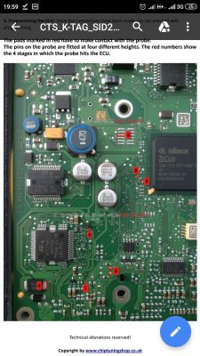

Nie wszystkie te sterowniki idą Ktagiem. Jest opcja w info sprawdzenia przez złącze, czy się da, czy nie:
Attention: before removing ecu from vehicle, make sure it is supported by following these steps
"Uwaga przed demontażem sterownika upewnij się, że jest wspierany poprzez następujące kroki"
Trasdata podaje jeszcze inne kroki:
WARNING:
IF NewTrasdata tool cannot ID/READ the ECU the possible causes are low Voltage/Amps or the
ECU is in curfew/standby.
IF the error persists you must perform the following attempts:
STEP1
The power supply connected to the NewTrasdata must produce(feed) at least 12.5 Volts and 3
Amps, replace the power supply of the kit with a booster or a car battery or a stabilized power
supply able to give the aforementioned power. Use the cable F32GN003 to connect the power to
NewTrasdata. If the error persists, go to STEP 2.
STEP2
To pin 28-39, instead of connecting the VKEY signals (orange wires), connect 2 power signals
+12V (red wires), in this way you should have only three red wires + 12V to pin 5-28-39
If the error persists, go to STEP3.
STEP3
Close the ECU, set it back on the vehicle, start the vehicle and leave it on for few minutes. This
allows the ECU to get out of the curfew / standby. Then try again the communication operations
and if necessary perform the STEP 1 and 2.
