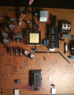

ACER P246H power board E162032 - Burned capacitor C817 after replacement worked

    Hello, I have replaced capacitor C817 with value 12PF 3KV but it worked only few days and burned again. Is the value correct? Whate else could cause the problem? Thank you very much.

    T801 damage?
    Or CCFL.?
    (measurement of the resistance of the secondary winding)

    resistance of secondary winding is 475R do yout know correct values of T801?
