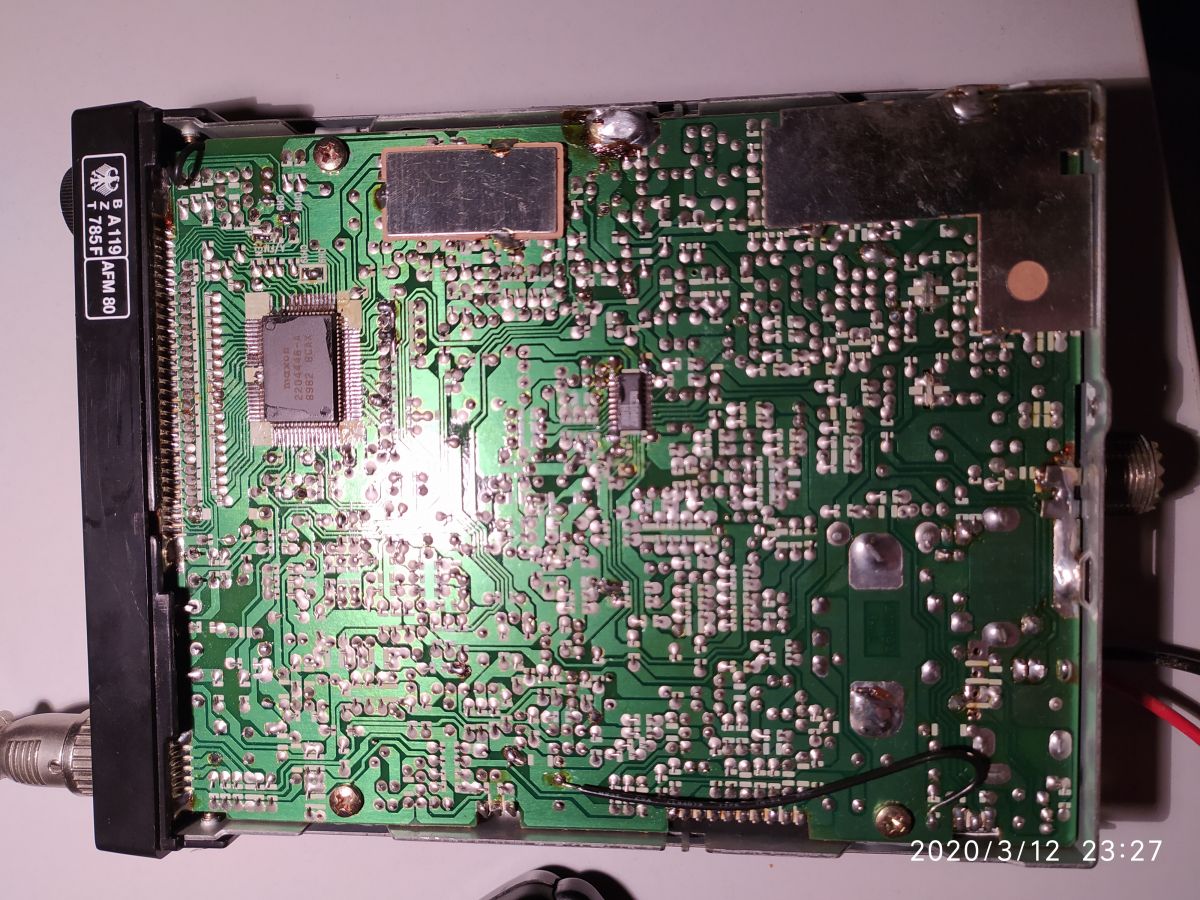

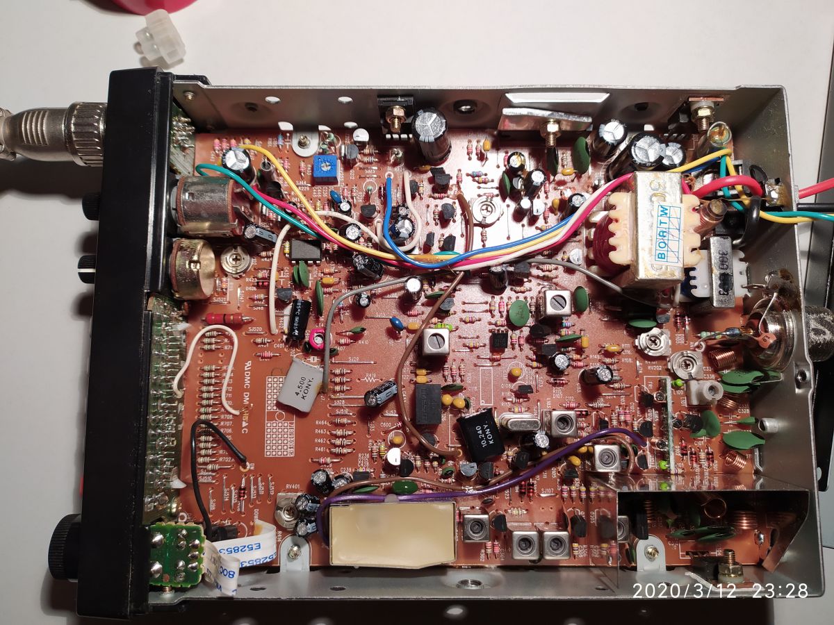

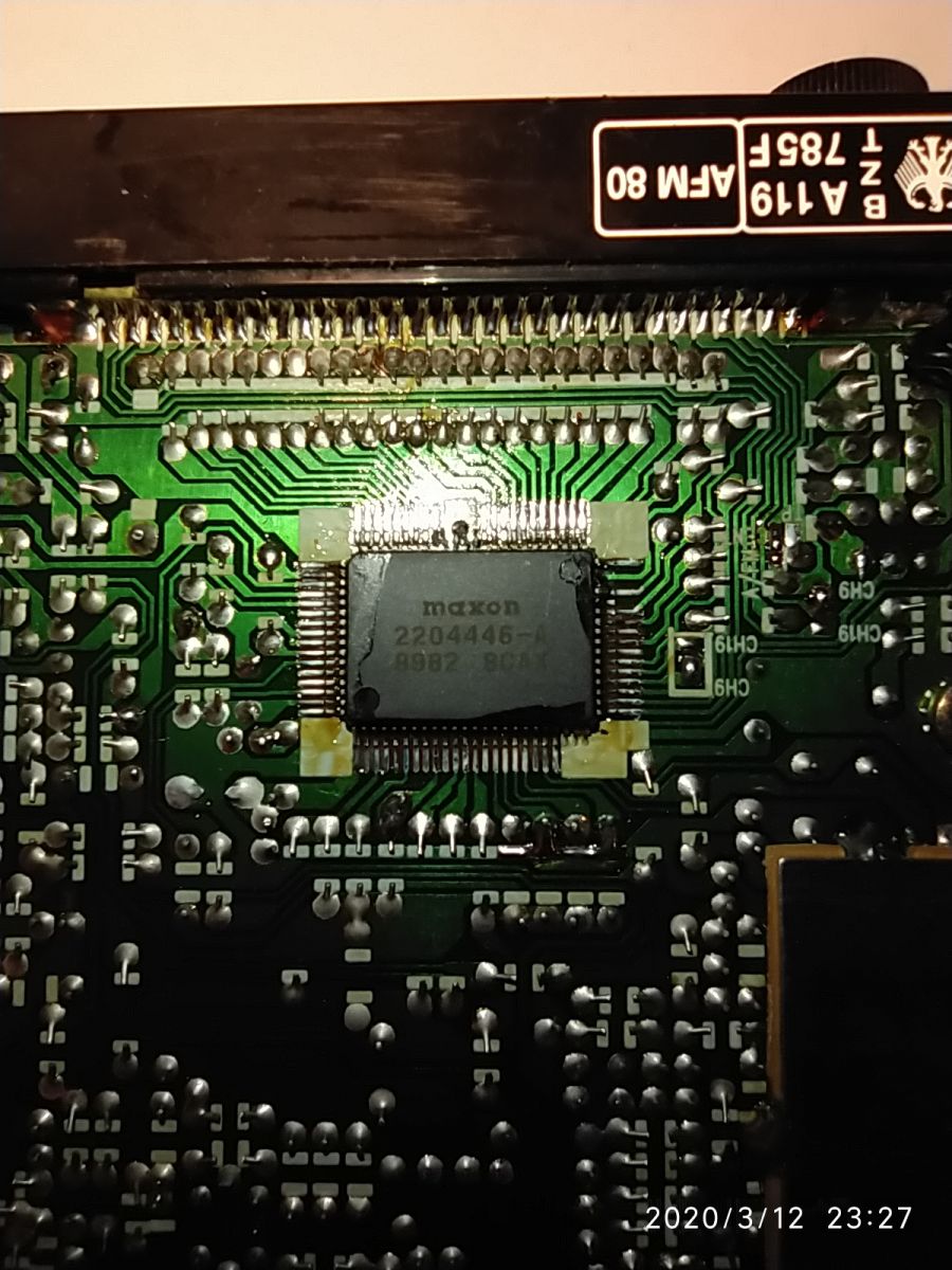

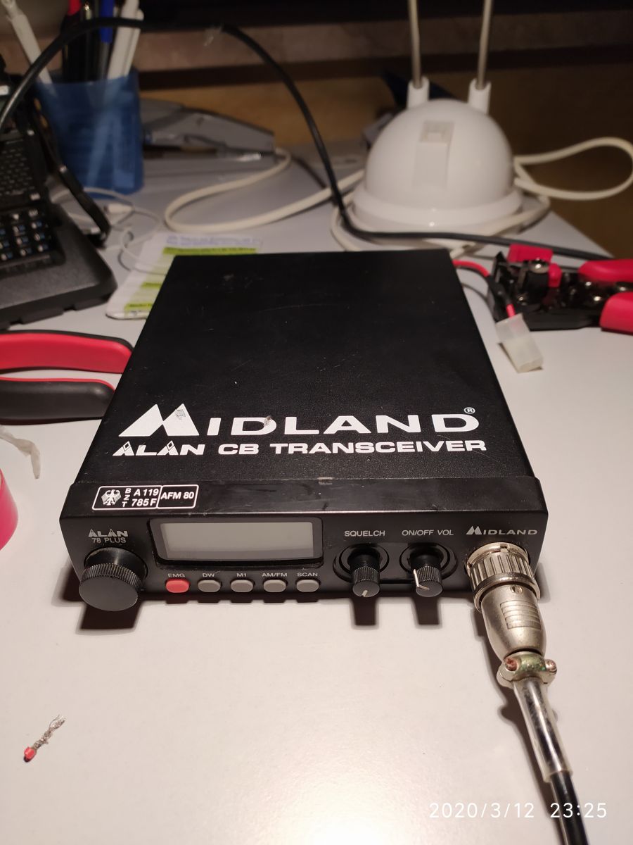

    Hello.
    Sorry for english - but I am from Croatia. I was trying my best to understand polish, but google translate is very bad. I hope I will not cause a problem.
    ON TOPIC:
    I have bought an Alan Midland 78 Plus D80 cb radio - german version - with 80 ch FM and 12 ch AM. I am looking now how to convert it to RU, with 400 ch. I have found instructions for this radio on this forum, but not for my revision of motherboard. I can not find the jumpers. I have older, orange backlight, not new, blue.
    I am uploading hi-res photos of my radio. Feel free to use them for any purpose.
    Thank you for your help!!
    73 from Croatia!

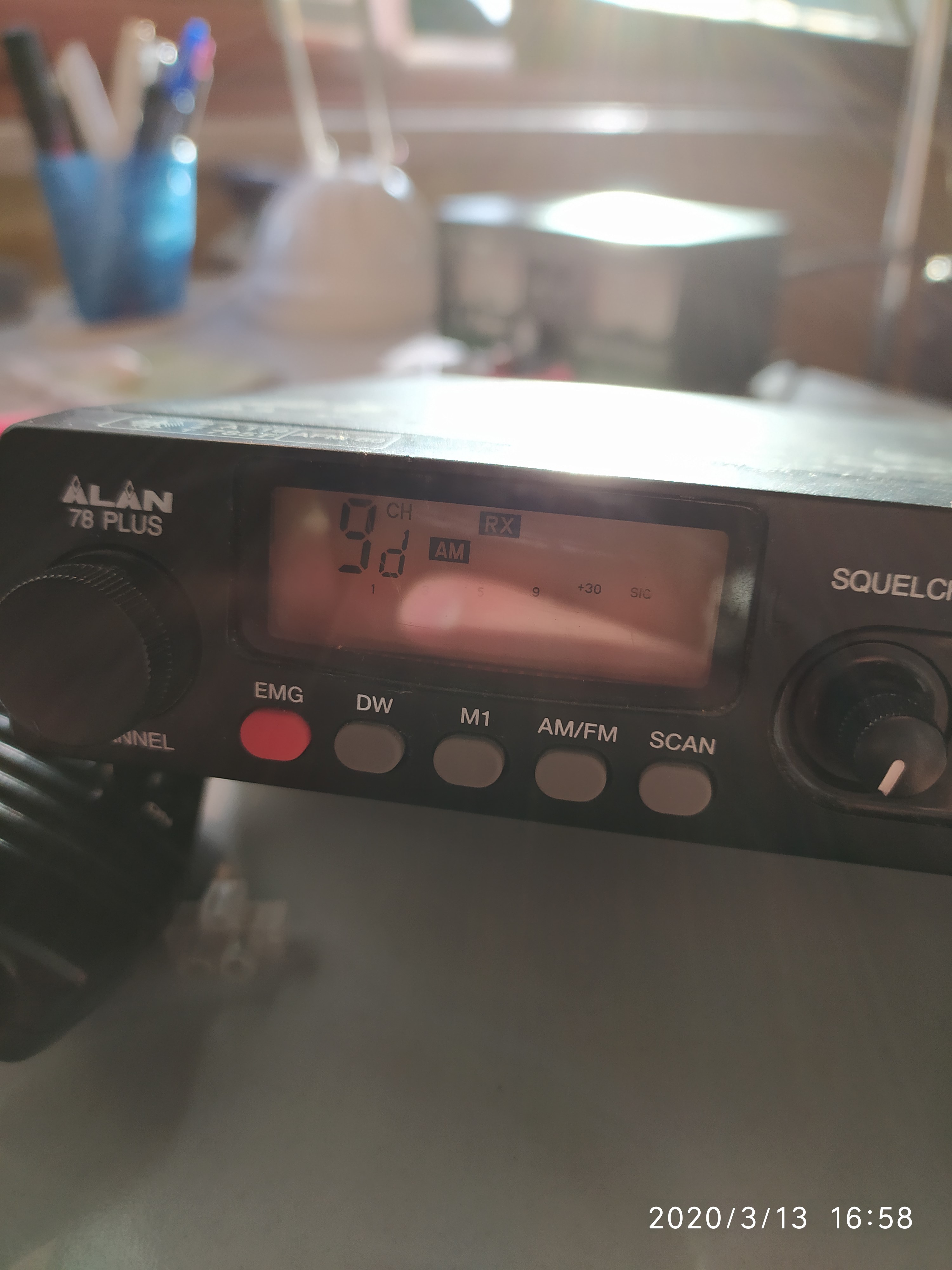

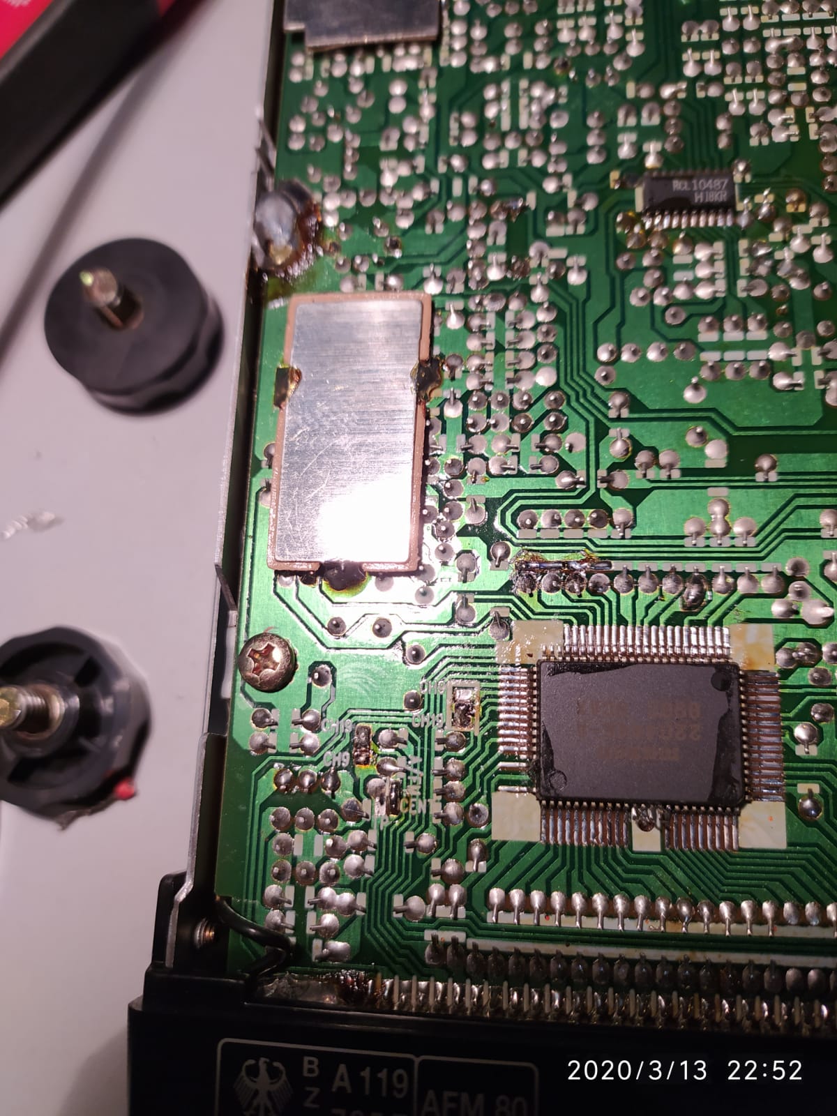

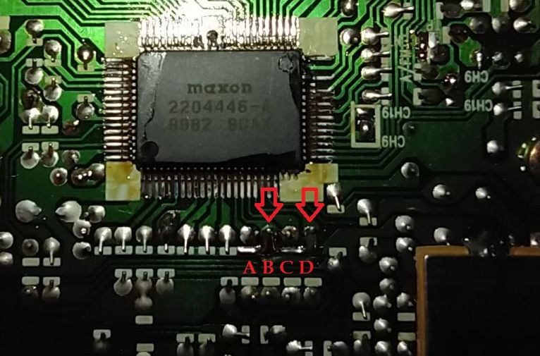

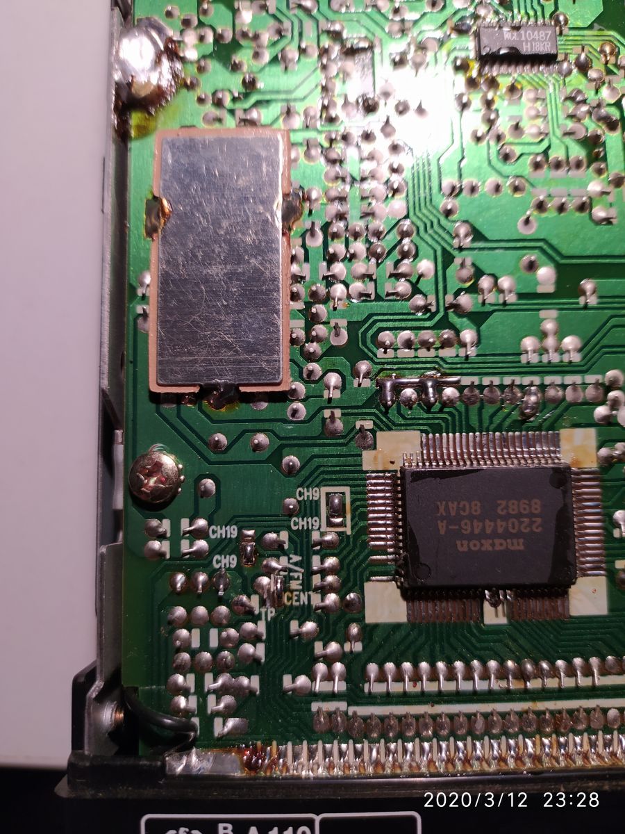

    Good evening!
    Thank you for your answer!!
    I took a look at the links and manuals you guys sent me, and removed the 2 solder bridges. Now the radio is in 400 ch operating mode. I even turned the power a bit up with the RV203 potentiometer :wink:
    Thank you once again! You saved me a lot of headache!
    Photos:

    PS.
    Szybka dziewiętnastka (EMG 19CH).
    Przelutować zwory (załącznik).
