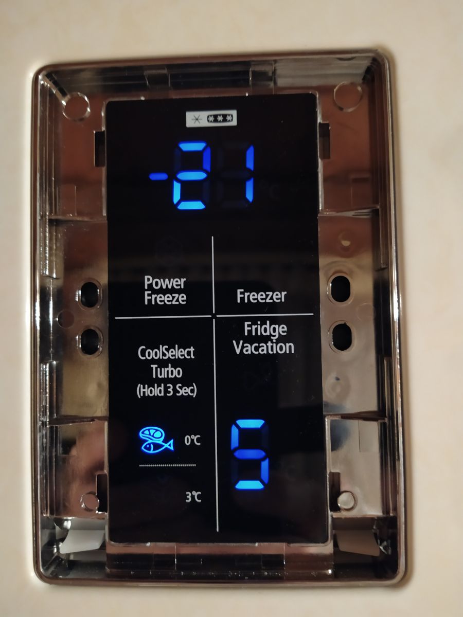

    Hi, I'm looking for the service manual for this Samsung RT77VAVC1 / EXT fridge, especially for display replacement / repair.
  • #2 18713191
    Felix10
    hi, nobody knows the procedure to uninstall this blessed display?
  • #3 18740712
    Felix10

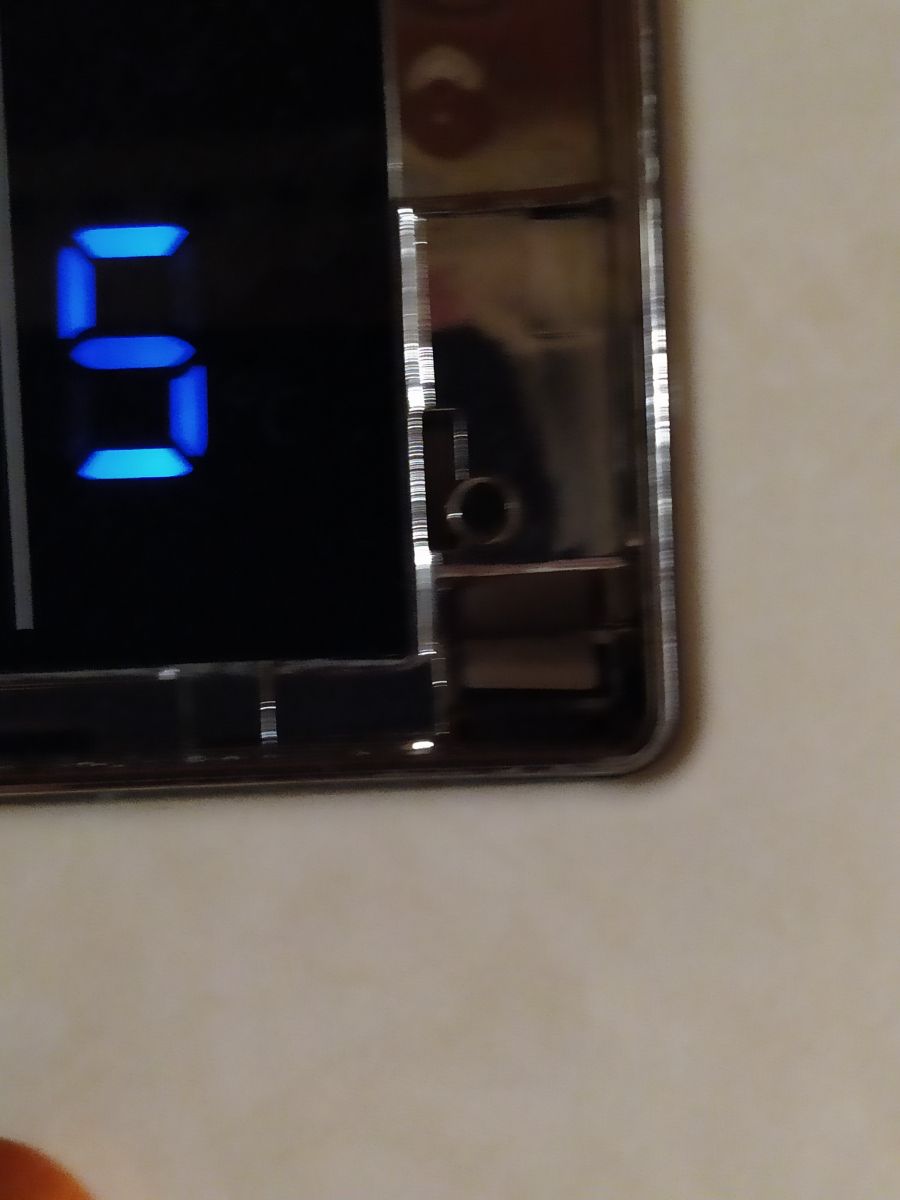

    Hi, I answer myself ...
    you have to detach the frame being very careful not to break it, once removed at the bottom there are two hooks that hold the display, as visible from the attached photos, keep the hooks forced and pull out the display ... of course being very careful. Samsung RT77VAVC1/EXT - instrukcja serwisowa do wymiany wyświetlacza Samsung RT77VAVC1/EXT - instrukcja serwisowa do wymiany wyświetlacza Samsung RT77VAVC1/EXT - instrukcja serwisowa do wymiany wyświetlacza
