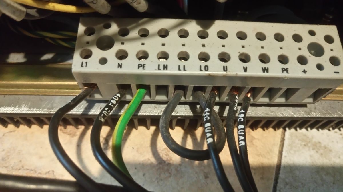

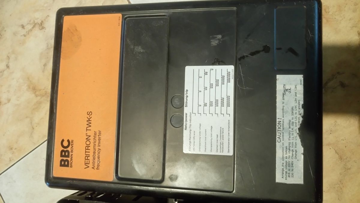

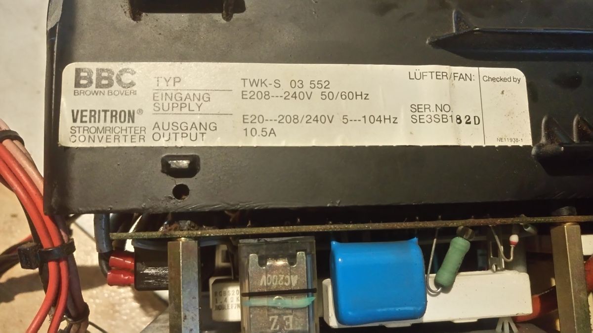

    Witam. Trafil mi się taki dziwny chyba stary typ, falownik jak w temacie ale nigdzie nie mogę znaleść do niego żadnych dokumentów jak to w ogóle podłączyć jak tym sterować.
    Może ktoś posiada instrukcję do tego lub wie gdzie znaleść,
    Z gćry dziękuje za pomoc

    Tumiwisizm
    Na kostkach są oznaczenia. Do czego są podłączone przewody idące od falownika, czy ucięte?

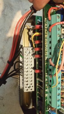

  • #3 18834704
    Krzysztof Kamienski
    Stare oznaczenia w falownikach BBC:
    Identification Description:
    1 SCR Terminal for signal cable screen. (Connected internally to frame earth.)
    2 AI 1 Analogue input channel 1, programmable.
    Default: 0 - 10 V (Ri
    = 200 kΩ) (J1:AI1 open) <=> 0 - 50 Hz frequency reference
    0 - 20 mA (Ri
    = 500 Ω) (J1:AI1 closed) <=> 0 - 50 Hz frequency reference
    Resolution 0.1 % accuracy ±1 %.
    3 AGND Analogue input circuit common. (Connected internally to frame earth through 1 MΩ.)
    4 10 V 10 V/10 mA reference voltage output for analogue input potentiometer, accuracy ±2 %.
    5 AI 2 Analogue input channel 2, programmable.
    Default: 0 - 20 mA (Ri
    = 500 Ω) (J1:AI2 closed)
    0 - 10 V (Ri
    = 200 kΩ) (J1:AI2 open)
    6 AGND Analogue input circuit common. (Connected internally to frame earth through 1 MΩ.)
    7 AO1 Analogue output, programmable. Default: 0 - 20 mA (load < 500 Ω) <=> 0 - 50 Hz output
    frequency. Accuracy: ±3 % typically.
    8 AGND Common for DI return signals. (Connected internally to frame earth through 1 MΩ.)
    9 24 V Auxiliary voltage output 24 V DC +20 %, -10 % / 250 mA (reference to AGND).
    Short circuit protected.
    10 DCOM1 Digital input common 1 for DI1, DI2 and DI3. To activate a digital input, there must be
    ≥+10 V (or ≤-10 V) between that input and DCOM1. The 24 V may be provided by the
    ACS 400 (X1:9) as in the connection examples (see L) or by an external 12 - 24 V source
    of either polarity.
    DI Configuration Factory (0) Factory (1)
    11 DI 1 Start. Activate to start. Motor will ramp up to
    frequency reference. Disconnect to stop.
    Motor will coast to stop.
    Start. If DI 2 is activated, momentary
    activation of DI 1 starts the ACS 400.
    12 DI 2 Reverse. Activate to reverse rotation
    direction.
    Stop. Momentary inactivation always stops
    the ACS 400.
    13 DI 3 Jog. Activate to set output frequency to
    jogging frequency (default: 5 Hz).
    direction.
    14 DI 4 Must be deactivated for Factory 0). Must to be activated for Factory (1).
    15 DI 5 Ramp pair selection (ACC1/DEC1 or ACC2/DEC2).
    16 DCOM2 DCOM2 digital input common 2 for DI4, DI5
    17 RO1C Relay output 1, programmable (default operation: fault => 17 connected to 18).
    12 - 250 V AC / 30 V DC, 10 mA - 2 A 18 RO1A
    19 RO1B
    20 RO2C Relay
  • #4 18835354
    leszekrrr
    Poziom 6  
    Dzikuję koledze, w wolnej chwili sprawdze to czy zadziała.
    Przewody są odcięte.
    Falownik był w jakiejś maszynie, znajomy to wymontował i dał mi to za darmo,
    Jak to podłącze to się odezwę czy jest w ogóle sprawne. Jak sprawne to może by się do czegoś przydalo.
