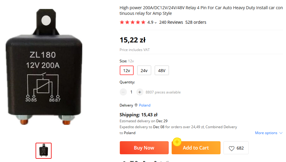

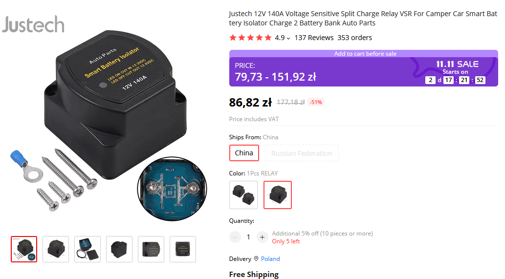

    i mam pytanie odnosnie separatora:
    czy wystarczylby taki:
    1) 30 zl - High power 200A/DC12V/24V/48V Relay 4 Pin For Car Auto Heavy Duty Install car continuous relay for Amp Style

    czy moze drozszy
    2) Justech 12V 140A Voltage Sensitive Split Charge Relay VSR For Camper Car Smart Battery Isolator Charge 2 Battery Bank Auto Parts
