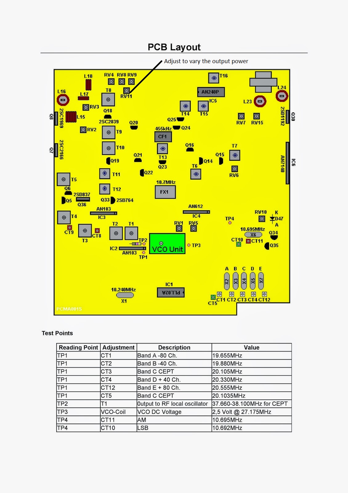

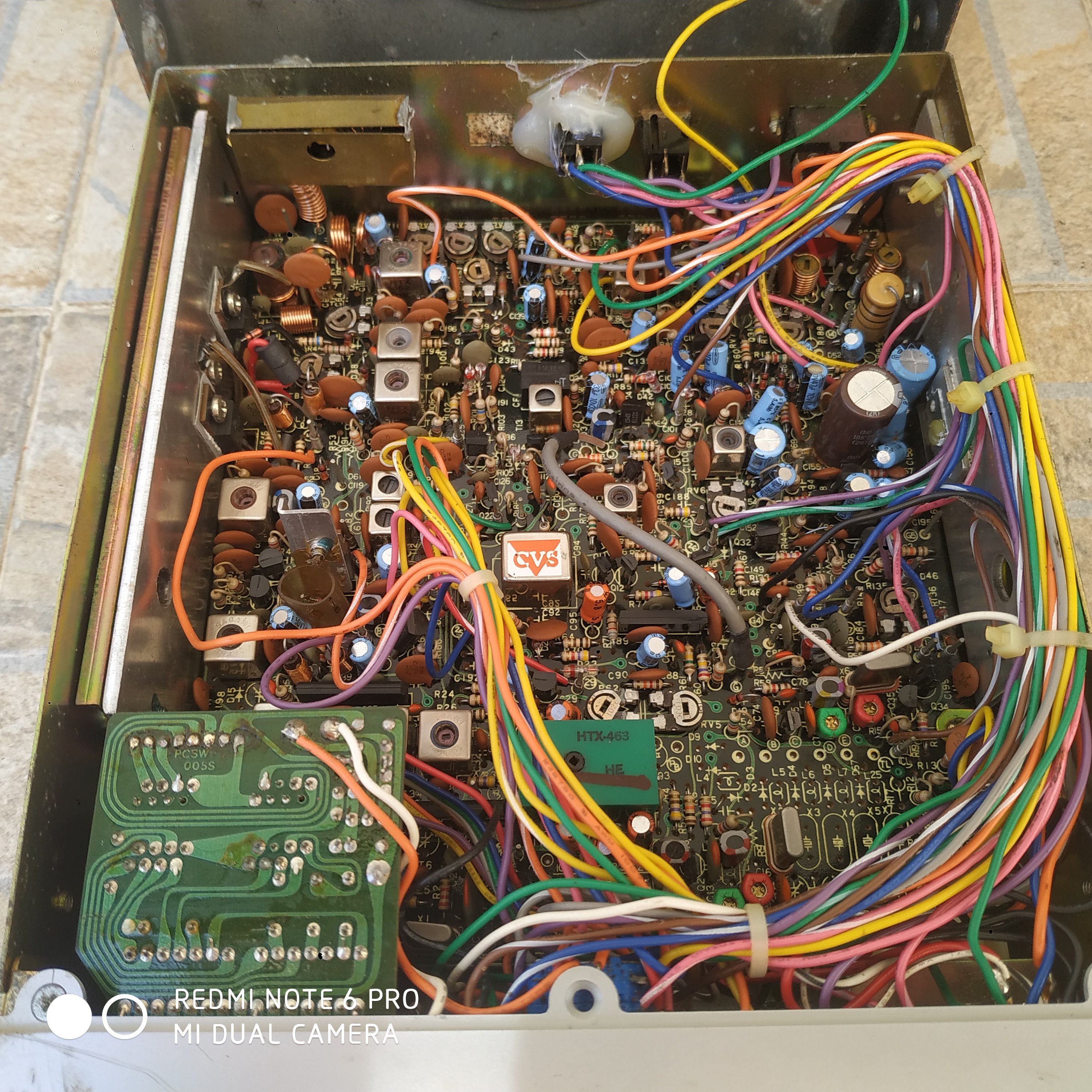

    T3, T4, T5, must be adjusted by pressing the tx key from the microphone without speaking, or I have to inject a bf signal. This radio has remained on the shelf in the cellar for many years, never undergone any repairs and is 100% original, I suspect that some capacitors in the final RF circuit have lost capacity. I also use the translator. Thanks to the translators we can talk.
    Added after 3 [minutes]:
    Before adjusting T3, T4, T5, I would like to try adjusting the vr11. What do you think about it ?
    Added after 18 [minutes]:
    I am sending you photos of the . VR11 to be adjusted

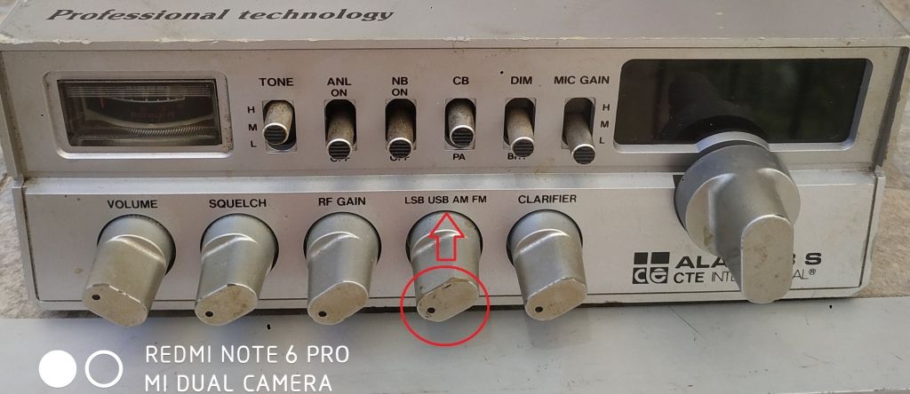

    #18 20125395
    gumisie
    Asterix5867 napisał:
    where is the modulation switch?
    Alan88S - Moc nadawcza spadła do 1W - jak naprawić? Poszukiwany schemat serwisowy
    Ustaw w pozycji: FM i zmierz napięcie na; kolektorach Q7 i Q8.

    Hektar Zahle.r
    Poziom 30  
    Tam jest modulator szeregowy jak w Alanie 87. VR 11 na maksa ustaw. P. S. Ciekawe jak sprawdziłeś C1969 ? Miernikiem go nie sprawdzisz.
  • #20 20126209
    Asterix5867
    Poziom 6  
    I tried to vary the VR 11 the power increases a little, as regards the test on 2sc1969 I check them with a "" transistor tester "". A friend of mine checks them with the analog tester.

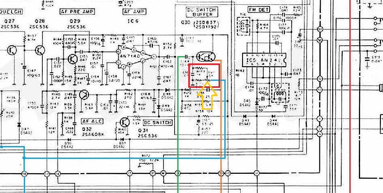

    Zmierz napięcie na wyprowadzeniach (B, C, E), tranzystora Q30 (TX: LSB, USB, FM).
  • #26 20126794
    Asterix5867
    Poziom 6  
    Voltages measured in transmission without modulation in AM-FM-LSB-USB on the pins of Q30: in AM: B: 8.11- C: 12.78 - E: 7.44 in FM: B: 8.13- C: 12.83- E: 7.47 in LSB: B: 10.27- C: 12.02- E: 13.01 in USB B: 8.15 - C: 12.80 - E: 7.49
    #27 20126876
    gumisie
    Spróbuj regulacji potencjometrem, wskazanym pomarańczową strzałką (symbolu nie widać, złej jakości kopia schematu).
    is it VR11?
    Nie wiem jaki to symbol.
    Schemat jest nieczytelny.
    Nie posiadam tego modelu CB, żeby sprawdzić. :cry:
