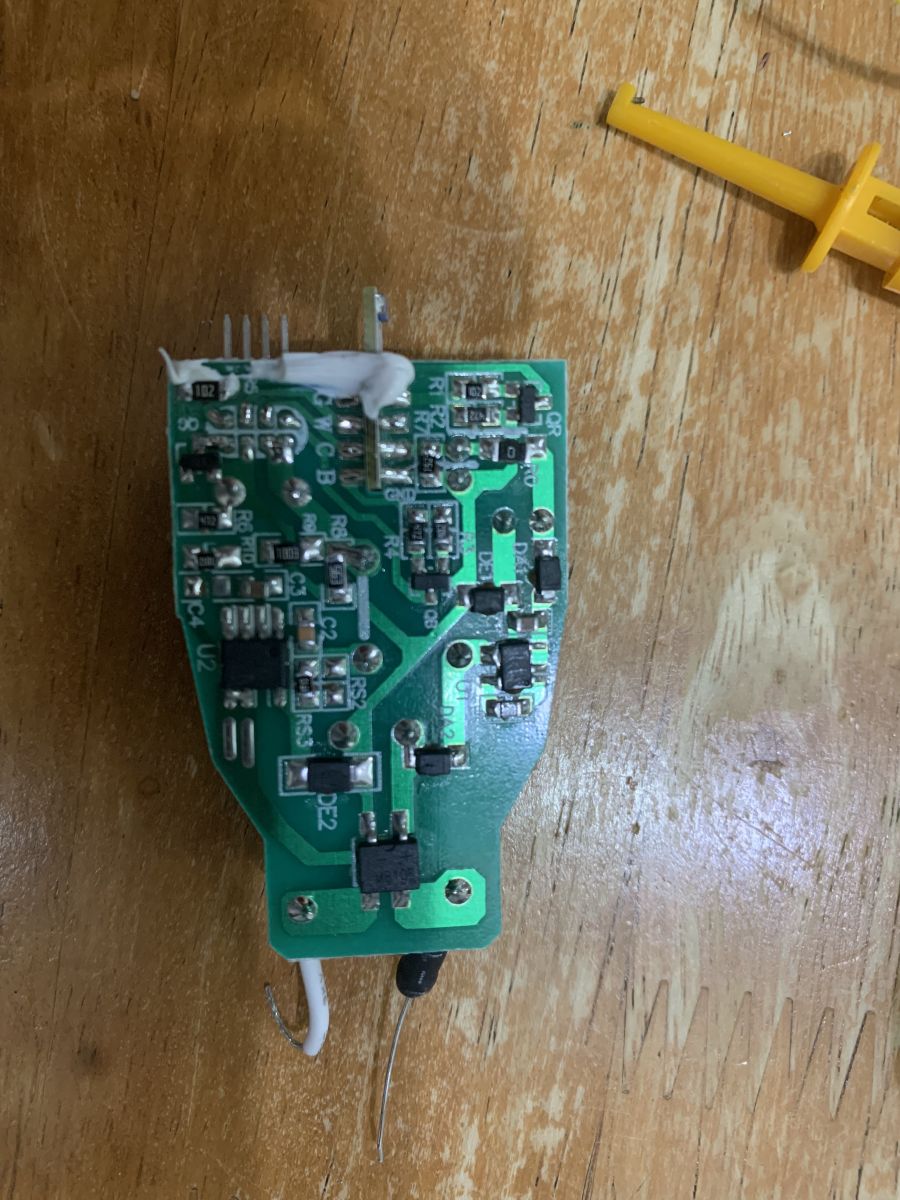

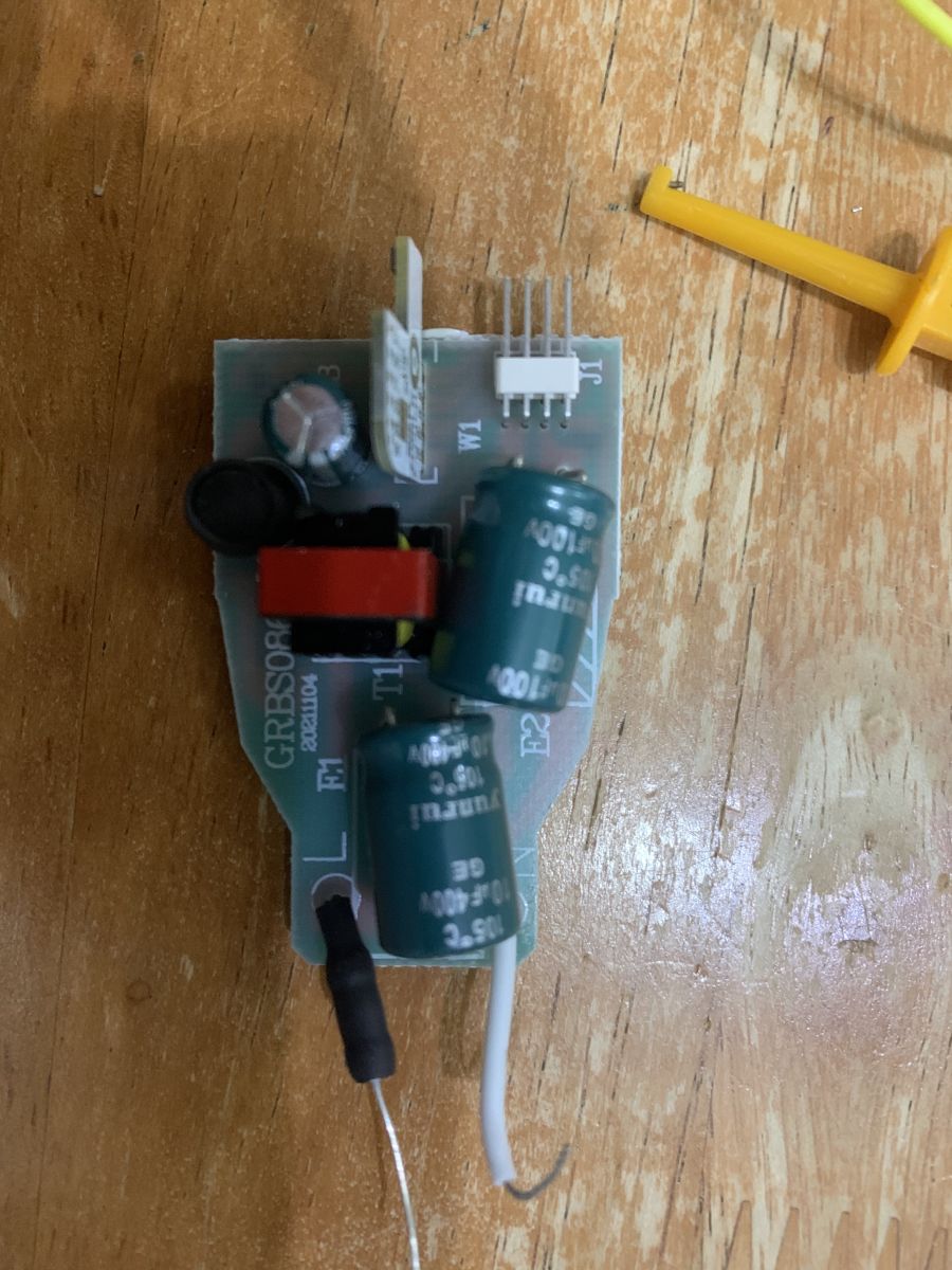

This is a short teardown of the Smartrul E27 WIFi bulb which is based on BK7231N and it uses a tuya module CBLC9
Basic Info:
Brand: Smartrul
Model: SMR-DP005-WIF-A19
Chip: BK7231N - CBLC9
Vendor : https://www.lazada.com.my/products/i1273416288-s3846876432.html
Teardown Photos & Packaging

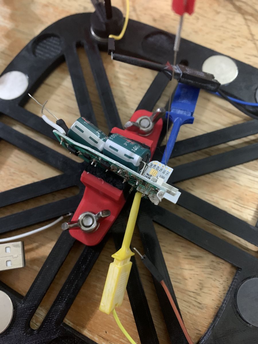

Flashing OpenBeken firmware:
Using cloudcutter
Select 'E27-RGBCW-Smart-Life-WB2L_M1' profile from Tuya-Generic list.
I wrongly flashed T firmware initially assuming this was T since I hadn't' done any teardown yet.
