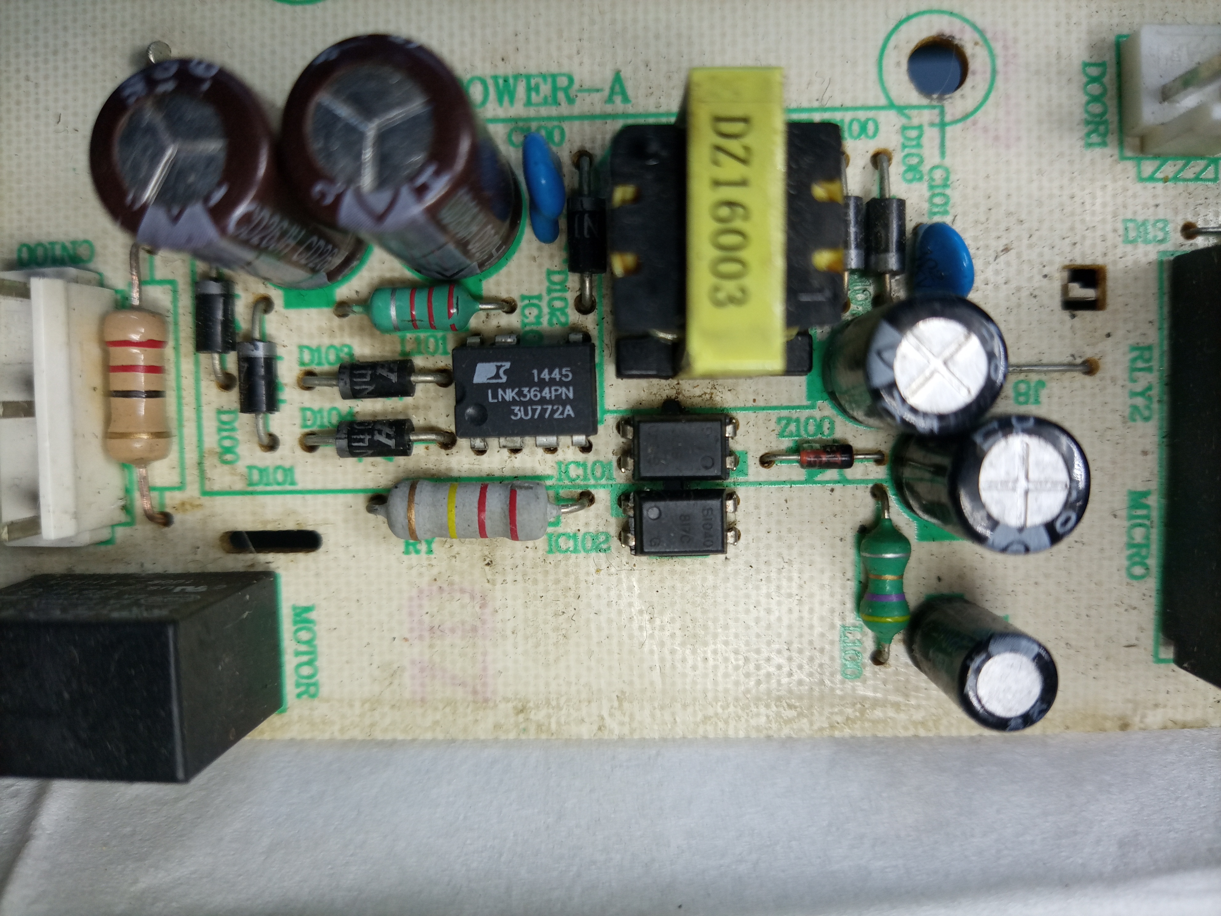

    Hi..
    1000 thinks Bro TONI_2003

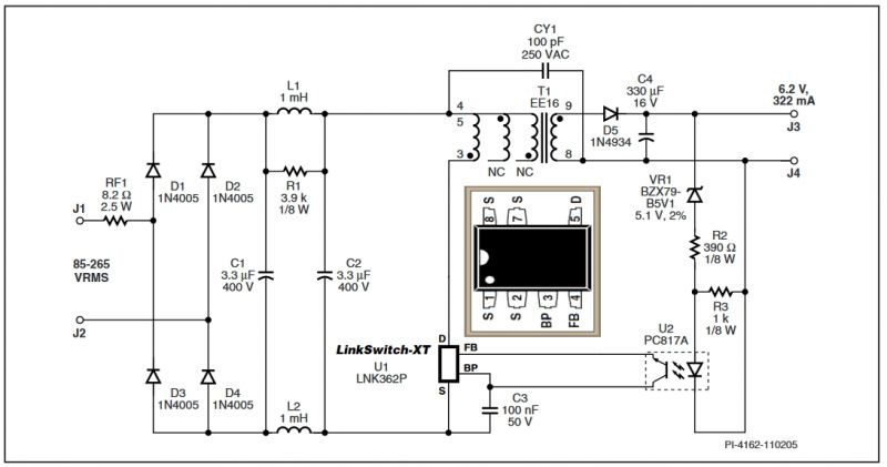

    Your schematics no same my Model and PCB
    - Rx = 22
    - Ry = 220K
    - R102 = 100k
    - R101 = 100
    - R111 = 100k
    - R104 = 1K
    - R110 = 1K
    - R108 = 20k
    - R100 = 20
    - R106 = 4K7
    -IC100 = LNK 364PN
    - IC1 = PC 817
    - IC2 = PC 817
  • #4 20309613
    dvb_gsm
    Hi..
    Please Help Me Bro
