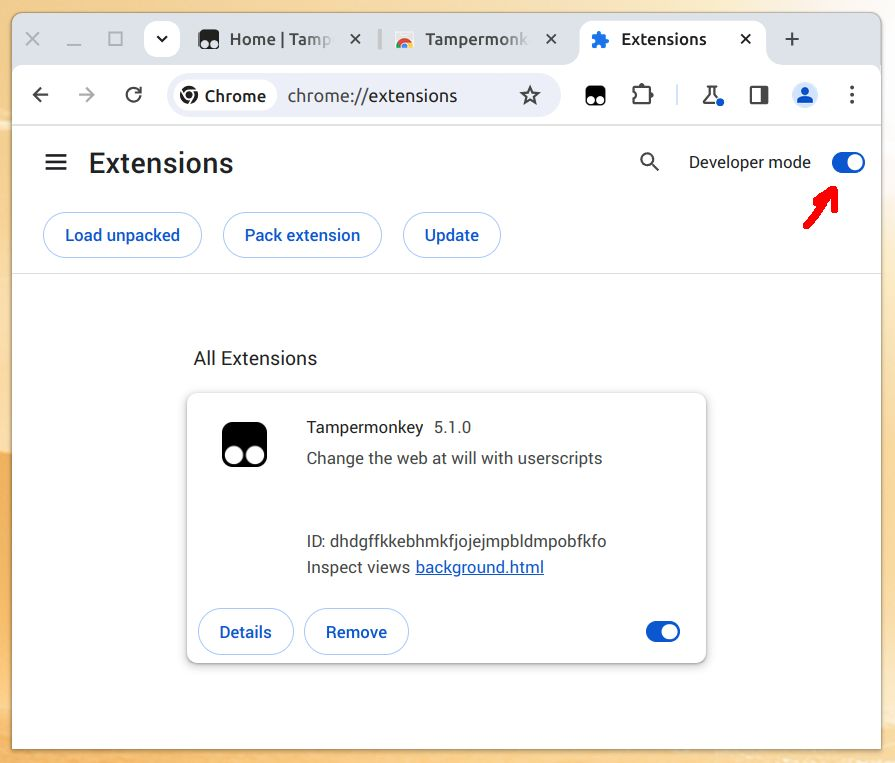

    W Chrome wprowadzono manifest V3 i Tampermonkey (itd) przestał działać. Aby skrypt z tematu znów działał, należy wykonać:
    https://www.tampermonkey.net/faq.php#Q304
    A209 For users of the Tampermonkey extension in a Chrome-based browser, enabling Developer Mode is a requirement introduced with Manifest V3 updates.
    Why Enable Developer Mode?
    Developer Mode is necessary due to the two-step user authorization for userscripts: the userScripts permission and the Developer Mode option. The userScripts permission, on its own, does not trigger a user warning upon installation. So this additional step likely reflects Google's intention to ensure that users are making an informed decision to run extensions that use Userscripts.
    Steps to Enable Developer Mode

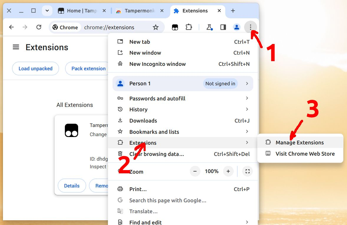

    To enable Developer Mode in Chrome and derivates:
    Open the menu, select "Extensions" and "Manage extensions", or type chrome://extensions or edge://extensions in a new browser tab to navigate to the extensions page.
    chrome://extensions
    Instrukcja otwierania zarządzania rozszerzeniami w Chrome.

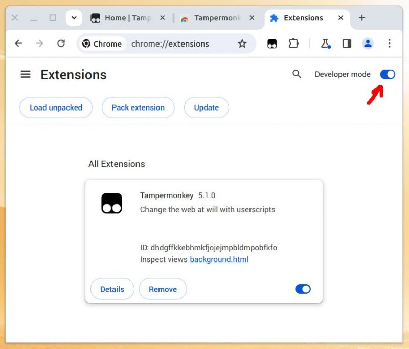

    Find and click the "Developer Mode" toggle at the top right to enable it.
    developer mode
    Zrzut ekranu z zakładki rozszerzeń Chrome z włączonym trybem dewelopera i zaznaczonym rozszerzeniem Tampermonkey.
    This action enables the use of the userScripts API through Tampermonkey.
    Po tych krokach rozszerzenie będzie dalej działać w Chrome.
