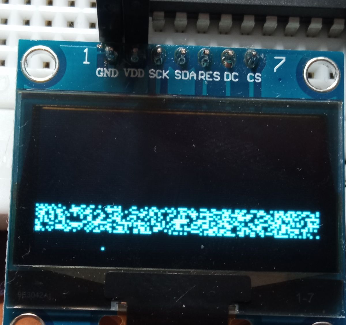

  • #2 21071738
    NewTornus
    Poziom 7  
    W sumie jak już otworzyłem to już mogę tu wysłać:
    #include <avr/io.h>           //dodanie głównej biblioteki
    #include <util/delay.h>        //dodanie biblioteki opóźniej
    #include <avr/interrupt.h>
    #include <avr/sleep.h>
    #include <string.h>
    #include <stdlib.h>
    #include "ssd1306.h"
    int main (void){
    	init();
    	while(1){
    #include <string.h>
    #include <stdlib.h>
    uint8_t buf[1024];
    inline void wr_spi_bit(uint8_t a){
    	sck_0;
    	if(a)sda_1;
    	else sda_0;
    	sck_1;
    void sbyte(uint8_t a){
    	uint8_t b = 1 << 7;
    	while(b){
    		wr_spi_bit(a & b);
    		b>>=1;
    void cmd(uint8_t a){
    	deselect_ssd1306;
    	dc_0;
    	select_ssd1306;
    	sbyte(a);
    	deselect_ssd1306;
    void data(uint8_t a){
    	deselect_ssd1306;
    	dc_1;
    	select_ssd1306;
    	sbyte(a);
    	deselect_ssd1306;
    void turn_off_reset(void){
    	_delay_ms(100);
    	res_1;
    	_delay_ms(100);
    void wr_buf(void){
    	uint16_t a = 0;
    	cmd(0x00);
    	cmd(0x10);
    	cmd(0xB0);
    	deselect_ssd1306;
    	dc_1;
    	select_ssd1306;
    	while(a < 1024){
    		sbyte(buf[a]);
    		buf[a] = 0;
    		a++;
    	deselect_ssd1306;
    inline void init_spi(void){
    	sck_ddr|=sck;
    	sda_ddr|=sda;
    void init(void){
    	cs_ddr|=cs;
    	deselect_ssd1306;
    	init_spi();
    	res_ddr|=res;
    	dc_ddr|=dc;
    	turn_off_reset();
    	cs_ddr|=cs;
    	cmd(Set_Multiplex_Ratio);
    	sbyte(mulitplex_ratio);
    	cmd(Set_Display_Offset);
    	sbyte(Display_Offset);
    	cmd(Set_Display_Start_Line | Display_Start_Line);
    	cmd(Set_Segment_Re_map | Segment_Re_map);
    	cmd(Set_COM_Output_Scan_Direction | COM_Output_Scan_Direction);
    	cmd(Set_COM_Pins_Hardware_Configuration);
    	sbyte(COM_Pins_Hardware_Configuration);
    	cmd(Set_Contrast_Control);
    	sbyte(Contrast);
    	cmd(Entire_Display_ON | Display_ON);
    	cmd(Set_Normal_Inverse_Display | Normal_Display);
    	cmd(Set_Display_Clock_Divide_Ratio_Oscillator_Frequency);
    	sbyte(FOSC | divide_ratio);
    	cmd(Charge_Pump_Setting);
    	sbyte(Enable_Pump);
    	cmd(Deactivate_scroll);
    	cmd(Set_Memory_Addressing_Mode);
    	sbyte(Horizontal_Addressing_Mode);
    	cmd(Set_Column_Address);
    	sbyte(Column_start_address);
    	sbyte(Column_end_address);
    	cmd(Set_Page_Address);
    	sbyte(Page_start_address);
    	sbyte(Page_end_address);
    	cmd(Set_Display_ON);
    	buf[0] = (1 << 7)|(1 << 0);
    	buf[1] = (1 << 7)|(0 << 0);
    	buf[2] = (0 << 7)|(1 << 0);
    	buf[512] = 255;
    	buf[1023] = 1;
    	wr_buf();

    Ktoś potrafiłby mi powiedzieć, co robię źle?
    Wychodzi mi coś takiego: Wyświetlacz OLED wyświetlający zniekształcone wzory pikseli
    #3 21073132
    gps79
    Poziom 35  
    Cześć,
    Mam identyczny wyświetlacz. Uruchomiłem Twój kod na moim i zachowuje się identycznie do tego, co zaprezentowałeś na zdjęciu.
    Ja używam sterownika SH1106 (https://github.com/wonho-maker/Adafruit_SH1106) i z nim mój wyświetlacz działa poprawnie.
    Spróbuj tego kodu (przyjrzyj się zmianom w "setup" i "wr_buf"):
    Kod: C / C++
    Zaloguj się, aby zobaczyć kod
  • #4 21073377
    NewTornus
    Poziom 7  
    No więc, jeżeli pragniesz pokazać mi 2 znaki mniejszy/większy to działa mi ten programik bez zarzutu
    taką funkcję widzę pierwszy raz
    memset
    chyba i tak jest niepotrzebna
    init();
    to chyba relikt jeszcze z mojego programu
    masz pageadressing mode i jakiś dziwny offset
    popatrzę z tym offsetem u siebie
    jak swojego programu nie naprawię to ci po prostu podpieprzę,
    dzięki
    może też korzystałem ze złego datasheetu, bo ty mówisz, że to SH1106, a ja robiłem na SSD1306
    The SH1106 controller has an internal RAM of 132x64 pixel. The SSD1306 only has 128x64 pixel.
    ciekawe
    więcej nie kupuję jakiegoś gówna bez opisu
    https://allegro.pl/oferta/wyswietlacz-oled-1-3-spi-niebieski-13736790342
    #5 21073448
    gps79
    Poziom 35  
    Zakupy elektroniki z Chin są, jak pudełko czekoladek: nigdy nie wiesz, na jaką trafisz. Jeśli uda Ci się podłączyć wyświetlacz i znajdziesz odpowiedni sterownik, to wygrałeś. W ofertach różne rzeczy piszą, a sprzedają to, co mają pod ręką. Takie czasy.
