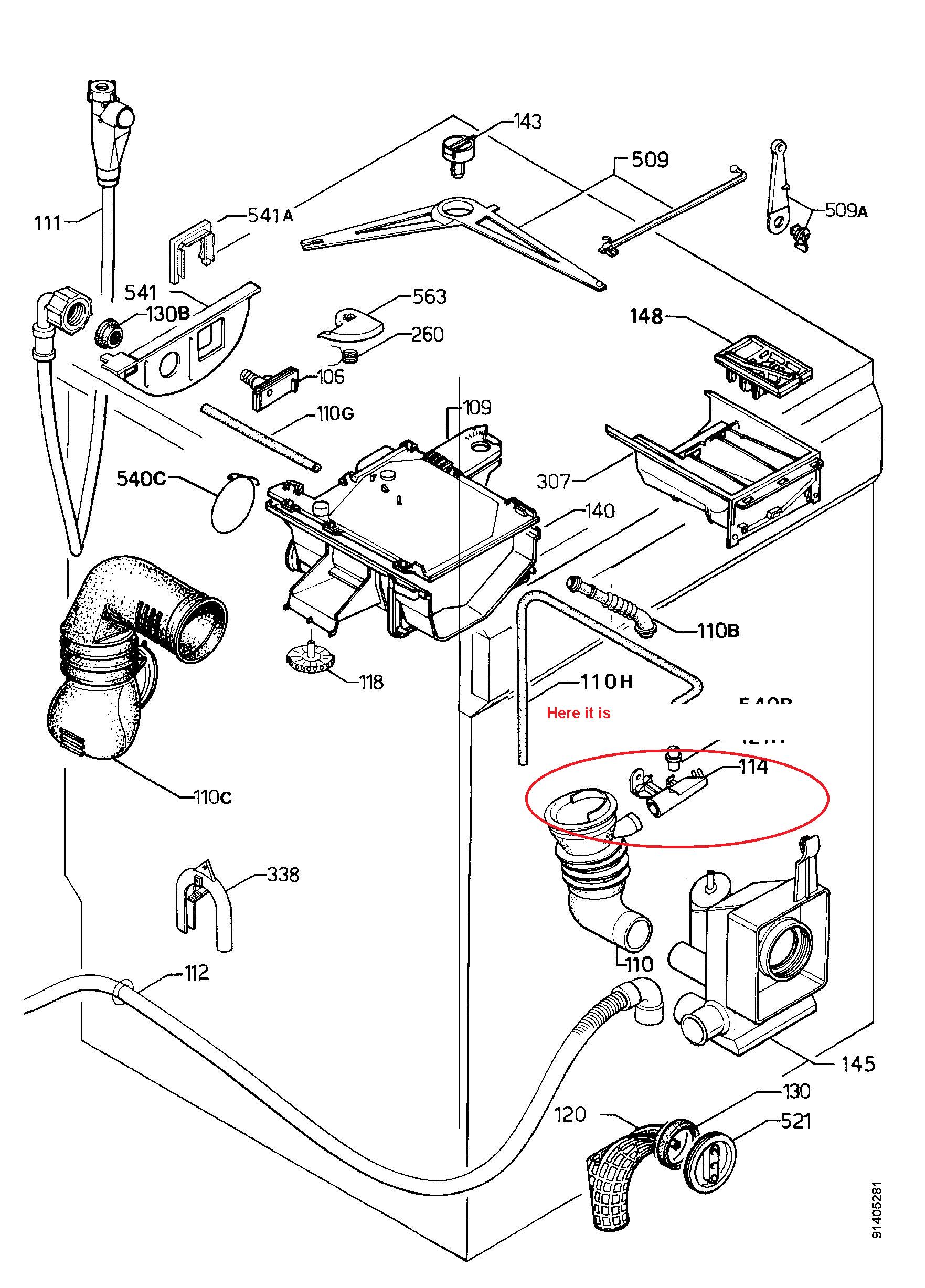

    pracka pere, vypusti vodu, vyplacha, ale nezmycha - neodstredi. Iba posledne na konci. Vodu vypusti a caka - aj 10 minut. Vidim to na zavadu "hladinovy spinac - pressure switch". Ustna skuska - fuknem - kontakty cvakaju. Tak neviem.

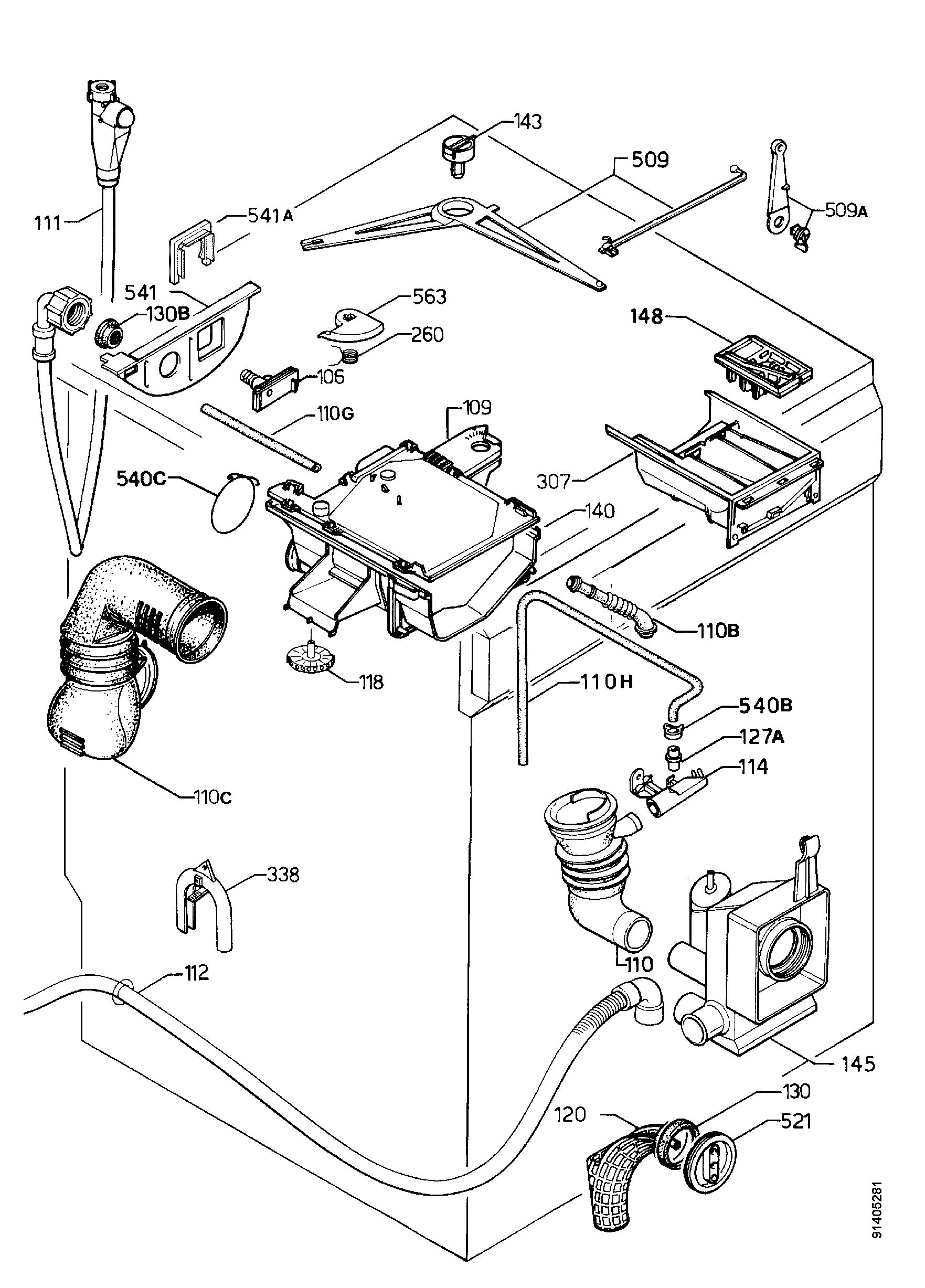

    Try to clean part marked 114 on the picture.

    drain pump OK, recirculation pump OK.
    Main motor OK - washing OK.
    Finish long spin OK.
    Rinses - drain ok, not short spin - error
    Pralka Electrolux EW 952S nie odwirowuje - możliwa usterka presostatu?
    Which is No 114? try . . .

    Here it is...

    mrhari napisał:
    Here it is...
    Oh, my English . . . no location, but function.
    However already is that semble OK.
    Last rinses saturation many water. Till door. That it was not.
    Pressure switch? Big switch - claps tree pressure - six regulating trimrov. Which adjusts final pressure?
