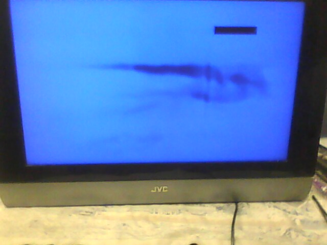

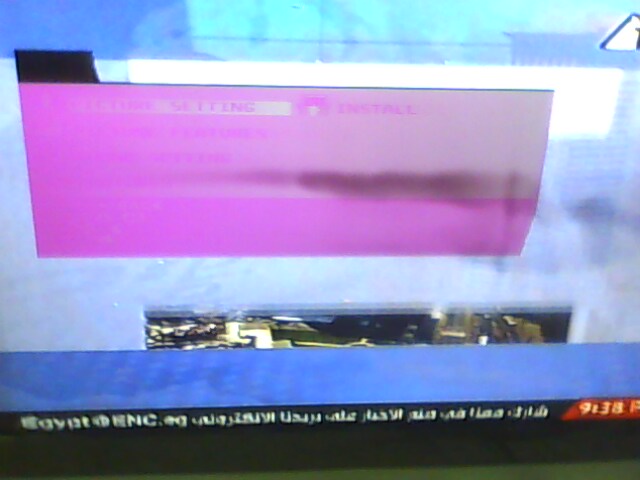

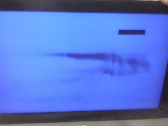

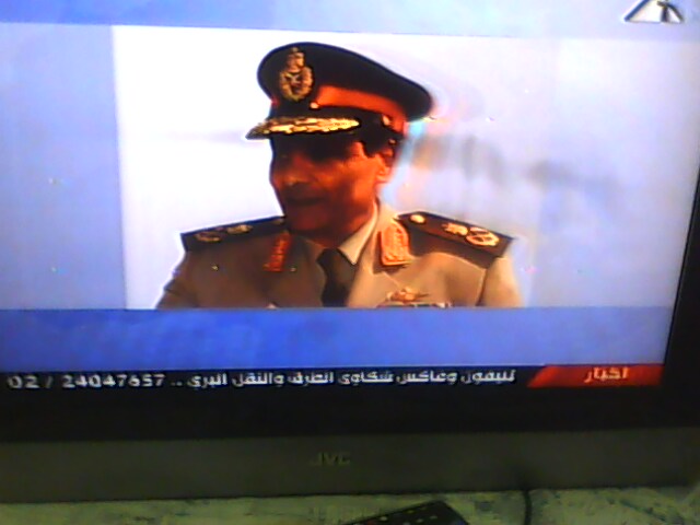

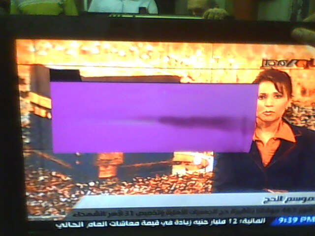

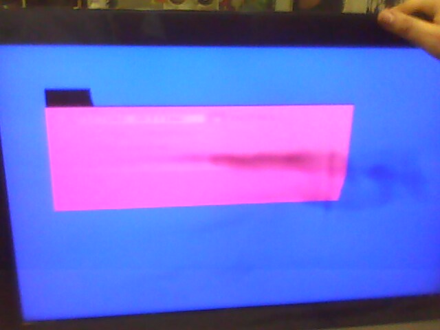

    hello
    what this fault please see photo
    i think it is the panel i read in russia forum in similar case thy open the panel and clean it
    any body did this before or have document or link about this the panel not scratch or cracked
    or this is dangerous to do
    but there is another problem main menu not in correct place and red
    and osd in menu is black can.t see any thing
    i think it is eeprom fault
    need to know if im right or not
    and need to adjust osd and menu Position
    anybody have dump for eeprom
    or this fault software in flash memory
    or whatttttttttttttttttttttttttt
    hope some one have experience with this problem need help with any information
    regards[img]JVC LT-Z26S2 - Błędna pozycja menu i czerwony ekran, EEPROM czy panel?[/img]]Link[/url][img]JVC LT-Z26S2 - Błędna pozycja menu i czerwony ekran, EEPROM czy panel?[/img][img]JVC LT-Z26S2 - Błędna pozycja menu i czerwony ekran, EEPROM czy panel?[/img][img]JVC LT-Z26S2 - Błędna pozycja menu i czerwony ekran, EEPROM czy panel?[/img][img]JVC LT-Z26S2 - Błędna pozycja menu i czerwony ekran, EEPROM czy panel?[/img][img]JVC LT-Z26S2 - Błędna pozycja menu i czerwony ekran, EEPROM czy panel?[/img]

  • #9 10504325
    Amro eid
    Posty: 231
    Ocena: 42
    hello colleagues
    this is the result of working on this tv to help any body face it
    it is panel fault and can not repairable
    i made sure from another set i tried all boards no way
    and it is common fault in this model
    customer refuses to repair it because of high costs of replacing the panel and take
    it without repairing
    kind/regards
