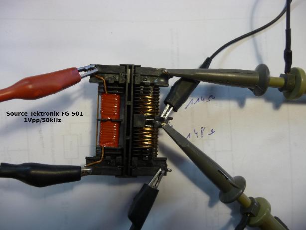

    Five years old TV set. Backlight suddenly stopped, black screen. Can see picture with a flashlight facing the screen. Sound is ok. No burned smell.
    Suspected inverter on board PLHL-T808A MPR 0.1 2722 171 00749.
    Removed and measured @~23°C the transfo T701.
    Primary winding: 0.4 Ω including test leads.
    Secondary winding EL45-GR7: 148 Ω.
    Secondary winding EL47-GR3: 114 Ω.

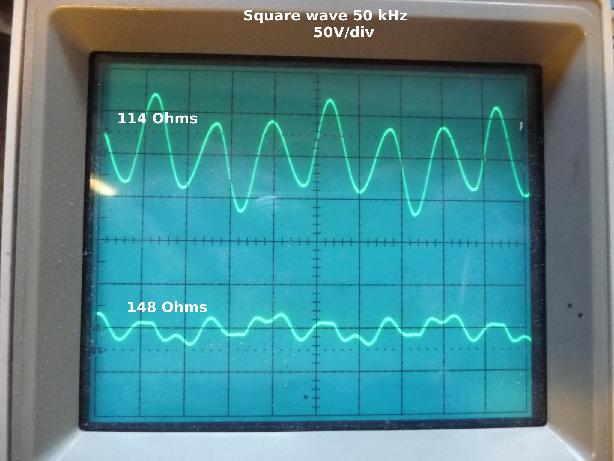

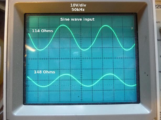

    Tested the T701 on a function generator with 1Vpp on primary. See pictures.
    Three questions:
    Is this enough indications to be sure only the T701 is defective?
    Should I go for a full T808A board replacement?
    Is a new board 2711 171 90104 a direct replacement for 2711 171 00749?

    Thanks for quick reply and link. Would you explain me how to go to "(attached) SCC_86941 "TV set cannot power up/start-up", to check transformer T701". Noob didn't find it. Found :D
    Also on topic Felix10 found that winding resistance values were around 112Ω. Seems I've one which is way over this.
    I try to keep repair cost as low as possible even if I understand that a new board will fix it but a new board is around 150€ here. So half the price of a brand new LED TV same size.
