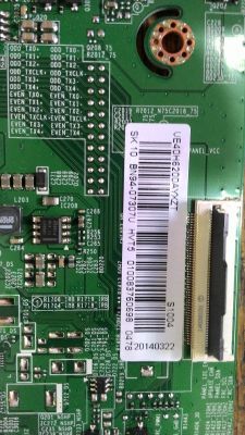

    please i need one dump for tv samsung ue40h6200ay

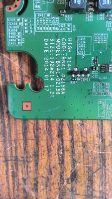

    Hello
    this mainboard have 2 chip 24c512 and w25q40cl
    and to be repaired needs to be dumped
    maunboard BN41-02156 BN94- 07307U[DO RESTART TV SAMSUNG UE40H6200AY] Szukam dumpa do TV Samsung UE40H6200AY

    they are not the same adress[DO RESTART TV SAMSUNG UE40H6200AY] Szukam dumpa do TV Samsung UE40H6200AY
    for ue40h6200aw and ue40h6200ak i found not are same
    I've tried it but not power on tv
