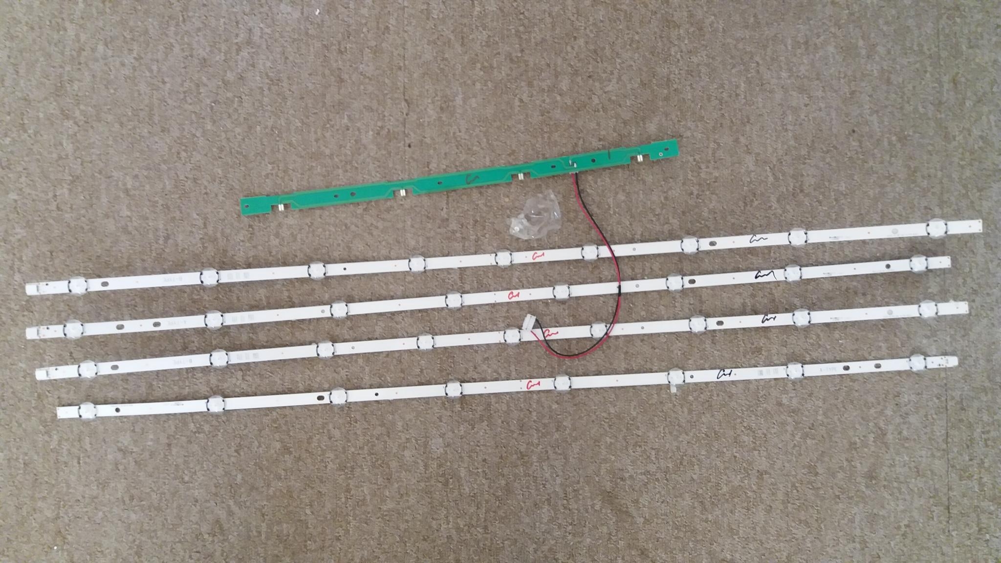

    This is LED stripScreen Type(s):
    Spoiler:
    VES430QNDL-2D-N11 / VES430QNDL-2D-U11 / VES430QNDL-2D-N12 / VES430QNDS-2D-N11 / VES430QNDS-2D-U11s
    for models TV
    Hitachi 43HK15T74U 43HK6T74U
    Linsar 43HDR510 43UHD200
    Bush LED43292UHDFVP LED43292UHDFVPHDR
    Digihome 43298UHDHDRCNTD
    JVC LT-43C870 LT-43C862 (A)(B)(C)
    Luxor LUX0143001/01 LUX0143003/01 LUX0143004/01
    Techwood 43A06USB 43AO6USB 43A04USB 43AO4USB
    Toshiba 43U5766DB 43U6663DB 43U6763DB 43U5663DB
    Finlux 43UTD217B-P
    Strip numbers:
    2pcs A – VESTEL 43″ DRT UHD A-TYPE REV0.3 8x LED
    2pcs B – VESTEL 43″ DRT UHD B-TYPE REV0.3 9x LED
