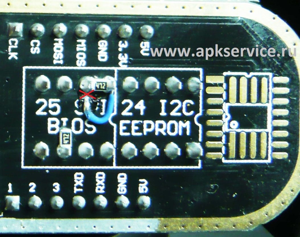

    Poczytaj o modyfikacji
    Link
    Spoiler:
    In the process of working with the programmer, some shortcomings were identified,
    - one of them: it is not possible to reset / set the QE bit in the second status register.
    Read the specification, for example, on the chip W25Q64FV, and find the item Quad Enable (QE), in which there is a warning:
    WARNING: If the /WP or / HOOD pins are tied directly to the power supply or ground during standard SPI or Dual SPI operation, the Qubit should never be set to a 1.
    To fix this problem, you need to disconnect the #WP (pin 3) and #HOLD (pin7) legs from the VC and connect them to the VCC via 4.7 kOhm resistors.
    On the "black programmer" it looks like this:
    Jak zgrać bios do pustej płyty głównej w HP Zbook G1?
