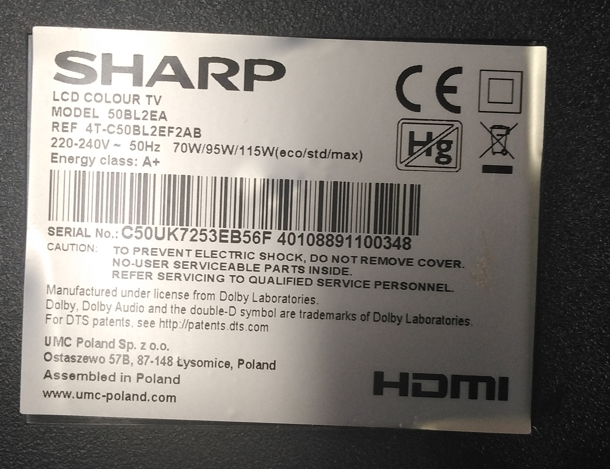

    eventually, you can try a full software recovery
    post a photo of the sticker on back of the tv

    System Info:
    HDCP1.4 FFFFFFFF
    HDCP2.2 FFFFFFFF.
    Potrzebny
    Upgrade HDCP1.4
    Upgrade HDCP2.2
    Potrzebny Service Manual.
    • Sharp 50BL2EA, Płyta T.MS6886.U705, LC-50UK7253E - Brak obrazu i dźwięku na HDMI, tryb serwisowy model.jpg (2.11 MB) Musisz być zalogowany, aby pobrać ten załącznik.

    by serial number, your tv has the panel V500DJ6-QE1
    if you want to try, at your own risk, I have the software for panel V500DJ7-QE1
    I don't know if the software I have can fit on your panel
