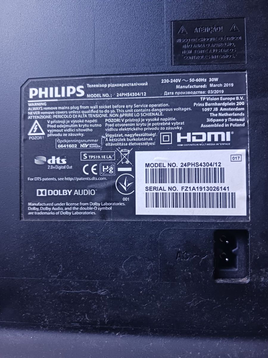

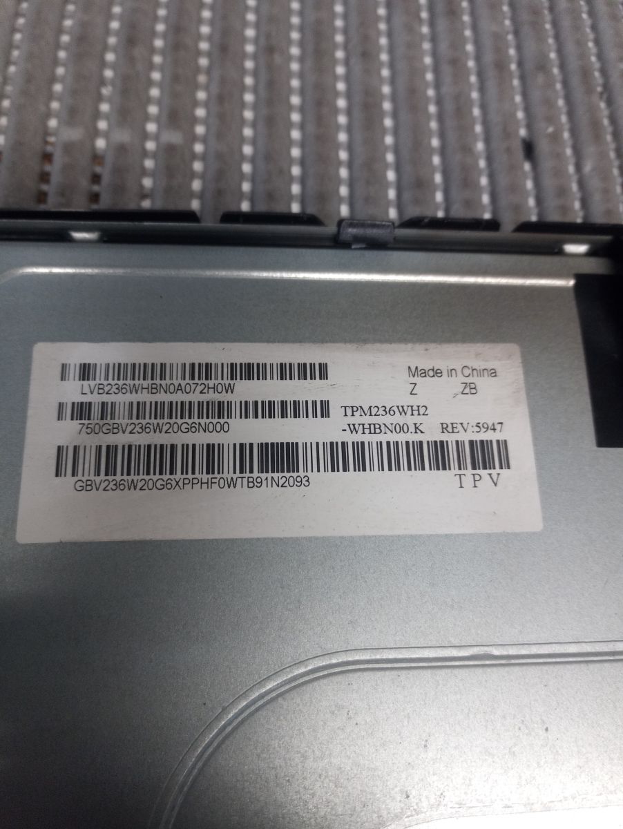

    Need Firmware or nand flash please, tv stuck in logo, won’t start.
    Chassis: TPS19.1
    Panel: TPM236WH2
    NAND: W29N01HVSINF
    Main: 715G9249-M0B-001-004Y
    Naklejka z informacjami o sprzęcie telewizora, w tym nazwy modelu i numer seryjny.
    Tabliczka znamionowa telewizora Philips z modelami, numerami seryjnymi i informacjami ostrzegawczymi.

    try first with the pkg file
    rename the file to upgrade_loader.pkg, and copy it on an empty usb stick
    insert the usb stick in the tv
    plug the power cord: the tv will detect the usb stick and turns on automatically, showing the upgrade process

    5 Stars, thank you, problem solved.
    Regards!
