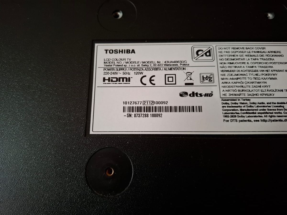

  • #10 21622162
    MTB
    Posty: 27
    >>21621930 Hi, actually I have just sticker from back side of TV - is it ok to identify firmware?
    Naklejka z tyłu telewizora Toshiba z informacjami o modelu i zasilaniu
  • #11 21622269
    billobirillo
    Poziom 33  
    Posty: 1112
    Pomógł: 333
    Ocena: 770
    the mainboard should be a 17MB170: do you confirm?
    but the sticker is not enough to identify the software
    photo of panel label and tcon module is required
    this is required to send the correct software
