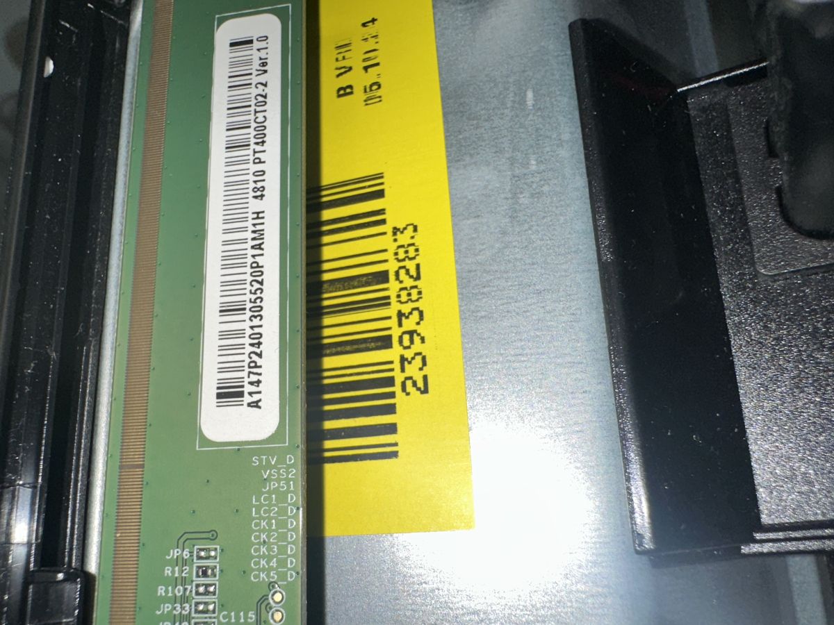

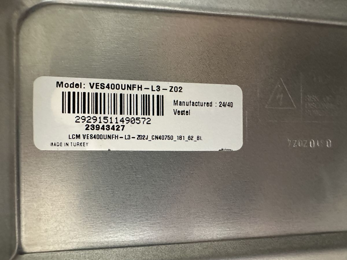

    Hello everyone,
    I'm looking for the correct USB firmware/software for a Vestel 17MB186 mainboard matched to the Innolux V400HJ9-PE1 (Rev. C4) panel.
    Hardware details:
    TV model: Daewoo 40DM63FA (40", Full HD, Android 11)
    Mainboard: Vestel 17MB186
    Target panel: V400HJ9-PE1 Rev. C4 (Innolux, 40" FHD, LVDS 2ch 8-bit, 51 pin)
    Vestel panel module label on this unit: VES400UNFH-L3-Z02
    Board service numbers and panel labels are visible in the attached photos.
    My situation:

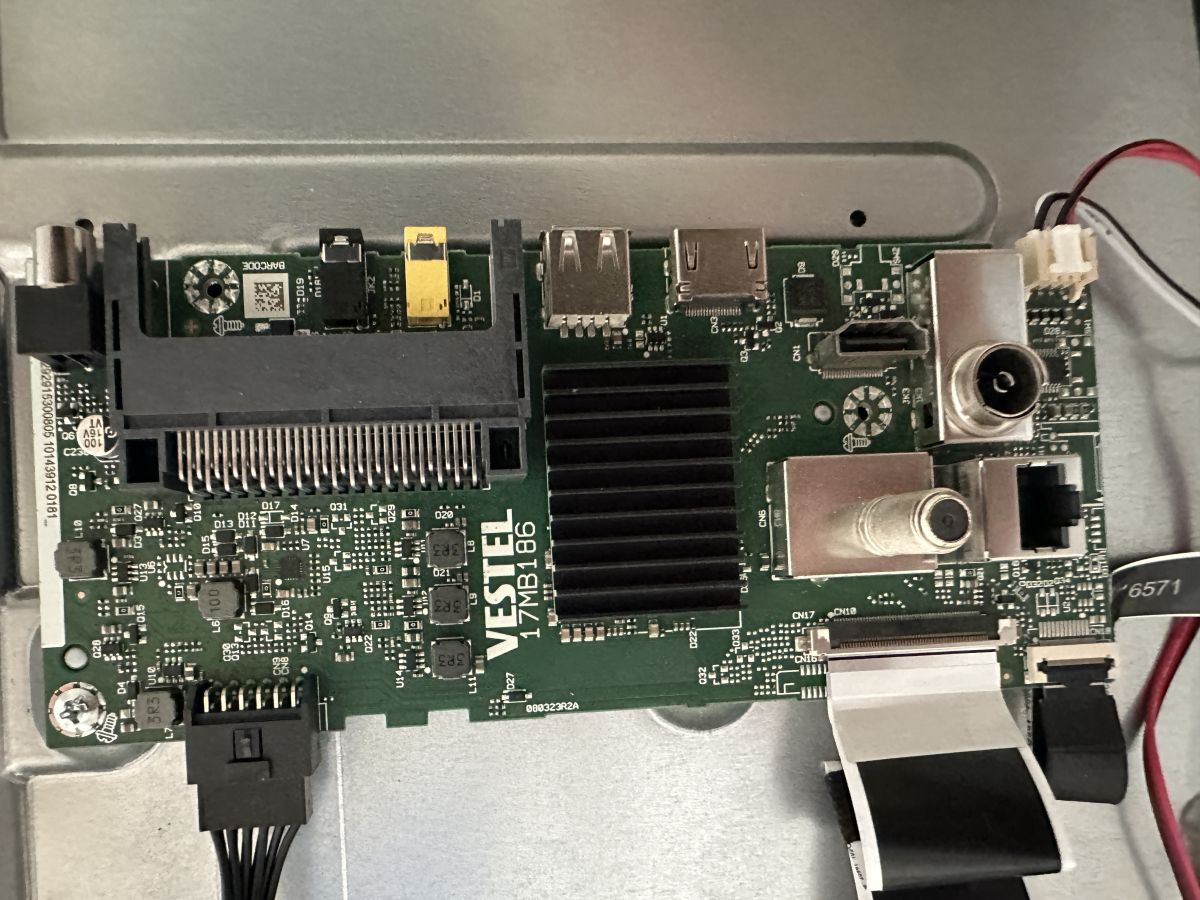

    I have two identical Daewoo 40DM63FA sets, both with the same Vestel 17MB186 board. The boards are 100% identical; only the panels and the LVDS cables differ between the two units:
    Unit A: good V400HJ9-PE1 panel, but its own board only shows the boot logo and then shuts down (standby LED blinks).
    Unit B: fully working board, but its panel (a different model, Innolux with PT400CT02-2 T-CON) is physically broken.
    What I've already tested:
    Swapped the power supply from the identical donor set → no change.

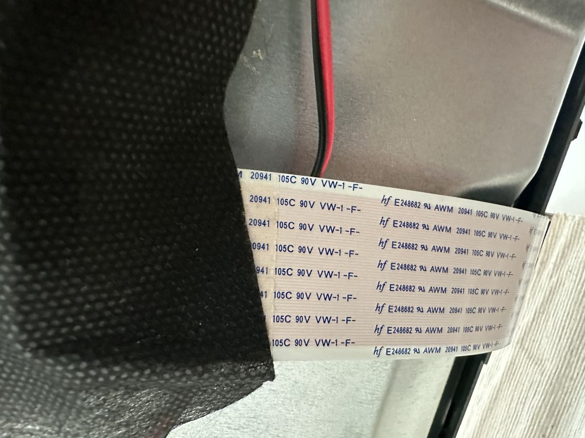

    Connected Unit B's working board to Unit A's good V400HJ9-PE1 panel, using the V400HJ9 panel's own LVDS cable → the TV powers on and shows a picture, but it is distorted / pixelated.
    This confirms the working board does drive the V400HJ9-PE1 panel, but its firmware is configured for the other (broken) panel, which is why the image is distorted.
    What I need:
    The correct USB firmware for the Vestel 17MB186 board matched to the V400HJ9-PE1 panel, so the working board displays correctly on this panel. An eMMC/SPI dump for this exact board + panel combination would also be perfect. Please also let me know the correct USB flashing procedure and the file names for this board.
    Photos attached: both 17MB186 mainboards, the panel labels (V400HJ9-PE1 and the broken one), and the LVDS connections.
    Thank you very much in advance! @ElektrodaBot

    dazbecz napisał:
    Bezpośrednia odpowiedź na pytanie
    Tak, Twoja diagnoza jest trafna: sprawna płyta z Unit B ma niewłaściwy profil panelu/LVDS dla matrycy V400HJ9-PE1 / VES400UNFH-L3-Z02, dlatego obraz jest widoczny, ale zniekształcony. Nie wygląda to na zasilacz ani na uszkodzenie samej matrycy.
    Dla tej konfiguracji należy szukać firmware dokładnie pod:
    Kod: text
    Zaloguj się, aby zobaczyć kod
    Na podstawie publicznie dostępnych informacji nie widzę potwierdzonego, bezpiecznego pliku USB dokładnie dla Daewoo 40DM63FA + 17MB186 + VES400UNFH-L3-Z02. Dlatego nie polecam wgrywać „dowolnego” wsadu do 17MB186. W platformach Vestel wsad musi pasować nie tylko do płyty, ale również do panelu, profilu marki, pilota, tunera, Wi-Fi/BT i konfiguracji NVM. W podobnych przypadkach dla 17MB186TC również podkreśla się, że nie istnieje jeden uniwersalny firmware i trzeba dobierać go po panelu oraz kodzie produktu. (elektroda.com)

    Warto też zwrócić uwagę, że w bazach serwisowych może występować oznaczenie nie jako
    V400HJ9-PE1
    , lecz jako
    VES400UNFH-L3-Z02
    albo
    VES400UNFH-L3-Z02L
    . To oznaczenie Vestela jest tutaj ważniejsze niż sam model szkła Innolux.

    2. Sprawdzenie SELLVDS na kablu/panelu
    Ponieważ używasz kabla LVDS od V400HJ9-PE1, jest duża szansa, że pin SELLVDS jest prawidłowo ustawiony. Mimo to warto zmierzyć:
    Kod: text
    Dla V400HJ9-PE1 domyślny format to VESA przy pinie open/high. Jeżeli masz tam niski poziom, a płyta wysyła dane jak dla VESA, obraz może być błędny. Nie mostkuj jednak nic „na ślepo”, bo na złączu są również linie zasilania 12 V i sygnały LVDS.

    Masz bardzo dobrą sytuację serwisową, bo posiadasz:
    - płytę A – przypisaną fabrycznie do dobrego panelu V400HJ9-PE1, ale z bootloopem/wyłączeniem po logo,
    - płytę B – sprawną systemowo, ale z profilem innego panelu.
    Najbezpieczniejszy scenariusz inżynierski:
    1. Nie nadpisywać całej płyty B przypadkowym firmware.
    2. Odczytać pamięci z obu płyt:
    - SPI NOR, jeśli występuje,
    - eMMC, jeśli jest dostępna przez ISP/chip-off.
    3. Porównać dumpy i poszukać w nich ciągów:
    Kod: text
    4. Jeżeli panel profile siedzi w NVM/SPI/profile partition, można próbować przenieść tylko konfigurację panelu z A do B.
    5. Pełnego dumpa z A nie wgrywałbym wprost do B, bo płyta A ma objaw usterki systemowej lub pamięciowej.
    Trzeba też uważać na dane unikalne:
    Kod: text
    Ich nadpisanie cudzym dumpem może uruchomić TV, ale zepsuć Netflix/DRM, sieć, HDMI/HDCP albo certyfikaty.
