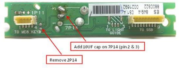

    1) On the IR board 31391236327x (*), remove defective capacitor 2P10 or 2P14 (depending on the board version) and add a new 10uF_10%_6V3_X5R_0805 capacitor (order code 319802711090 or 202055200175) at pin 2 and 3 of 7P14 (see figure 1).
    2) Remove the felt on the IR board before fixing it back to front cabinet (to decrease the mechanical stress on the board/components).
