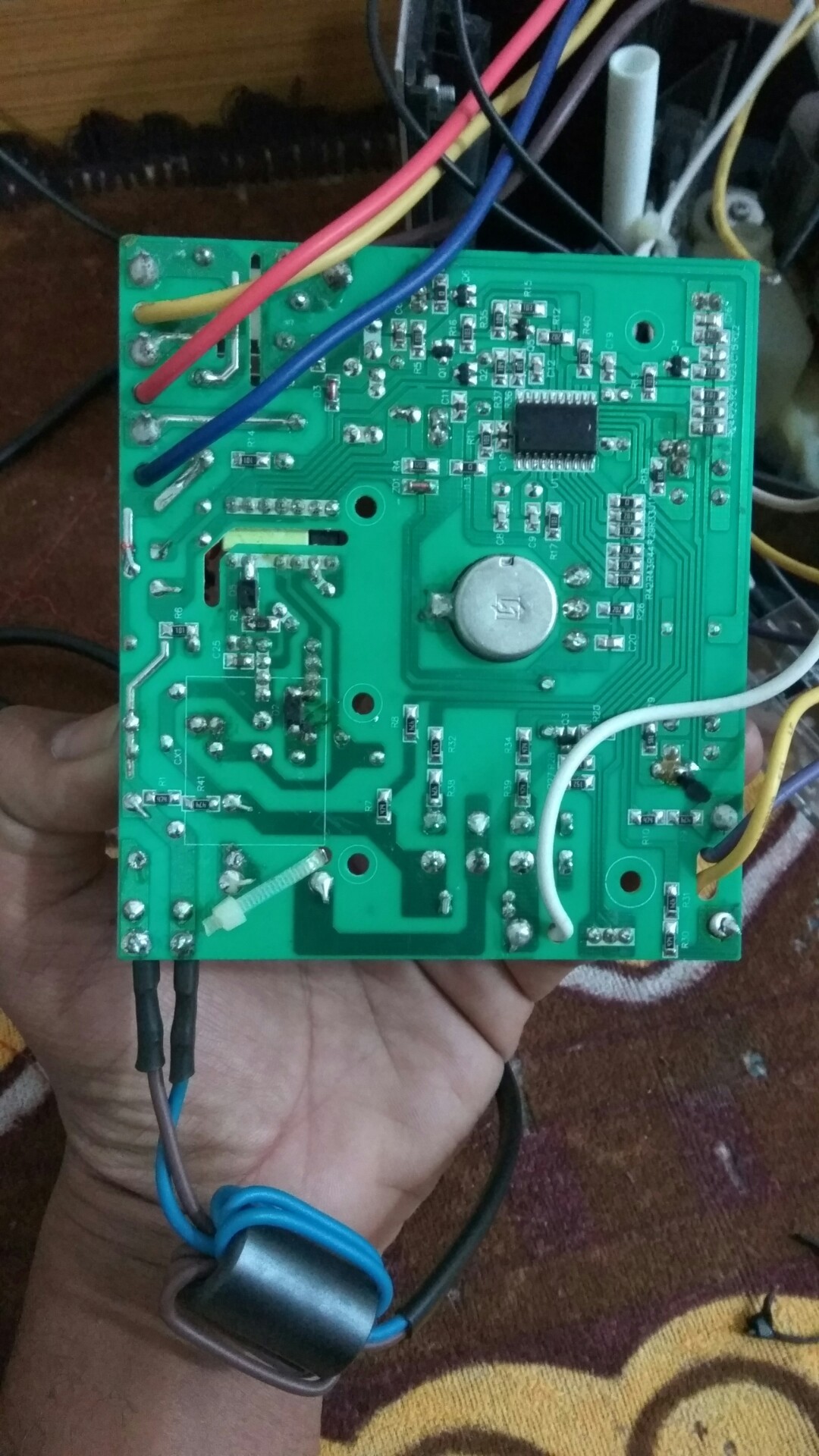

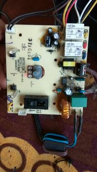

    Ashish_Jamesh
    Posty: 3
    Ocena: 6
    I bought discontinued Philips HR7775/00 Food Processor. I tested it after opened the box. Second day when I plugged it and power it up there was some short circuit sound came from the plug as well as from the main unit. And it didn't power up. There is no warranty/guarantee so I tried to repaired it to myself. After searching the net (your website) and change IN4007 Diode, Viper12A, ZNR, 2.2uh Inductor but my machine still not power up. Please help me to trace the issue and make my Philips HR7775/00 live again.

    Ashish_Jamesh
    Posty: 3
    Ocena: 6
    voodoorider napisał:
    Are the LEDs blinking after you put the dial into "ON" position?
    No LED Blinking when I power on the unit. I didnt find schematic on internet so not able to trace the issue.
