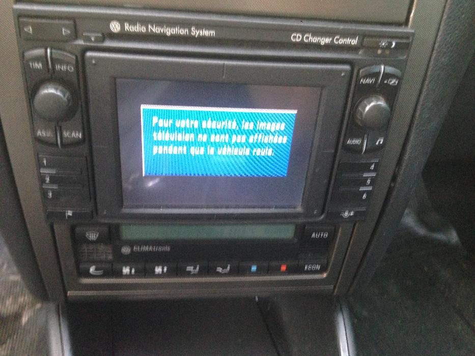

    Hello everyone,
    I have a problem with my Mfd color navigation. After i enter the security code i receive a message :"Pour votre securite, les images television ne sont pas affichés pendant que le vehicule reuts" My car is golf 4 from belgium. If anyone can help me with some tips to fix this problem please. If i rewrite firmware maybe this error vanish, but i didn't find firmware for download :-(. Thank you guys.
