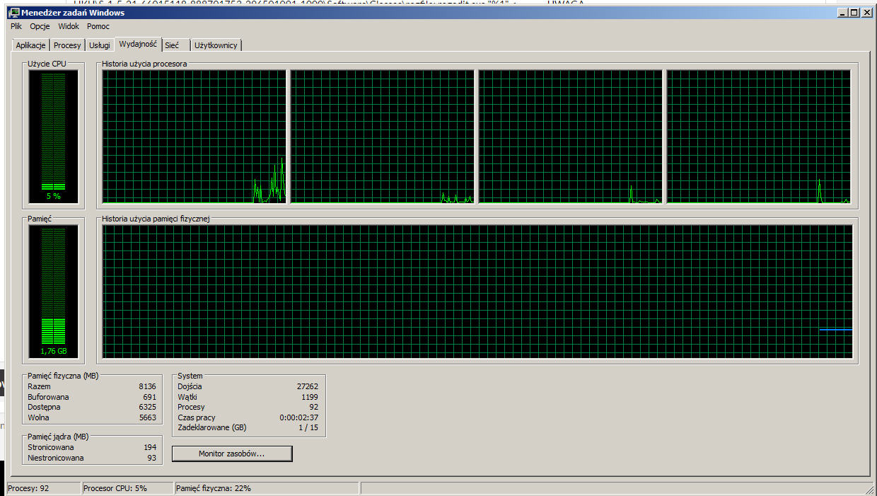

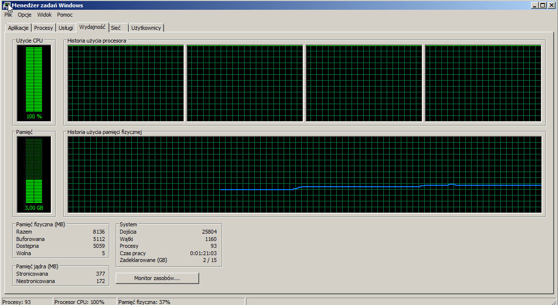

    Jak w temacie
    Explorer.exe zjada cały czas zasoby i dllhost.exe nie wiem jak usunac wirusa prosze o pomoc
    https://obrazki.elektroda.pl/2765833400_1475426251.jpg
    https://obrazki.elektroda.pl/6990769300_1475426252.jpg
    Zrobiłem skan ADwCleaner
    jak by lepiej- załaczam rejestr.

    Odinstaluj:
    Eset
    Touch Image
    YTD Video Downloader 4.9.1
    Wykonaj Fixlist.txt dla FRST:
    Task: {27DB5E6D-E3DA-4301-A6C1-435A63C58287} - \{B186DE61-ABEE-46B9-8C4E-56C7D6C32F1F} -> Brak pliku <==== UWAGA
    Task: {B8DCE5B4-16C4-4E48-A156-0600EBBDFA3F} - System32\Tasks\{B45112D3-B62C-45B3-BC5F-0D1D68334189} => pcalua.exe -a "C:\Program Files (x86)\VstPlugins\Hypersonic\SyncrosoftLicenseControlSetup.exe" -d "C:\Program Files (x86)\VstPlugins\Hypersonic"
    Hosts:
    HKU\S-1-5-21-66015118-888701753-296501091-1000\Software\Classes\regfile: regedit.exe "%1" <===== UWAGA
    HKU\S-1-5-21-66015118-888701753-296501091-1000\...\MountPoints2: {8bc2777b-b319-11e5-9a85-d8cb8ac97968} - I:\iLinker.exe
    ShellIconOverlayIdentifiers: [###MegaShellExtPending] -> {056D528D-CE28-4194-9BA3-BA2E9197FF8C} => Brak pliku
    ShellIconOverlayIdentifiers: [###MegaShellExtSynced] -> {05B38830-F4E9-4329-978B-1DD28605D202} => Brak pliku
    ShellIconOverlayIdentifiers: [###MegaShellExtSyncing] -> {0596C850-7BDD-4C9D-AFDF-873BE6890637} => Brak pliku
    ShellIconOverlayIdentifiers-x32: [###MegaShellExtPending] -> {056D528D-CE28-4194-9BA3-BA2E9197FF8C} => Brak pliku
    ShellIconOverlayIdentifiers-x32: [###MegaShellExtSynced] -> {05B38830-F4E9-4329-978B-1DD28605D202} => Brak pliku
    ShellIconOverlayIdentifiers-x32: [###MegaShellExtSyncing] -> {0596C850-7BDD-4C9D-AFDF-873BE6890637} => Brak pliku
    HKU\S-1-5-21-66015118-888701753-296501091-1000\SOFTWARE\Policies\Microsoft\Internet Explorer: Ograniczenia <======= UWAGA
    CHR HomePage: Default -> hxxps://www.google.pl/webhp?source=search_app&gws_rd=cr&ei=BcVrUsPcDKnQ4QTF0oDQCw
    CHR StartupUrls: Default -> "hxxp://www.google.com/","hxxp://google.pl/","hxxp://www.istartsurf.com/?type=hp&ts=1440915115&z=3637af1387d7e1e3cb38449gaz6zdeft0gczdt6bdo&from=cor&uid=ST3500418AS_5VMA6079XXXX5VMA6079","hxxp://www.istartpageing.com/?type=hp&ts=1452010614&z=8e8918a05b63cb1a6dfd4c9g4z1w5o0eag4eeq6e0q&from=cmi&uid=SamsungXSSDX850XEVOX250GB_S21PNSAG608923V","hxxp://www.yoursearching.com/?type=hp&ts=1452084107&z=9d52050bf2a58ed0d6ee158g5z6w0o9ebbcz7g4e6m&from=itr&uid=samsungxssdx850xevox250gb_s21pnsag608923v","hxxp://www.gazeta.pl/0,0.html?p=188"
    CHR Extension: (Discover Treasure) - C:\Users\Ę\AppData\Local\Google\Chrome\User Data\Default\Extensions\engfcppjlcejaecoagbklbkfhjeihond [2016-01-05] [UpdateUrl: hxxp://cdn.discovertreasurenow.com/update] <==== UWAGA
    S3 dbx; system32\DRIVERS\dbx.sys [X]
    EmptyTemp:
    Uzyj process explorer (ze strony MS) i sprawdz czy we wlasciwosciach explorera masz podany modul, ktory powoduje obciazenie.

    Eset - odinstalowałem ale teraz nie mam antywirusa
    Touch Image -nie da sie odinstalowac czy mam usunac wpis?
    Explorer.exe i dllhost.exe zjadają zasoby procesora - jak usunąć wirusa?
    YTD Video Downloader 4.9.1 - nie widze tego programu do odinstlowania
    Fix zrobiłem i dałem napraw.
    po restarcie komputer znacznie lepiej funkcjonuje.
    Niestety nie wiem o co chodzi z tym:

    Juz nie musisz skoro nie ma obciazenia.
    > Eset - odinstalowałem ale teraz niemam antywirusa
    Zainstaluj jakis darmowy, a nie piracka wersje eset, do tego i tak byl wylaczony.
    > Touch Image -nieda sie odinstalowac czy mam usunac wpis?
    Mozesz.
    Ps. Nie da, nie mam!
