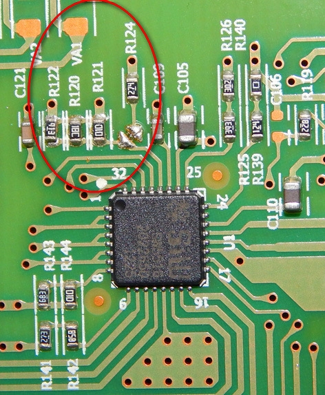

    Hitachi 32HXC01U Link
    - PSU - 23101547 - 17IPS19-5 V.1 - 061112
    - T-Con - 6871L-2823F - 6870C-0401C - 32/37/42/47/55 FHD TM120 Ver 0.3
    - dobierzesz matrycę w tym 32" HD Ready 1366x768
    - - Main AV - (23132474 )- 17MB82-2 - 19122012
    - LED Driver Board - 6917L-0084A - 3PHCC20002B-H - PCLF-D104 A - REV 0.7
    U1 SW5516 + polowe AOD482 Link
    Hitachi 32HXC01U - miga naprzemiennie dioda POWER na czerwono i niebiesko
    Pisałem np. Link
    Popatrz na SM od th-l32c4s_chassis_km10v Link
    to reduce the current IF by LED strip ... you need to increase the value of the resistors connected between the pin.28 SW5516 leg and GND.
    11.4 K current=510ma.
    12.8 K current=446ma.
    ...removed R 122 91k current=446ma.
    With the cable disconnected from THE t-CON backlight works.
