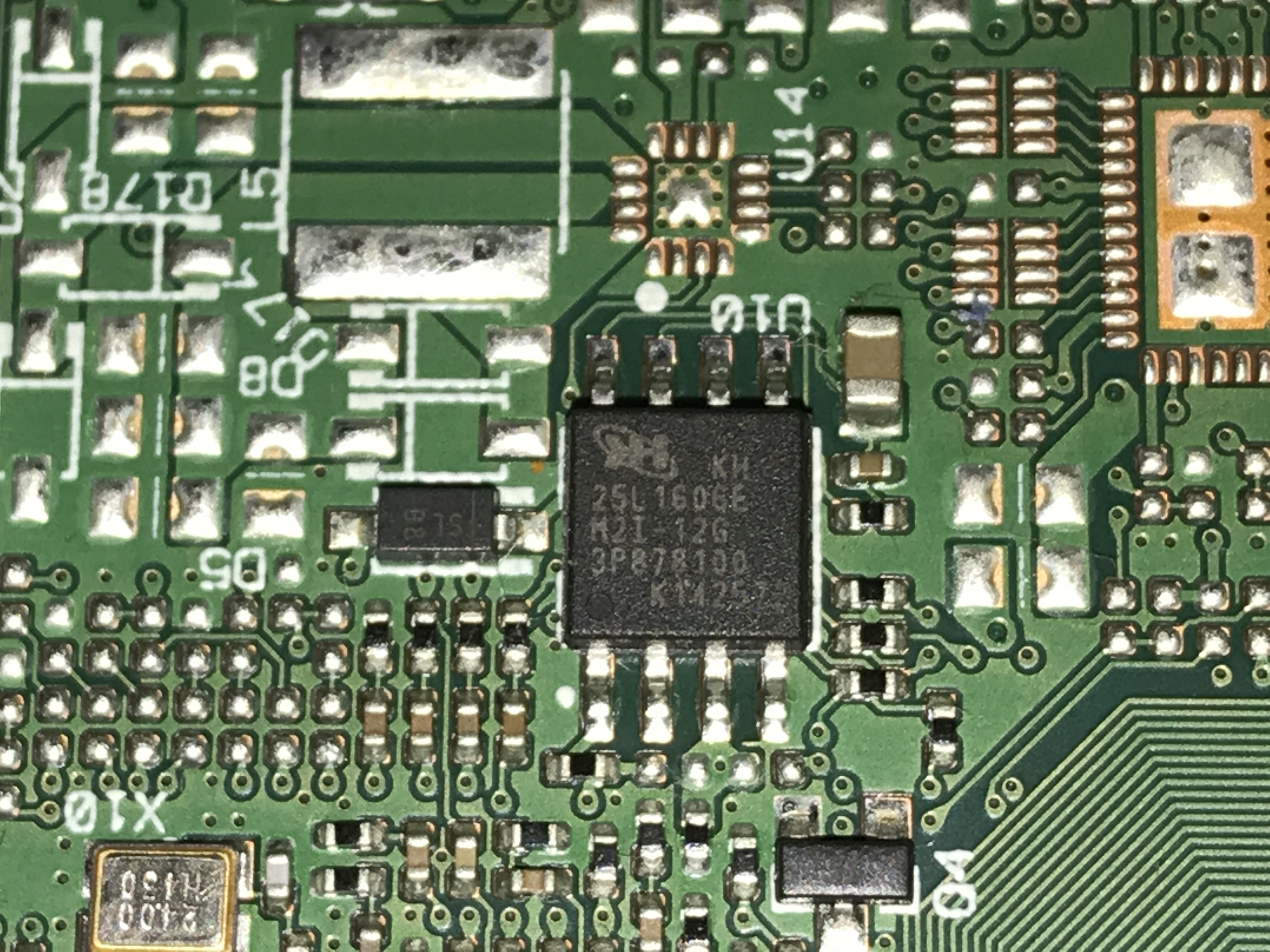

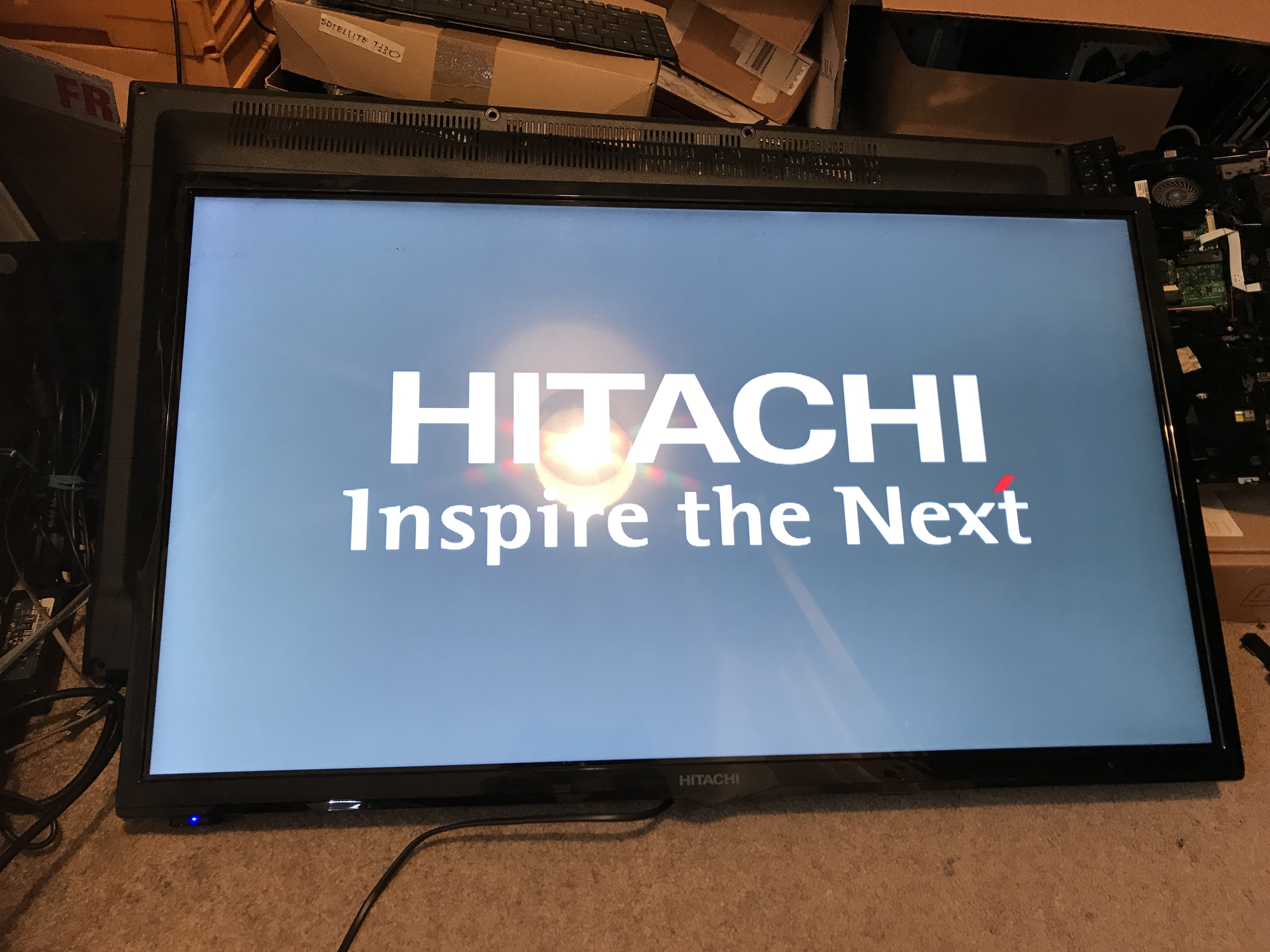

    Hi, guys.
    I have Hitachi 32HYT46U with the problem random switching. Turn on, can see Hitachi logo and turns off then. And the same again. I think that reprogramming of U10 would resolve this problem. If anyone, you guys, have a right bin file, please share with me.
    All numbers and information can be found on the pictures attached.
    Thank you in advance.
    Czemu tak myślisz, przecież ten U10 działa:

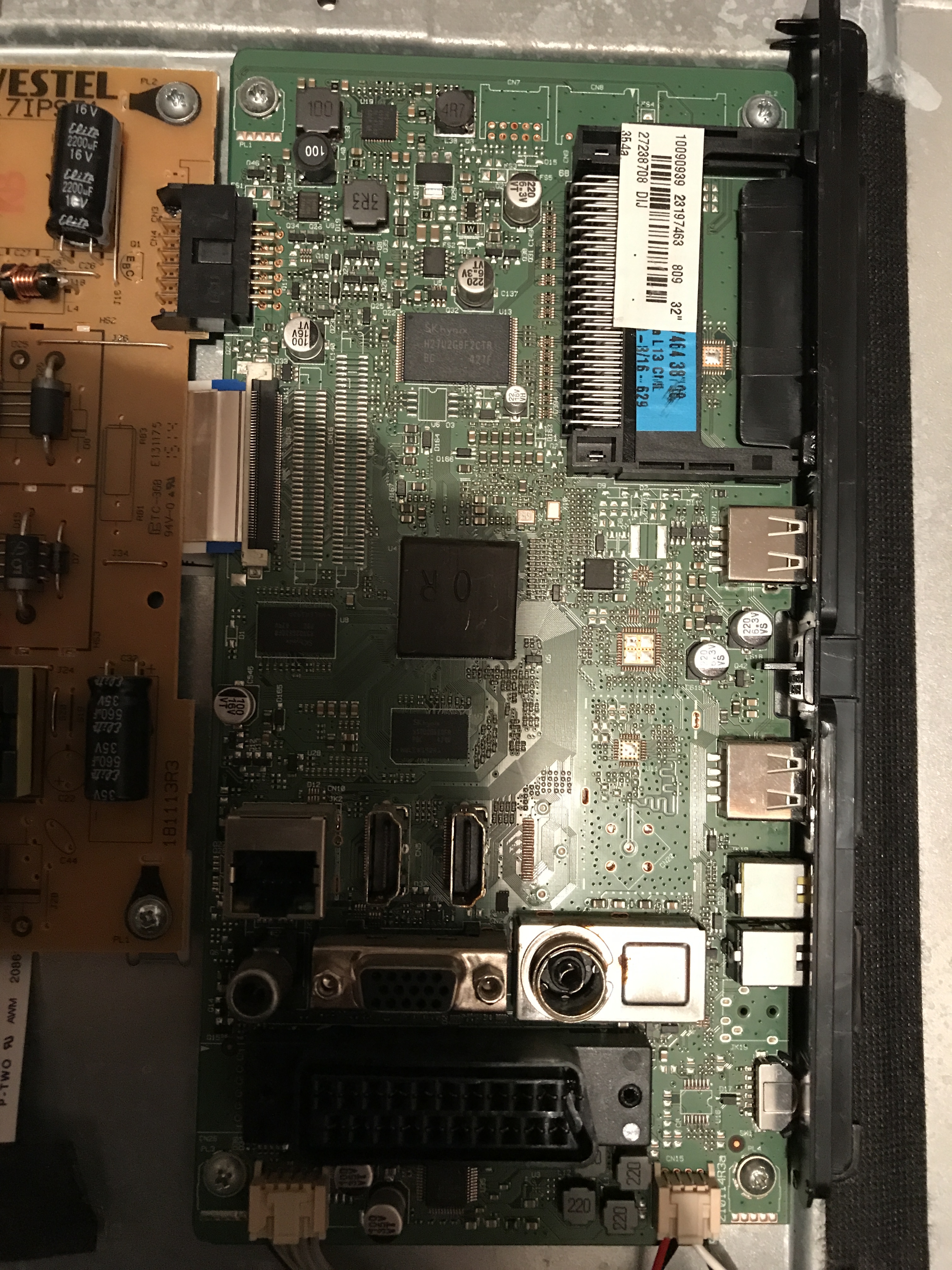

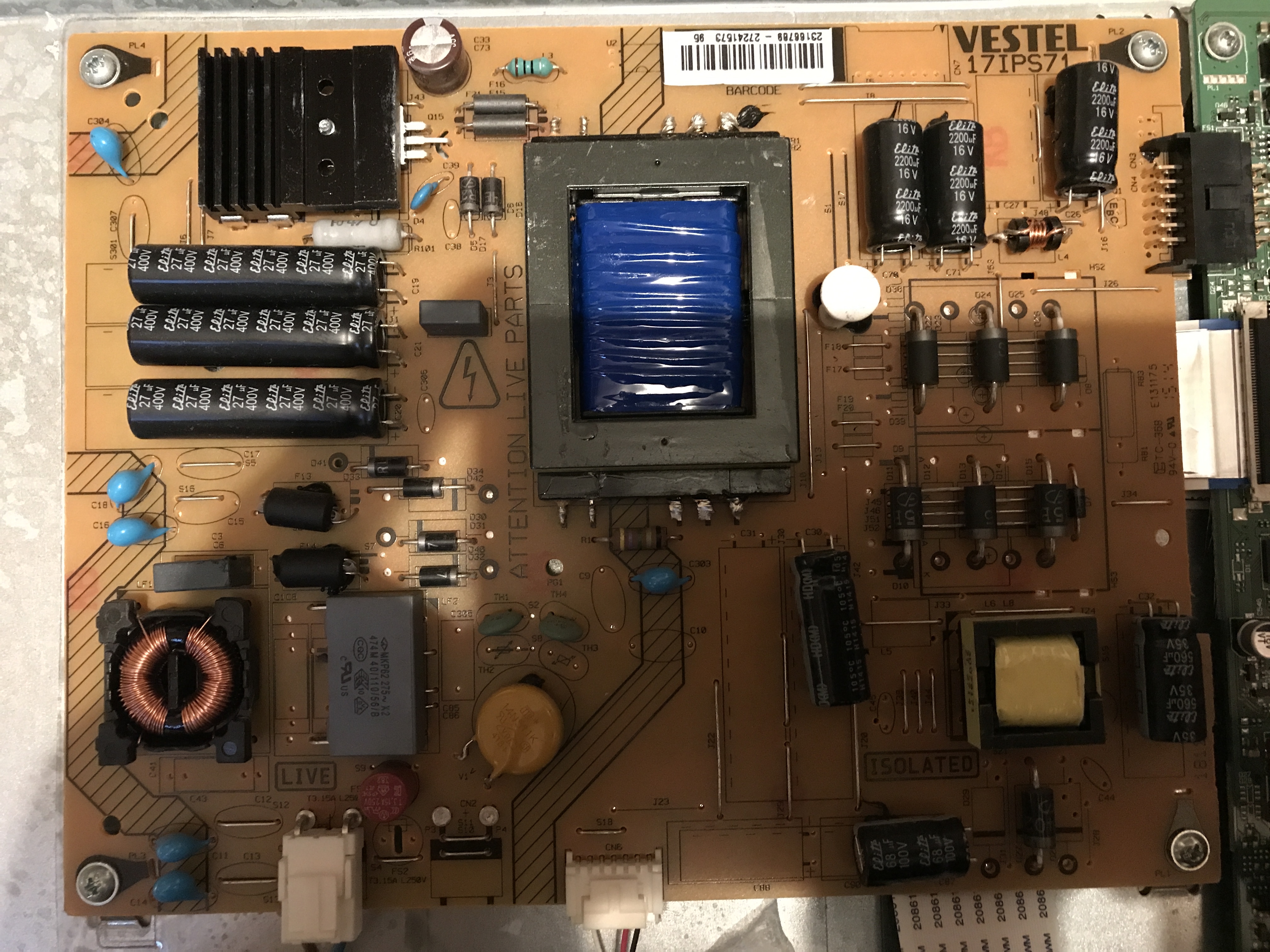

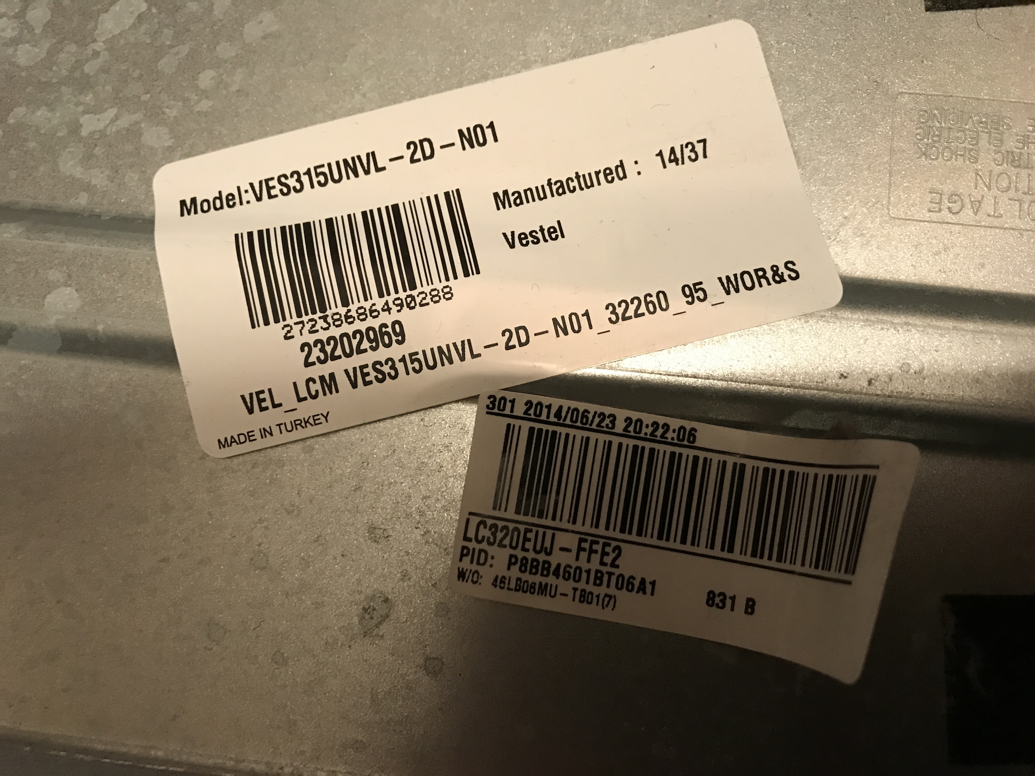

    GanCegall napisał:
    Why do you think so,
    I think that something wrong in the brine of TV. It's just my opinion. I would start from flashing Eeprom. Will look for another treat if flashing will not help. What is your opinion on this?
    Main board: Vestel 17MB95M
    Power board: Vestel 17IPS71
    Panel: LC320EUJ-FFE2
  • #5 17682887
    AntasIRL
    Poziom 7  
    Posty: 19
    badael napisał:
    Help some time.
    Unfortunately, doesn't work. Just getting Logo and restarting again and again...
