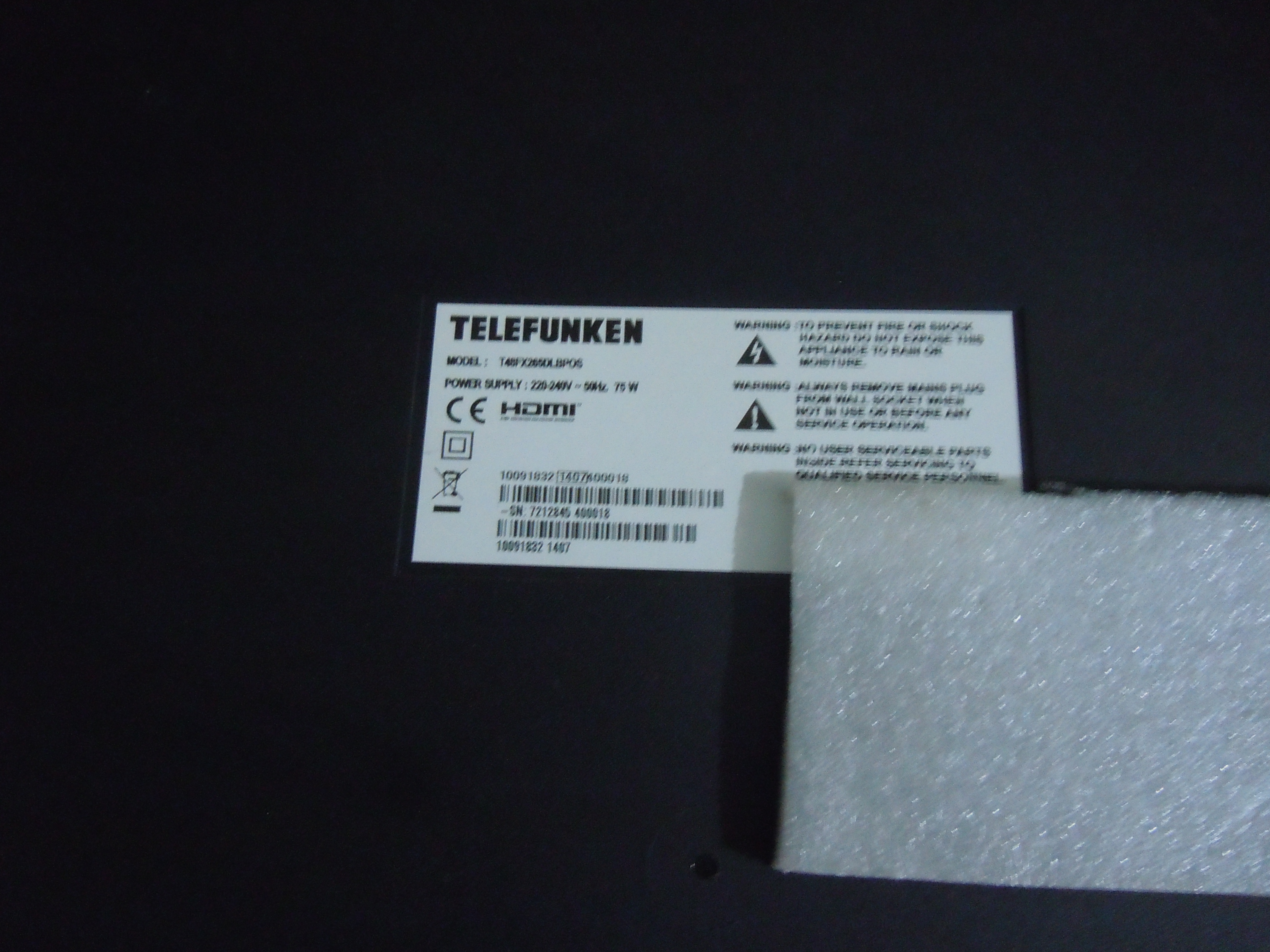

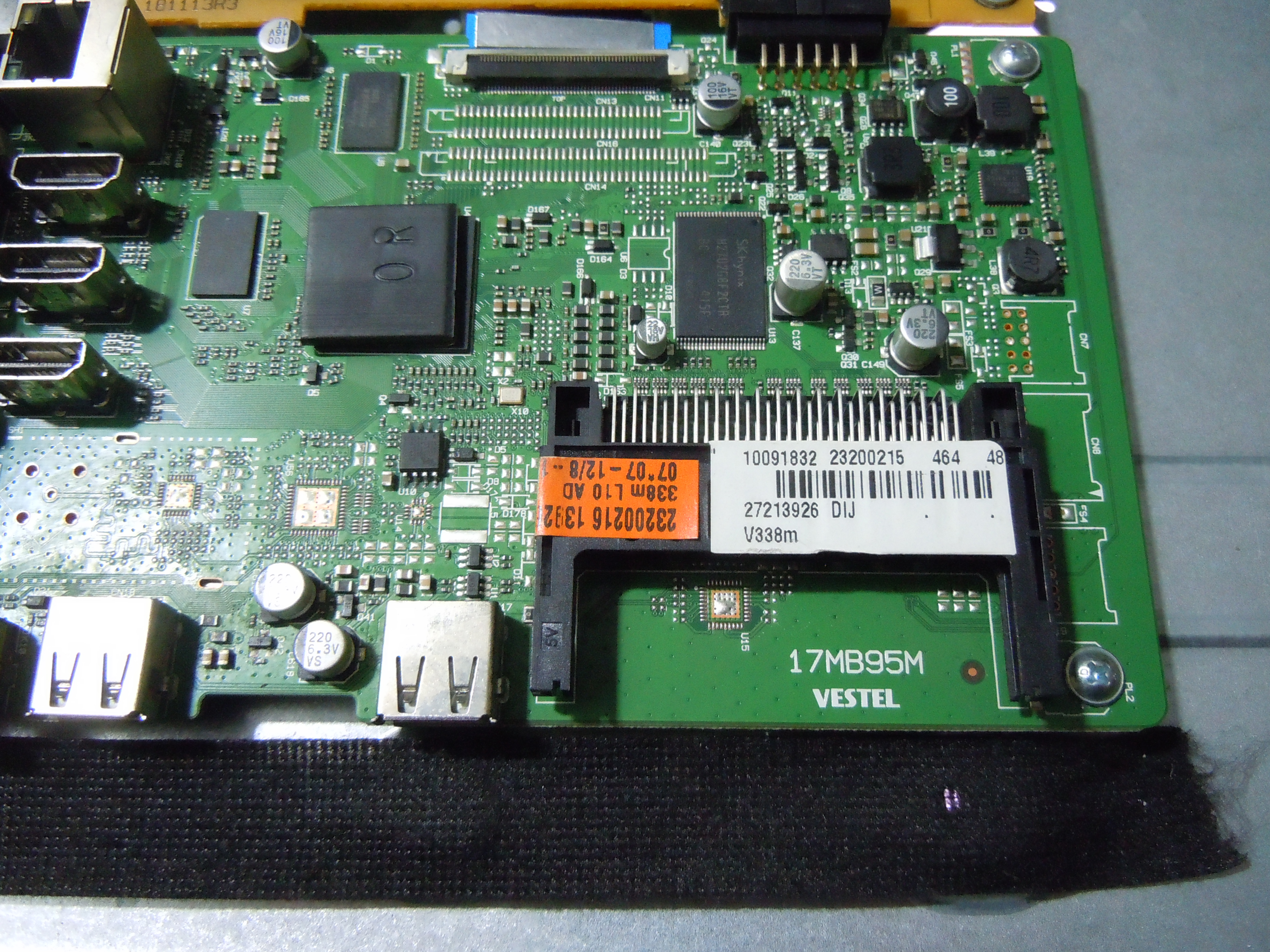

Mark:telefunken
Model: t48fx265dlbpos
Chassis (main board, components):17mb95m version v338m
LCD Screen/Panel (if exist):ves480unds-2d-n01
More informations: greetings for the tv servisers. i have requested the v338m software and in his absence i have set another version v219z where it was completely successful so i share it with you.
