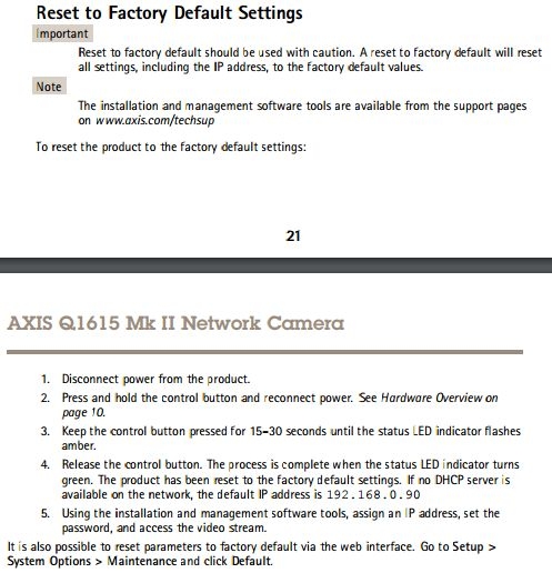

    Dla jasności zapytam masz tą czarna czy białą wersję?
    AXIS Q1615-E Mk II
    Kamera Axis Q1615 MKII Amber led miga brak komunikacji.
    AXIS Q1615 Mk II
    Próbowałeś przywracać ustawienia domyślne zgodnie z instrukcją ?
    Spoiler:
    Reset to Factory Default Settings
    Important
    Reset to factory default should be used with caution. A reset to factory default will reset
    all settings, including the IP address, to the factory default values.
    Note
    The installation and management software tools are available from the support pages
    on www.axis.com/techsup
    To reset the product to the factory default settings:
    21
    AXIS Q1615 Mk II Network Camera
    1. Disconnect power from the product.
    2. Press and hold the control button and reconnect power. See Hardware Overview on
    page 10.
    3. Keep the control button pressed for 15–30 seconds until the status LED indicator flashes
    amber.
    4. Release the control button. The process is complete when the status LED indicator turns
    green. The product has been reset to the factory default settings. If no DHCP server is
    available on the network, the default IP address is 192.168.0.90
    5. Using the installation and management software tools, assign an IP address, set the
    password, and access the video stream.
    It is also possible to reset parameters to factory default via the web interface. Go to Setup >System Options > Maintenance and click Default.
    Sprawdź czy w AXIS Camera Management wykrywana jest kamera. Ewentualnie w AXIS Device Manager
