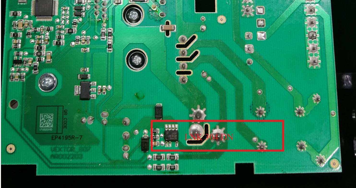

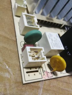

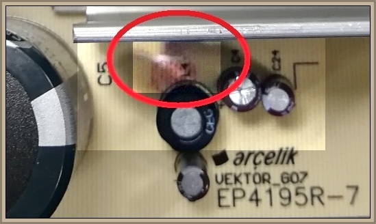

    Hi,
    I found this website in google, when I was searching on how to repair a PCB board. I have a Beko washer/dryer that became dead - No power at all. I have engineer out who confirmed power is going to the PCB boards, he said PCB board looks to be the problem. I hope someone can help me diagnose the problem. The board is showing no sign of damage. Perhaps someone can guide me on doing some tests with a multimeter? I have a multimeter but I am no expert. Thank you.

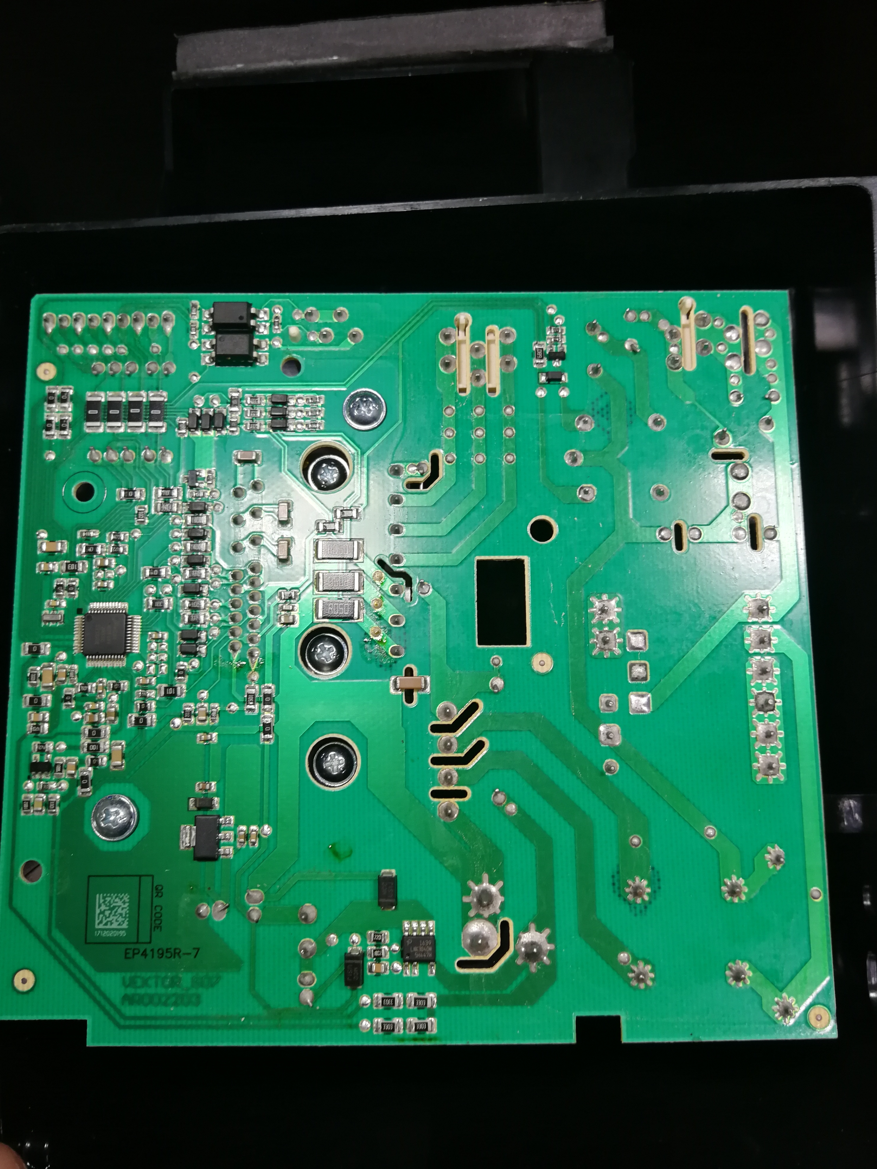

  • #3 17855957
    jaisunny
    Poziom 6  
    Posty: 9
    Ocena: 3
    Kenworth 18 napisał:
    Podaj model urządzenia kolego.

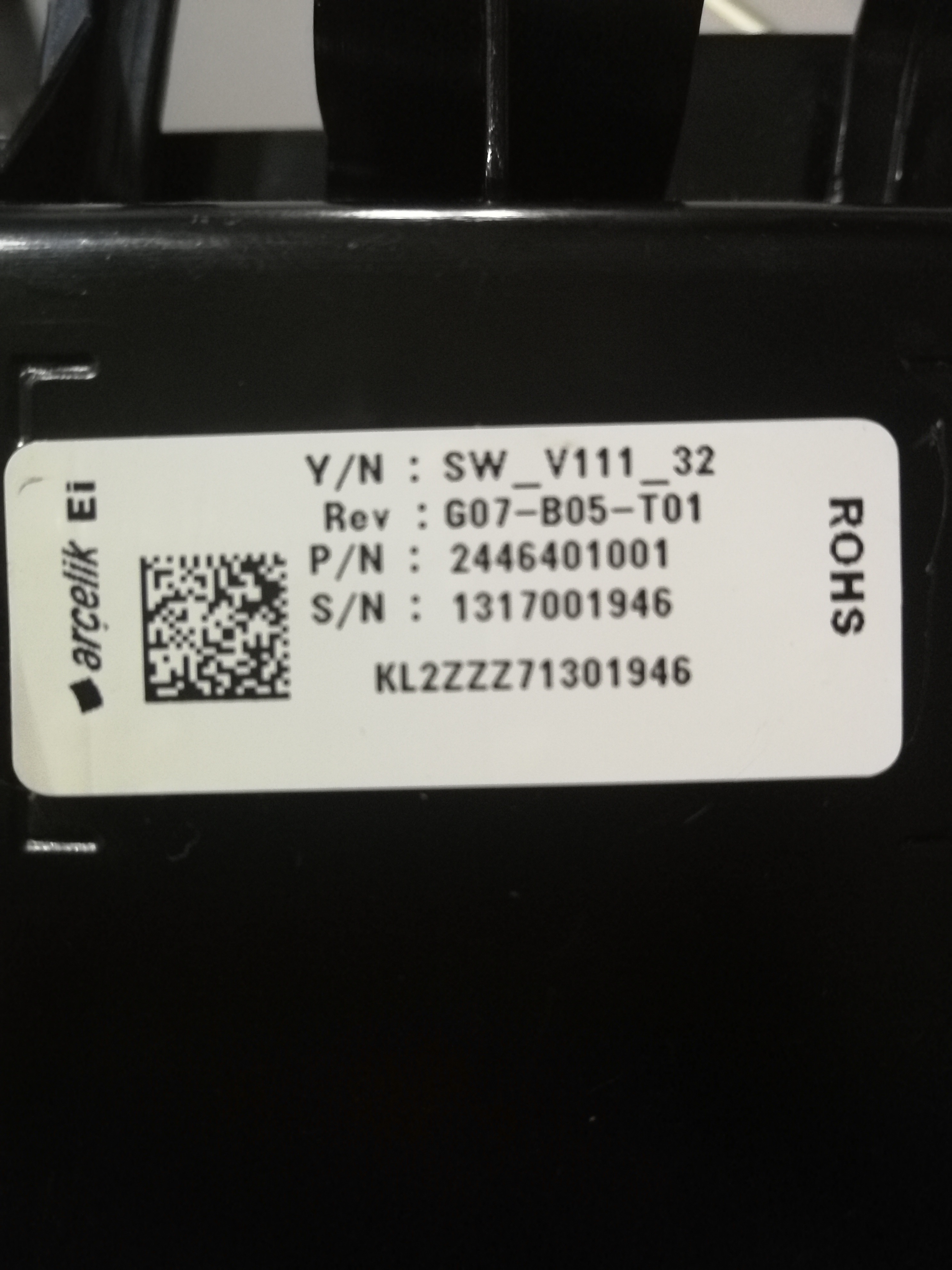

    Beko WDX8543130B. Załączony jest obraz numerów części PCB
    Suszarka Beko WDX8543130B - PCB martwe bez zasilania

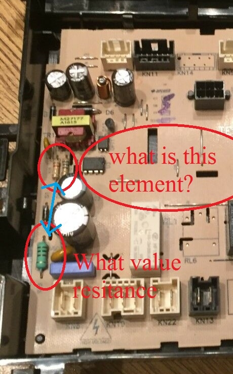

  • #5 17856078
    jaisunny
    Poziom 6  
    Posty: 9
    Ocena: 3

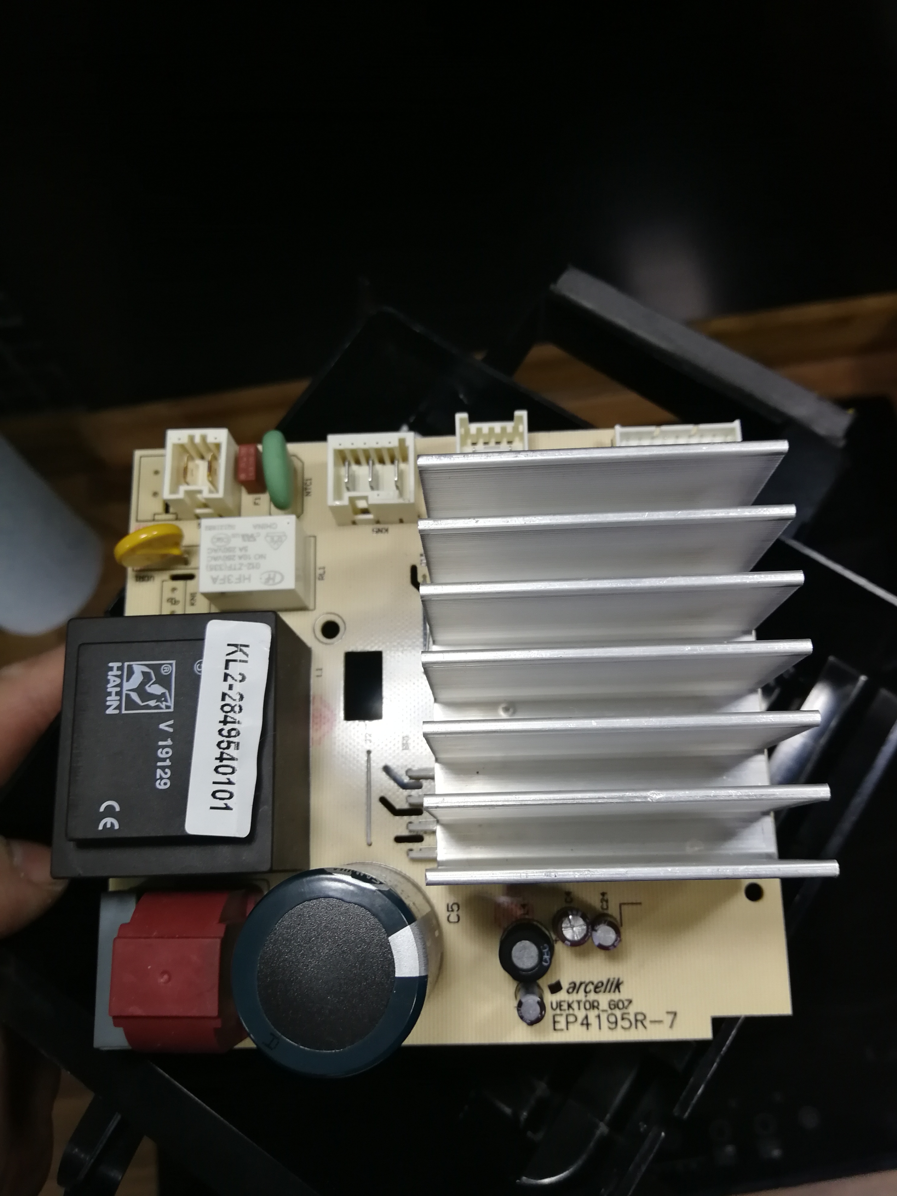

    Robo-technical napisał:
    Hi
    You problem is:
    - Power Integrations driver - LNK304DN
    Link
    - 2 you problem to Resistor of security driver. Please foto for:
    Problem LNK304DN I understand.
    Problem LNK304DN Rozumiem.
    Problem 2 = I didn't understand? please explain a bit more.
    Problem 2 = Nie rozumiałem? proszę wyjaśnij trochę więcej.
    I upload some more pictures.
    Przesyłam więcej zdjęć.
    Suszarka Beko WDX8543130B - PCB martwe bez zasilania Suszarka Beko WDX8543130B - PCB martwe bez zasilania Suszarka Beko WDX8543130B - PCB martwe bez zasilania Suszarka Beko WDX8543130B - PCB martwe bez zasilania Suszarka Beko WDX8543130B - PCB martwe bez zasilania Suszarka Beko WDX8543130B - PCB martwe bez zasilania

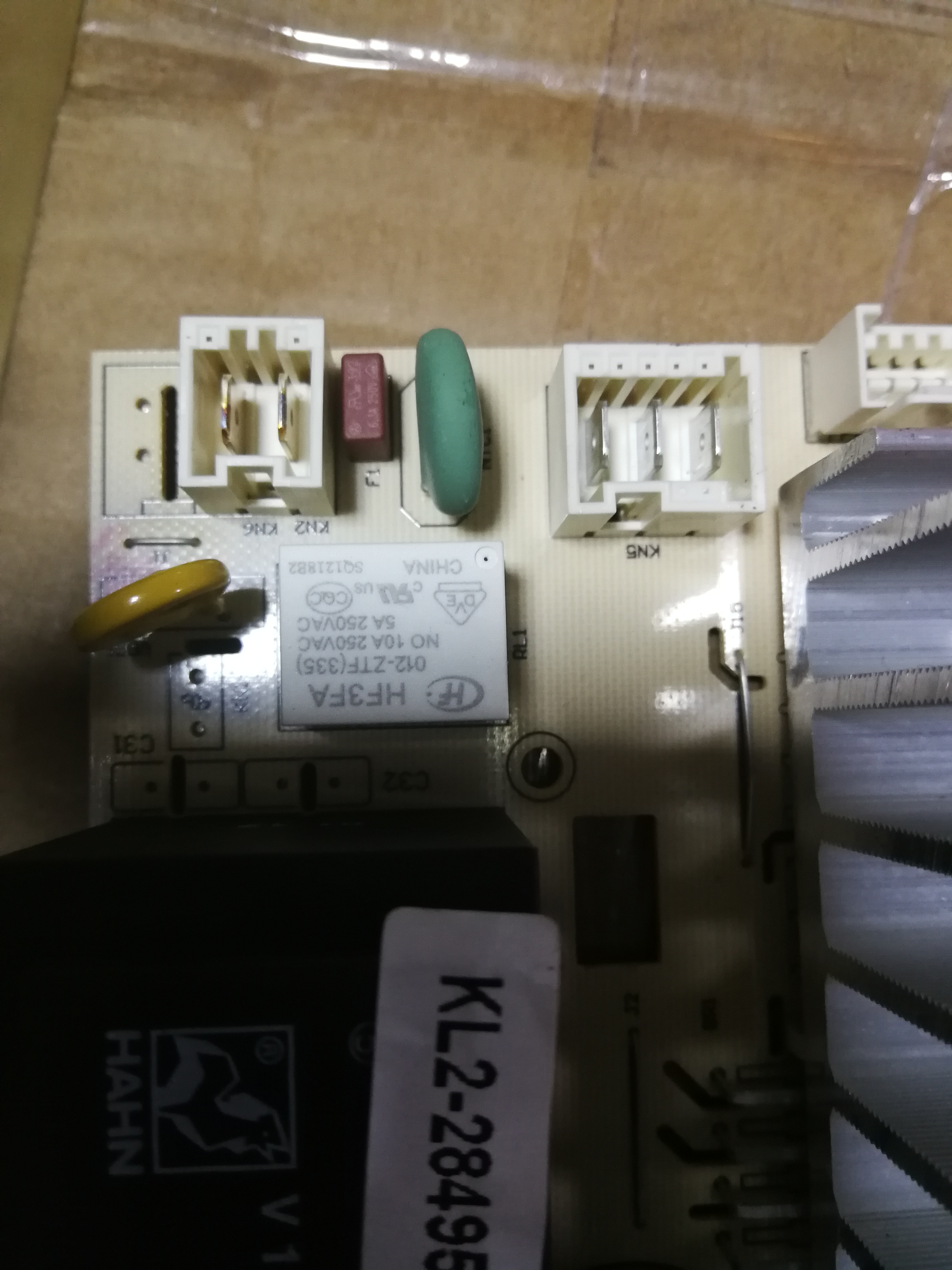

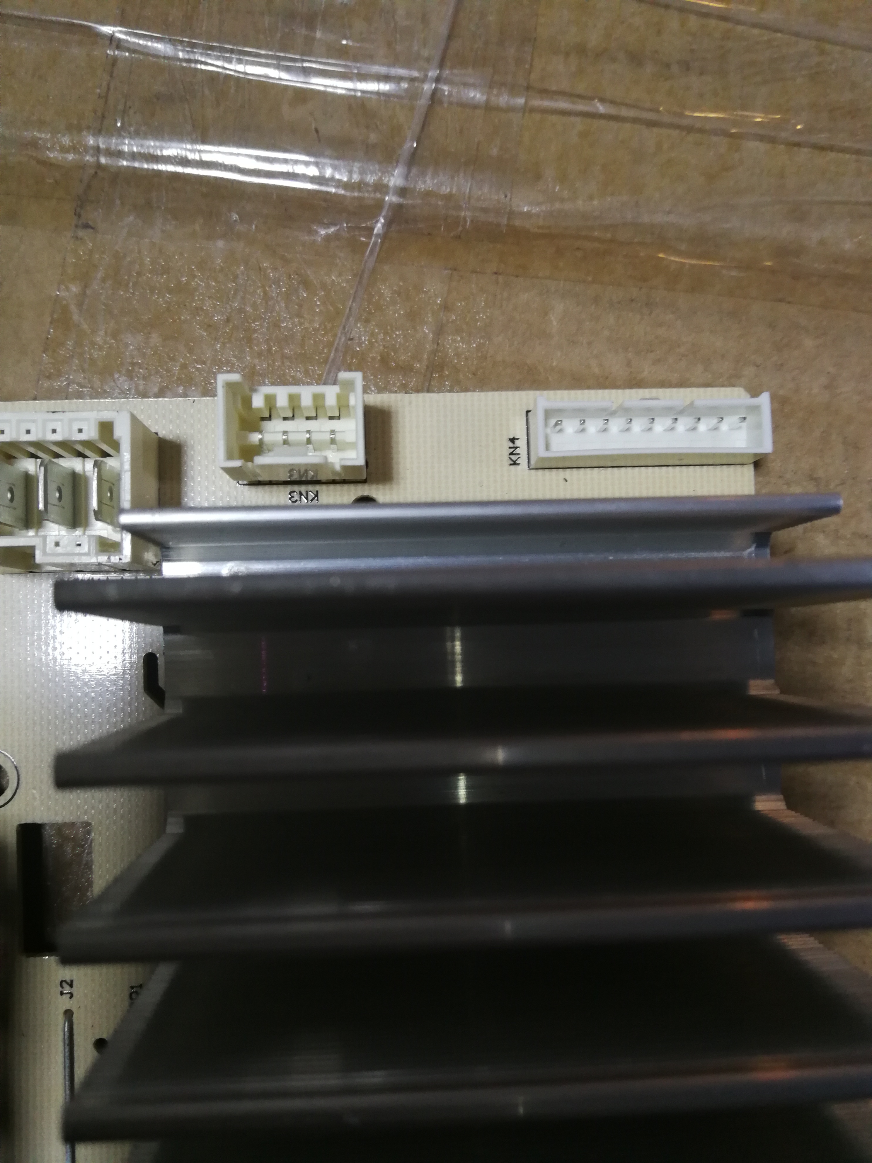

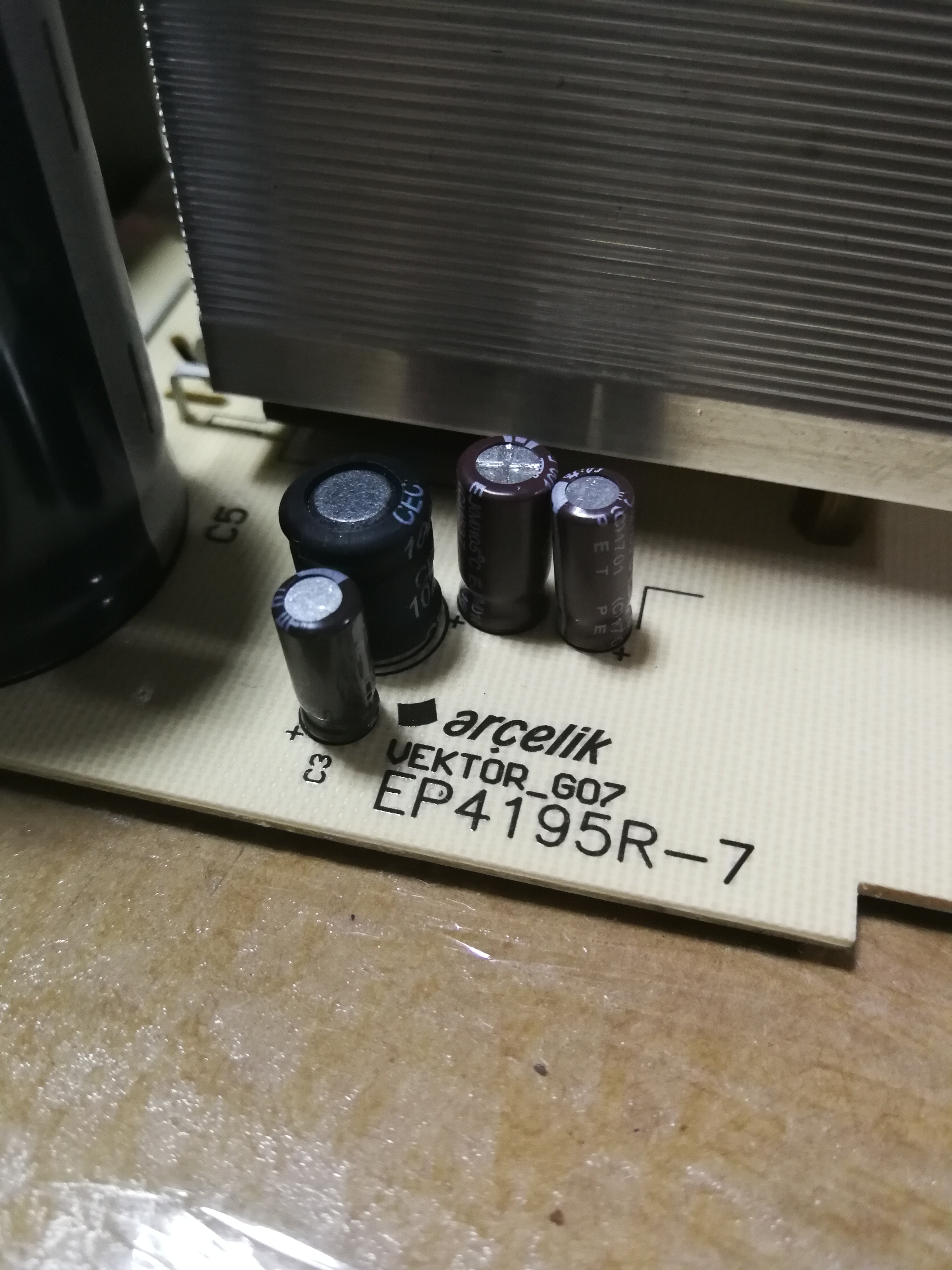

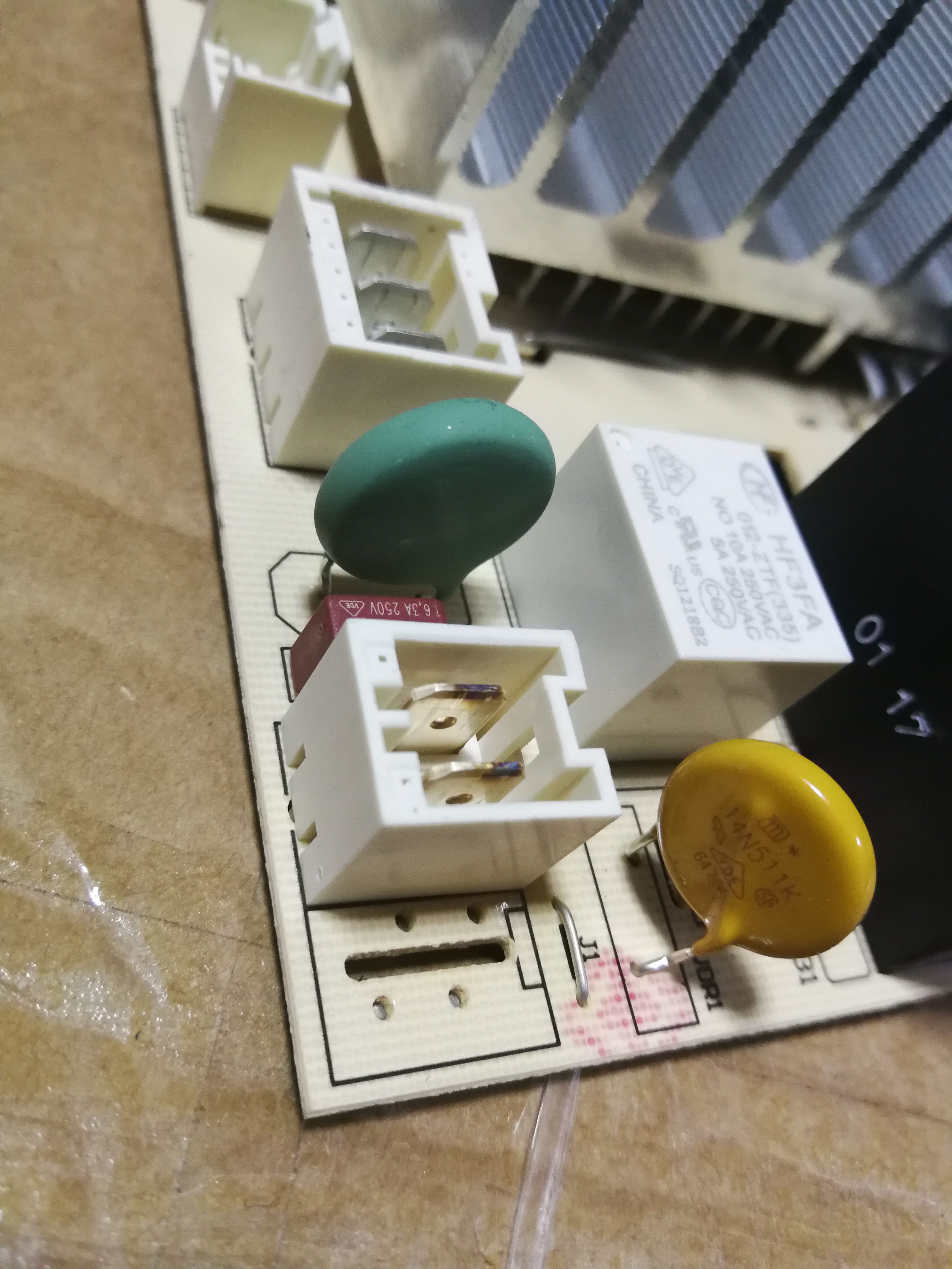

  • #6 17856096
  • #7 17856115
    jaisunny
    Poziom 6  
    Posty: 9
    Ocena: 3

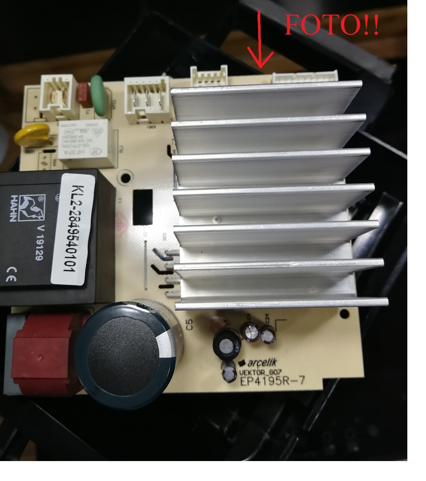

    Ok :)
    I do not see element electronical FOR/BEHIND metal aluminium radiator. I please foto area White Connektion socket - aluminium radiator (in red ring in picture)
    Sorry for my englisch. I do not akcess for translation :D
    Edit:
    I have a problem. I can not find resistors security.
    Mam problem. Nie mogę znaleść na zdjęciu rezystora zabezpieczającego
    No problem! I wish I could speak Polish!
    I updated the post above with more pictures. I hope it helps?
    Zaktualizowałem powyższy post, dodając więcej zdjęć. Mam nadzieję, że to pomoże? W czerwonym pierścieniu nie ma tam żadnego komponentu

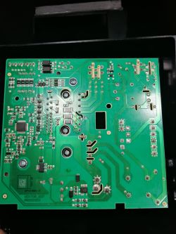

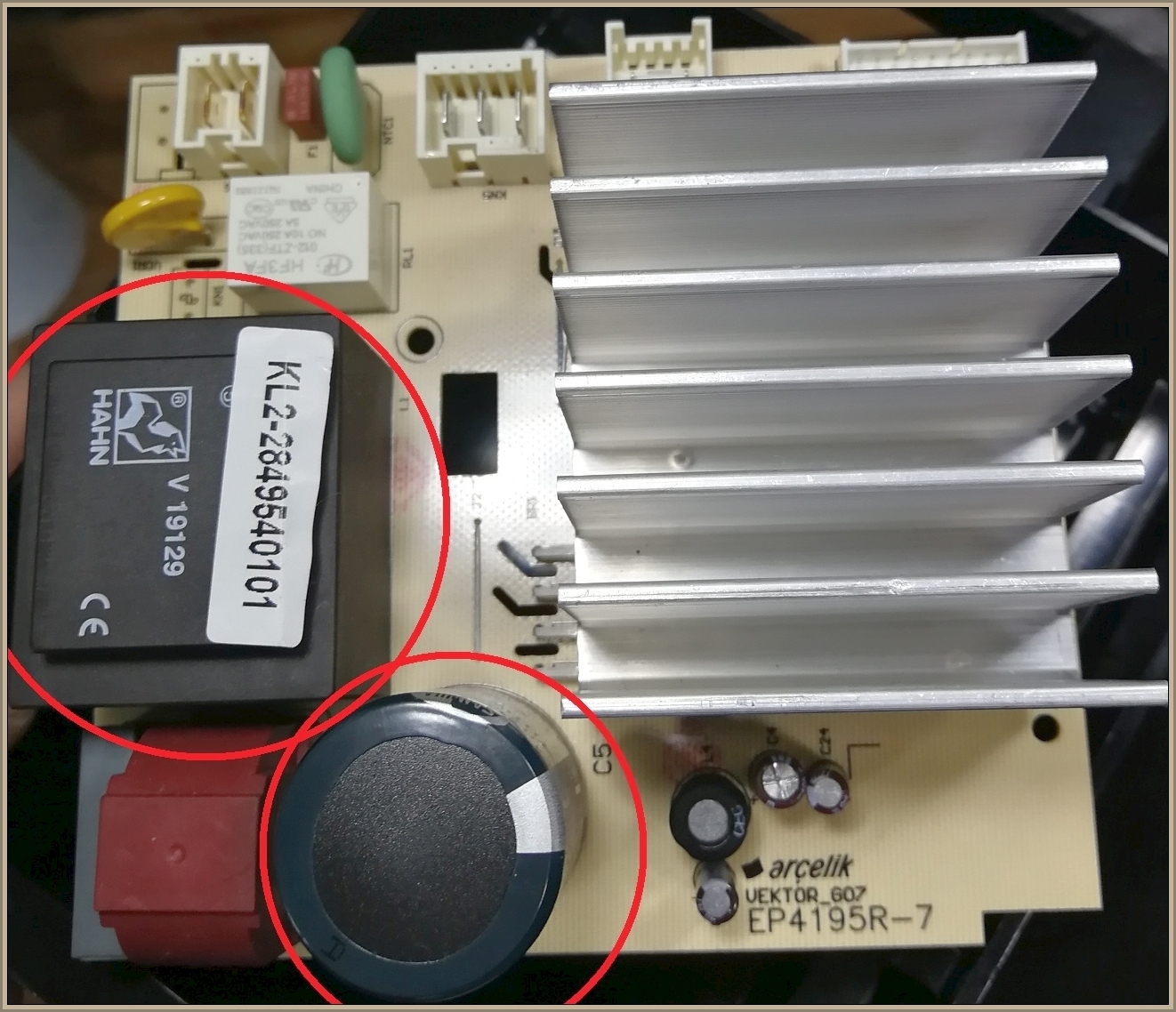

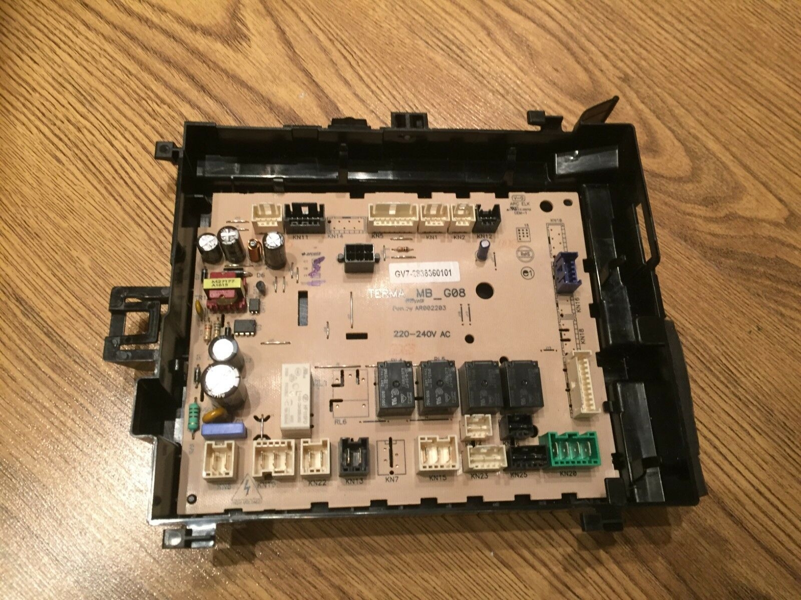

    Edit:
    I should also say, there is another board on this beko washer/dryer. I have attached it.
    Powinienem też powiedzieć, że w tej pralce /suszarce Beko jest jeszcze jedna płyta i załączam foto.

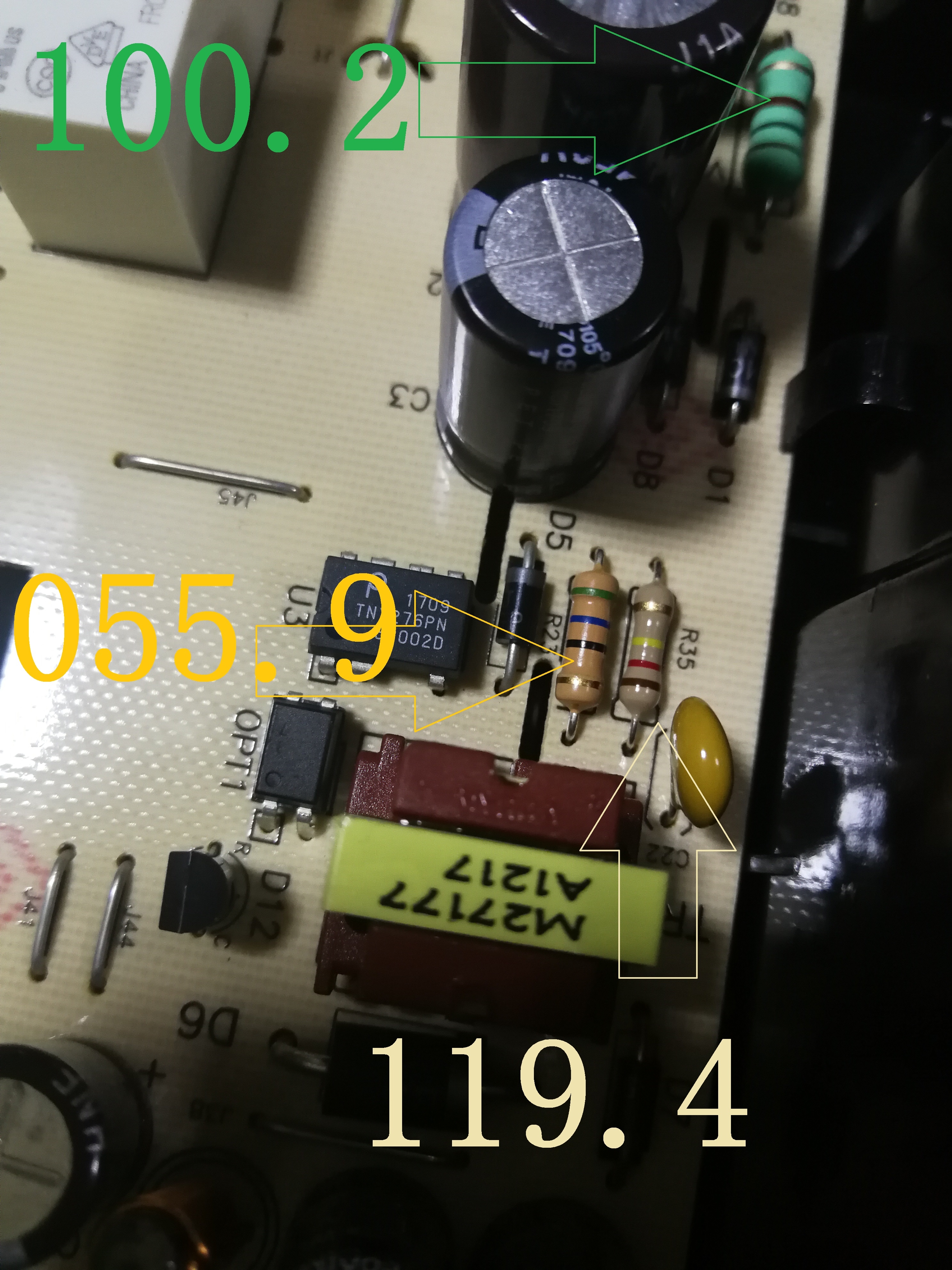

    In Pictures. I please value resitance resitors in red ring. I pleas name black componet in red ring

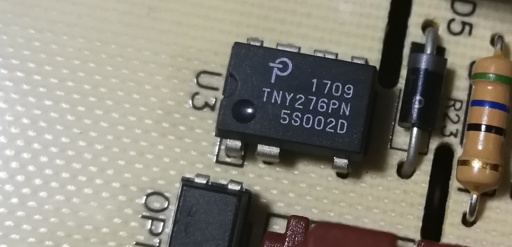

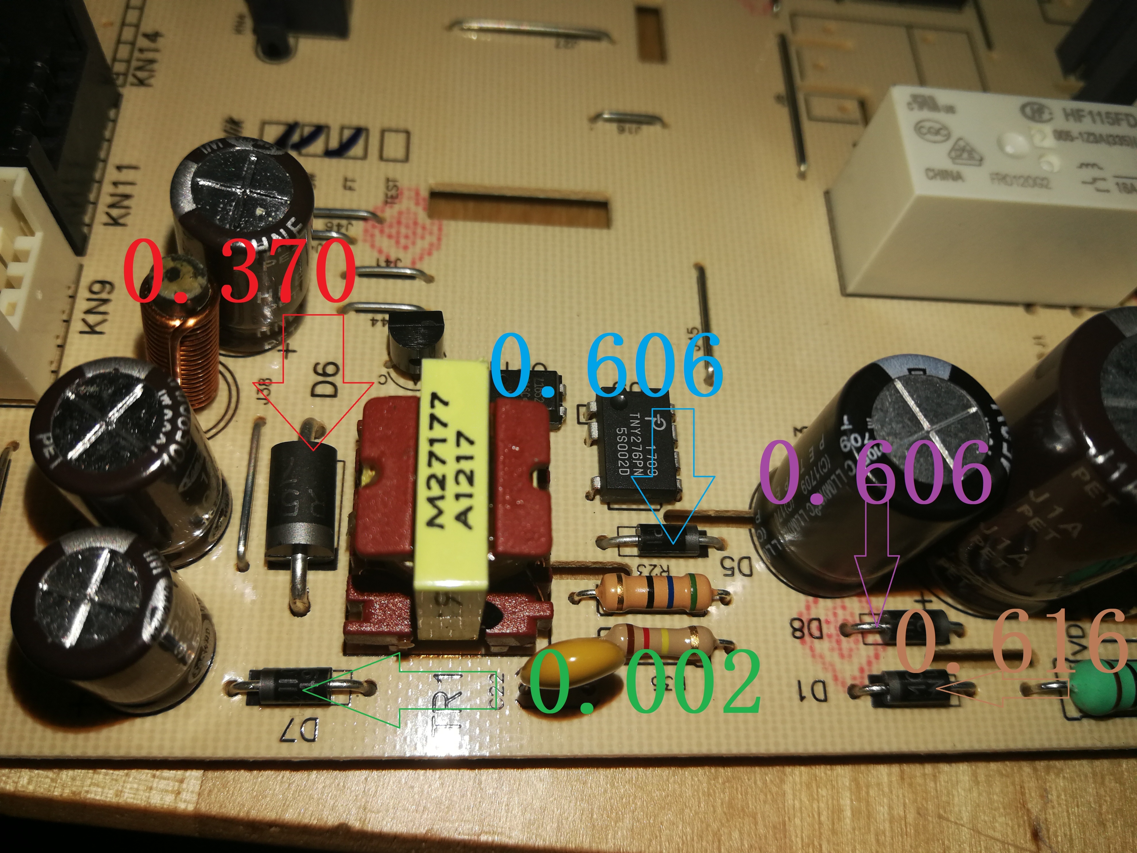

    Alles resistors is OK. My guess to; damage TNY276PN
    Do you think both TNY276PN and LNK304DN? What about Big capacitor and transformer on the first PCB board? What about Diodes. Attach picture is my readings...
  • #12 17856572
  • #13 17856603

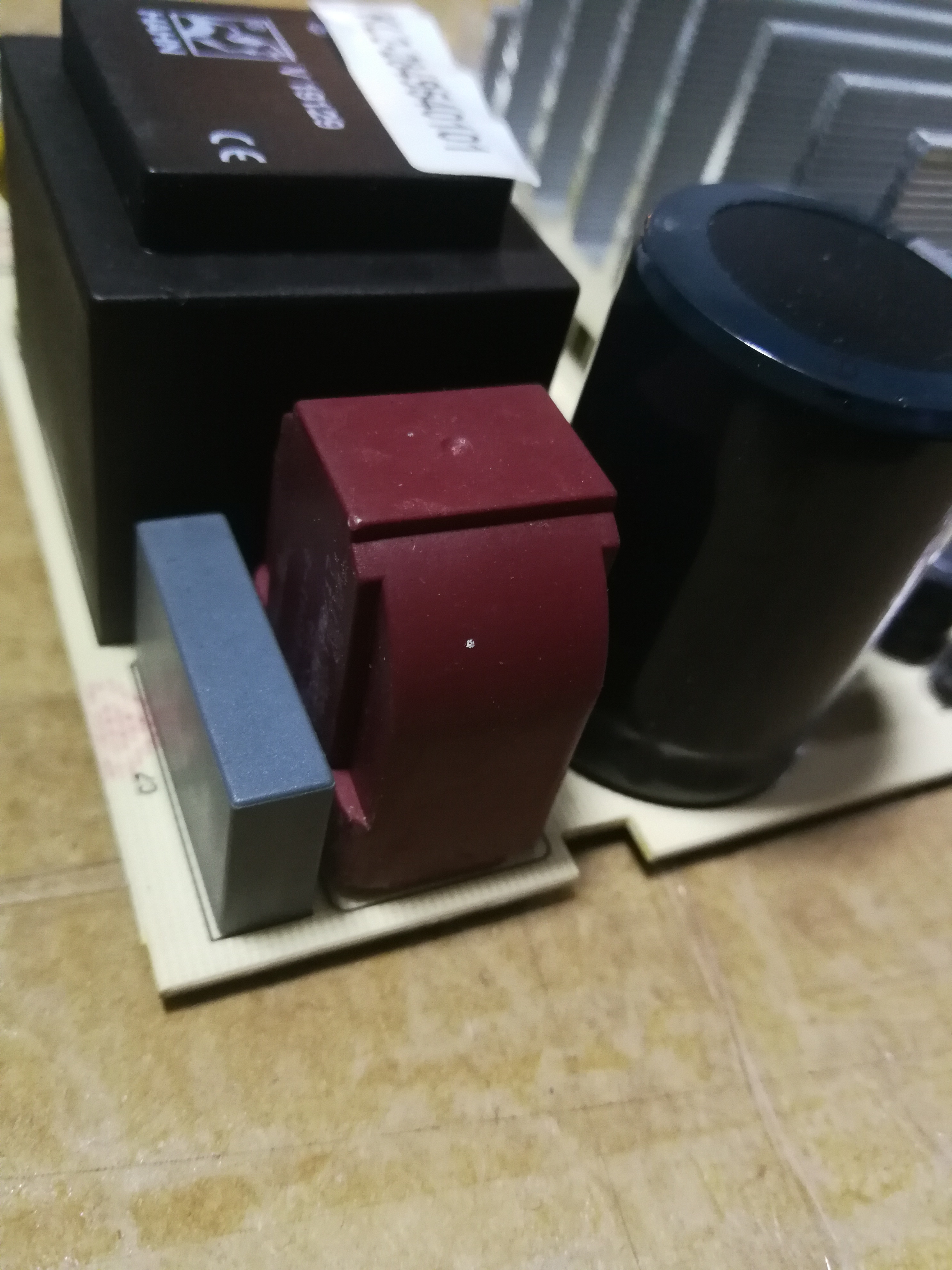

    jaisunny
    Poziom 6  
    Posty: 9
    Ocena: 3
    TNY and D7 diode I will replace. Thank you for the help on that! About capacitor and transformer... attached... Bad diode is removed now. It reads on it SR110 649y do you know where to get a replacement?

    I don't think burning. both boards have this red marking on them all over.

  • #16 17861108
    jaisunny
    Poziom 6  
    Posty: 9
    Ocena: 3
    Diode replaced and washing machine now back working fully.
    Big thanks to all that helped me along the way!
    Wymieniona dioda i pralka teraz w pełni działa.
    Wielkie dzięki za wszystko, co pomogło mi po drodze!
