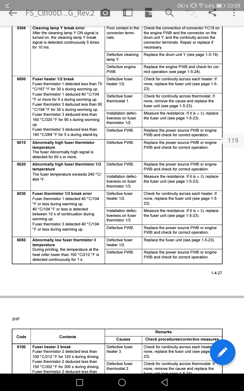

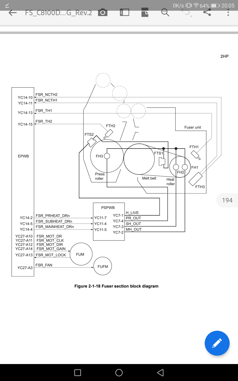

    Hello,
    I have call service 6030:0026655
    If anybody have service manual. Please send igorbirokip(_at_)gmail.com
    I was replace fuser and reset error and work fine but whan i switch on cold device i have error
    Thank You
