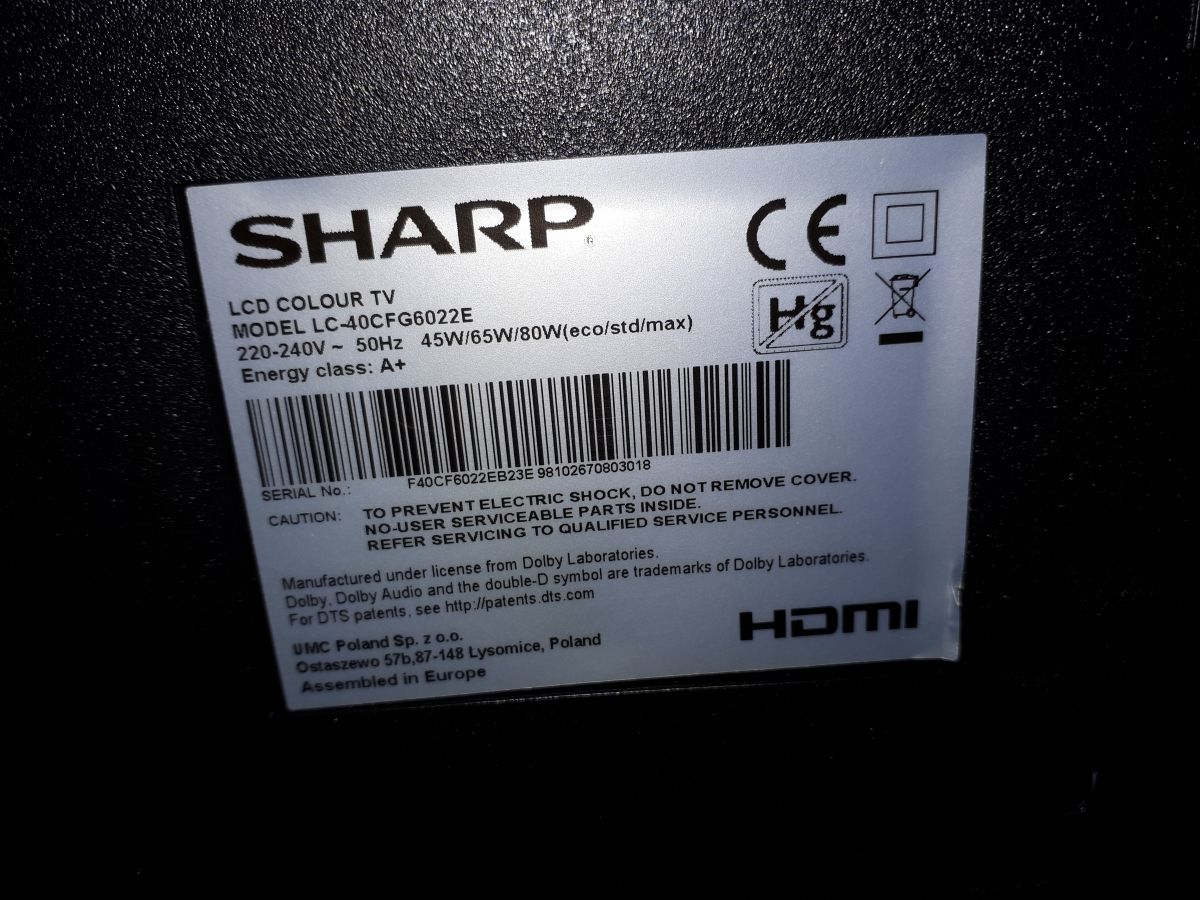

    Wstaw kolego zdjęcie tabliczki znamionowej tv.

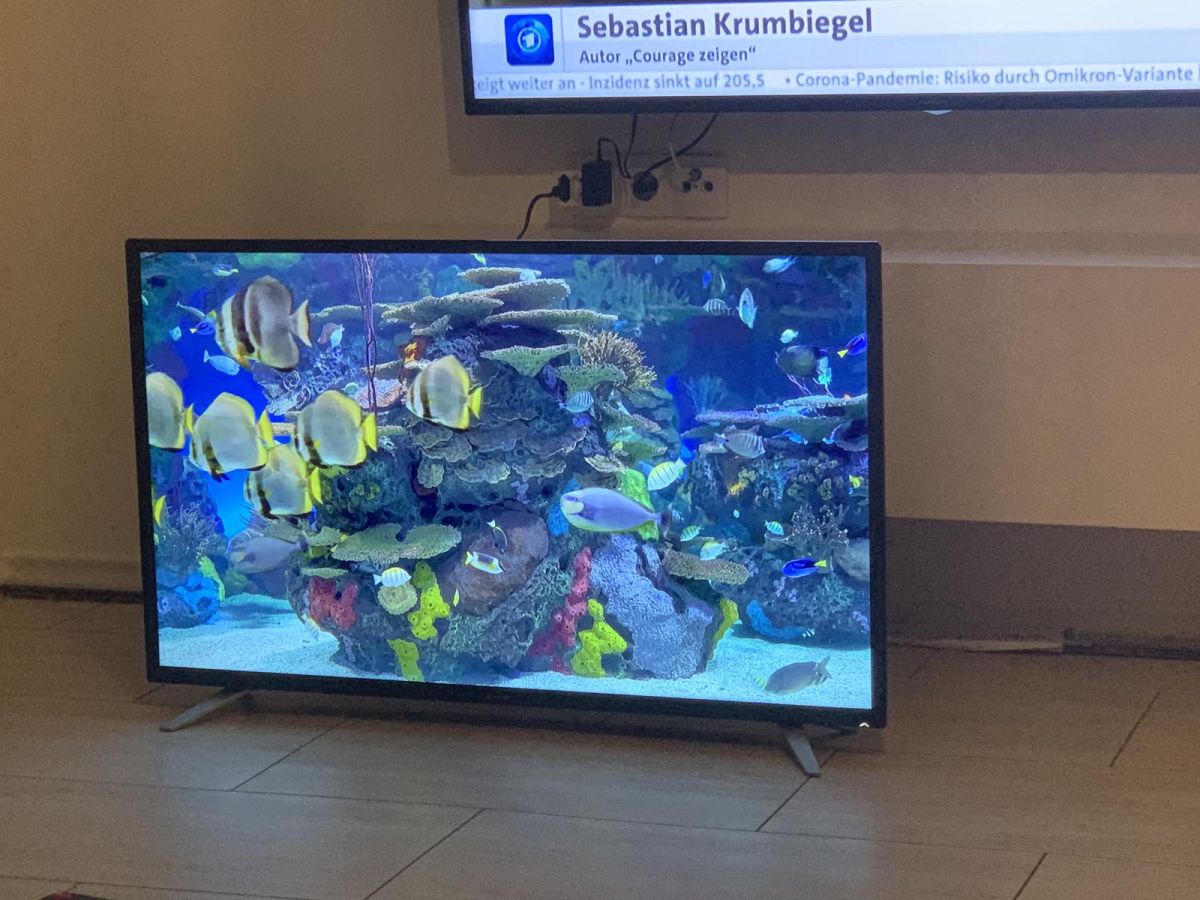

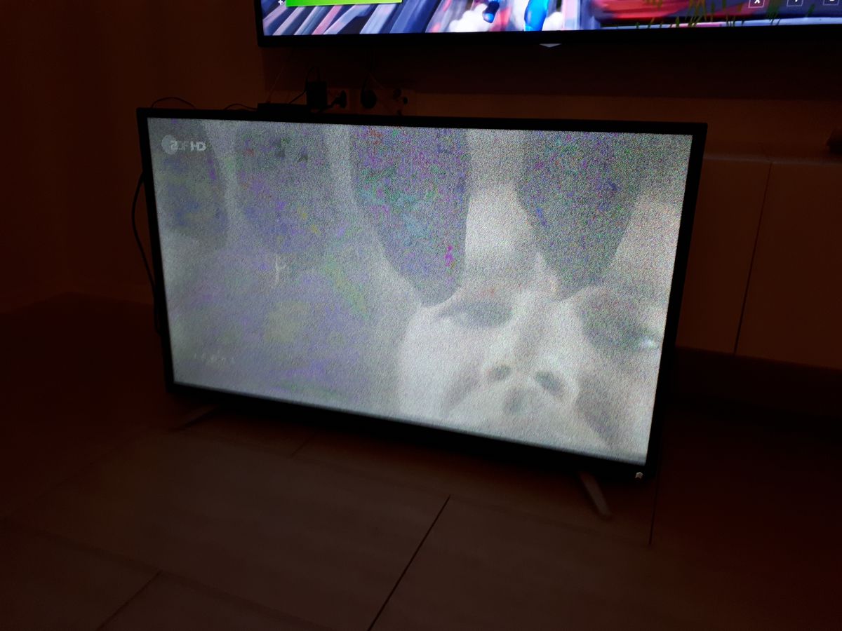

    Poszukiwane oprogramowanie do telewizora Sharp LC-40CFG6022E
    problem polega na tym, że obraz nie jest czysty, zmieniłem płytkę t-con, a paski nadal są tym samym problemem, proszę o pomoc

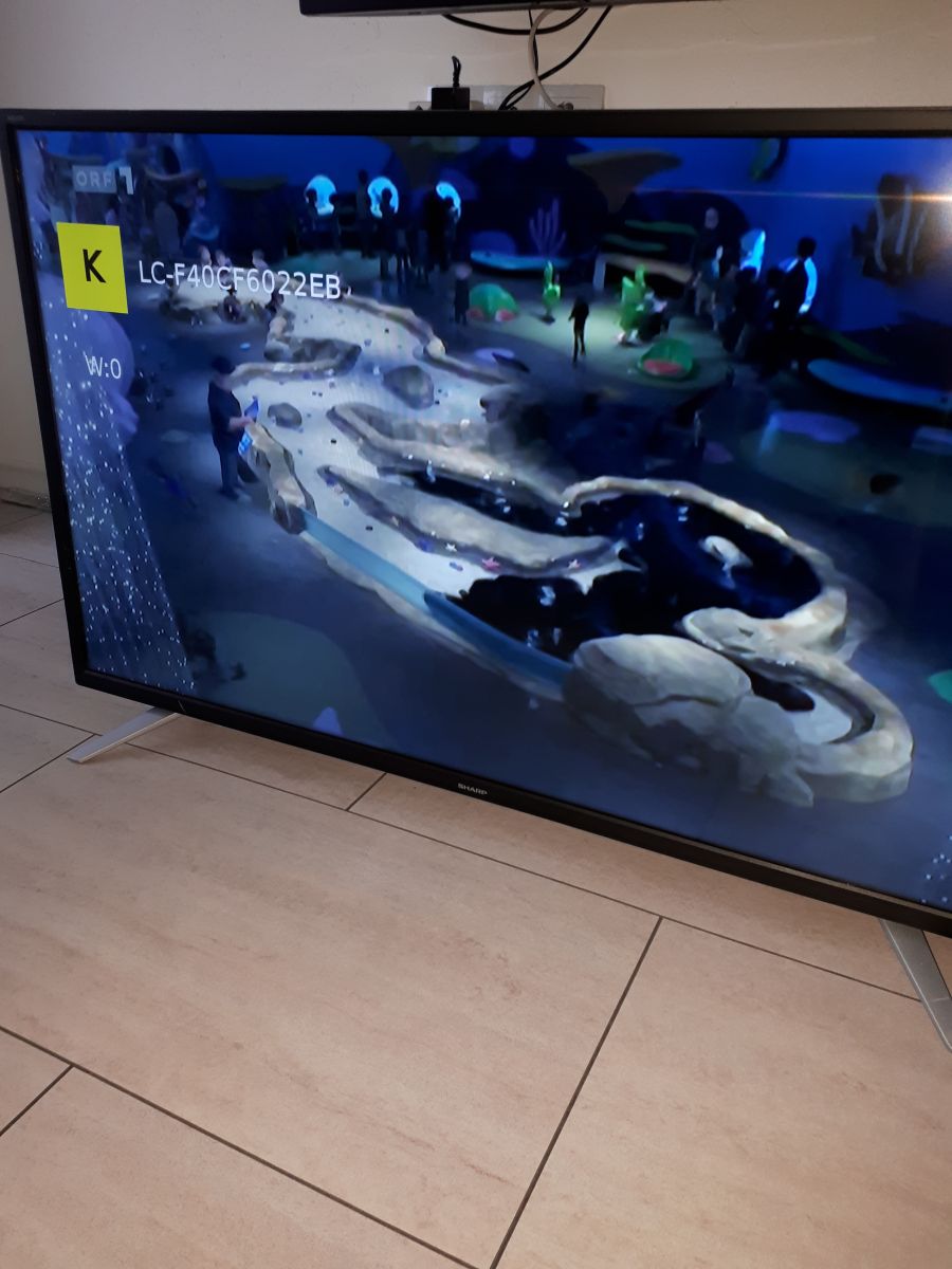

    the picture is clear, yes, there is a K on the left side and I reset it 3-4 times, but it is the same, even the remote control does not answer

    after the upgrade/restore software procedure, the remote control may not work: you have to pair it with tv
    the pairing procedure may change from a model to another, try this solution
    tv in standby mode
    press and hold the GREEN and RED buttons on the remote control for a few seconds: the standby led will blink 3/5 times to confirm the pairing
    if it doesn't work, try again with the YELLOW and BLUE buttons, or YELLOW and GREEN buttons, eventually try with other combinations of the colored buttons
    if a letter K appears on the screen: tv is in factory mode
    after, when the remote control is paired, enter in service mode with the sequence MENU 1147
    select Init TV or Shipping Init and press ok to reset the tv
