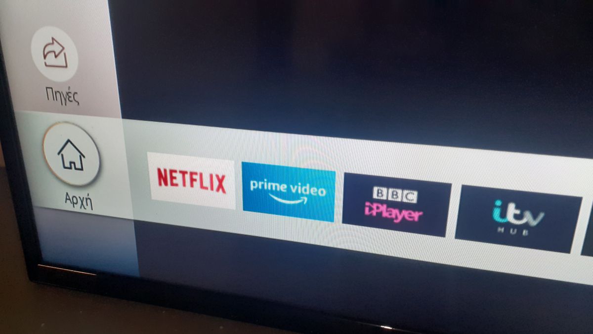

    Guys,Please help..I replaced the damaged 17mb211s m/b from my TV with a used one but unfortunately the screen is flipped and the gamma correction is very bad.Probably the firmware is for another type of panel.Is it possible to help me program the m/b to fit on VES490UNDL-2D-N11 Panel?
    Thanks in advance!

    You have the panel profile. Do you know the installation procedure?

    Thank you so much sir!I am not sure,I have read a lot of procedures regarding these issues,can you write to me the steps?

    1. format a stick with fat32
    2. Create a folder on the stick called PQ
    3. unzip and put the 2 files in the pq folder
    4. turn on the tv and insert the stick into the usb
    5. type MENU 4725 and go to USB Operations
    6. Type ok on the remote control and wait 5 seconds
    7. Exit the menu and turn off the TV
    8. unplug the TV for safe operation
    9. remove the stick and turn on the tv. It has to start right.

    You are great! Many thanks!! This afternoon I will let you know!! Best wishes to you and your family.

    It's all yours!! Thanks a lot..!!!!
