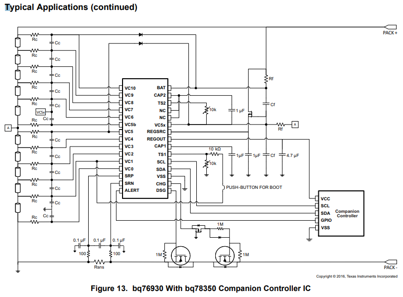

potrzebuje wykasować błedy w ukladzie BQ7693003
Czym to mozna zrobić ?
wiem ze jest EV2400 ale cena .

Nie, dziękuję Przekieruj mnie tamCytat:read the manual for bq769X0, When battery voltage imbalance occurs, the OV bit of SYS_STAT is written to the internal EEProm,reset SYS_STAT for internal EEProm is not enough(The status register bits are cleared by writing 1 to the set bit. To clear all bits, write 0xFF to register 0x00),the AFE requires control by the host to recover the system from the fault.
The host must turn on the FET controls after appropriate recovery delay or conditions.
https://www.ti.com/lit/ds/symlink/bq76940.pdf...f_url=https%253A%252F%252Fwww.google.com%252F
https://www.ti.com/lit/ug/sluub41a/sluub41a.pdf?ts=1654244422766
