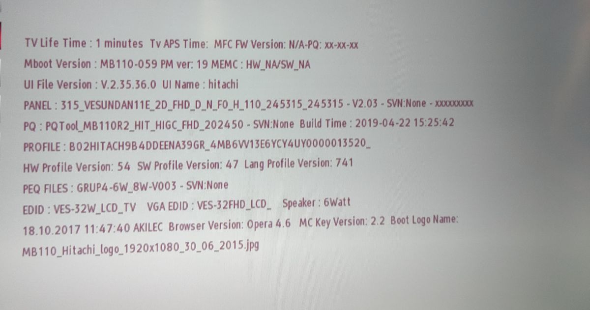

    Hi,
    Every time i open tv appears first time instalation menu which cannot be avoided !!
    I try factory reset and other tricks but i have stiil the same problem.
    Any help??
    Zrzut ekranu z informacjami technicznymi telewizora Hitachi.

    Did you rewrite another software? The TV has 1 minute of operation.

    You rewrote another full software and the TV counter restarted. It has one minute of operation.
    If you have a programmer, I have the BIN for the flash memory. I don't know if it solves the problem, but you can try.

    I have nothing for the stick. Try a factory reset: MENU, 4725, Diagnostic, Factory Reset, OK, return (exit), power.

    I did that . ...no solution
    Thr problem is the firmware or the motherboard??
