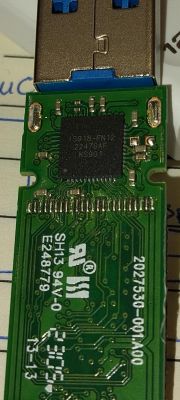

    Hi,
    Is there a tool to convert this 128 GB Pendrive to Local Disk?
    I have read that you need MP Tool for this. Anyone has it? It is a new Pendrive (2024) with new controller. Not detected with ChipGenius, but I opened the device and it has IS918-FN12 controller:
    Zbliżenie na płytkę drukowaną pamięci USB z widocznym kontrolerem IS918-FN12.
    ChipGenius v4.00 shows this information:
    Description: [F:]USB Mass Storage Device(Kingston DataTraveler 3.0)
    Device Type: Mass Storage Device
    Protocal Version: USB 3.20
    Current Speed: High Speed
    Max Current: 144mA
    USB Device ID: VID = 0951 PID = 1666
    Serial Number: E0D55EA574A6173179360588
    Device Vendor: Kingston
    Device Name: DataTraveler 3.0
    Device Revision: 0110
    Manufacturer: Kingston
    Product Model: DataTraveler 3.0
    Product Revision: 0000
    Controller Part-Number: Unknown
    Thanks!

    This chip requires Innostor IS918 MPTool GA 230908C (V.23.0009.8.1)
    Checked the "HDD Option", programmed it - WORKS!
