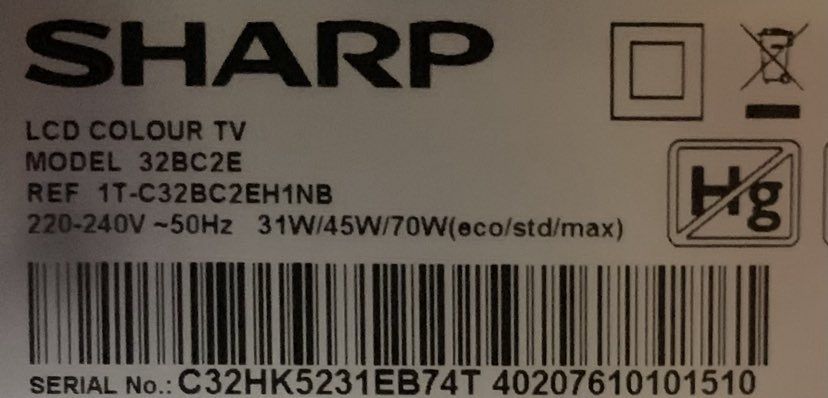

    mainboard should be a TP.MS6486X.PB713
    what's the panel code?
  • #5 21457555
    MacaoMO
    Poziom 3  
    Posty: 6
    >>21412538
    Etykieta telewizora Sharp LCD z modelu 32BC2E z informacjami technicznymi.
    Proszę bardzo.
  • #6 21457963
    Telo
    Serwisant RTV
    Posty: 13186
    Pomógł: 1538
    Ocena: 2388
    Trzeba rozebrać to nie jest zdjęcie tabliczki panelu lcd.

    #9 21458809
    billobirillo
    Poziom 33  
    Posty: 1142
    Pomógł: 338
    Ocena: 801
    according to partlist
    model 32BC2E product code C32HK5231EB74T
    main TP.MS6486X.PB713 panel LQ315T3HC6U
    this software is for model 32BC2E product code A32HK5232EB76Q, same main and panel as your
    try it
    copy the files UMC_6486x_aes.bin and UMC_KMODE.txt on an empty usb stick
    insert the usb stick in the tv, then plug the AC mains, and then switch on the tv: an update bar should appear
    if it doesn't work, most probably nand or micro are damaged
