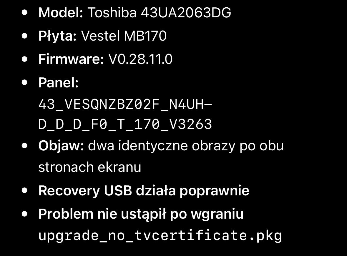

    Hello.
    Thank you for your reply.
    My TV is:
    Toshiba 43UA2063DG
    Main board: 17MB170
    Firmware: V0.28.11.0
    Panel: 43_VESQNZBZ02F_N4UHD_D_D_F0_T_170_V3263
    The TV was not starting (red/green blinking LED). I installed upgrade_no_tvcertificate.pkg and now the TV works, but I have two identical images side by side.
    Could you please send me the correct USB recovery firmware for this exact panel?
    Thank you very much.
    Thank you.
    My panel shown in the service menu is:
    Do you think your firmware is compatible with this panel, or do you have firmware specifically for this panel?

    Firmware installed successfully (100%). The TV restarted and completed first-time setup, but the screen is still duplicated (two identical images side by side). My panel is 43_VESQNZBZ02F_N4UHD_D_D_F0_T_170_V3263. Do you have another firmware specifically for this panel?

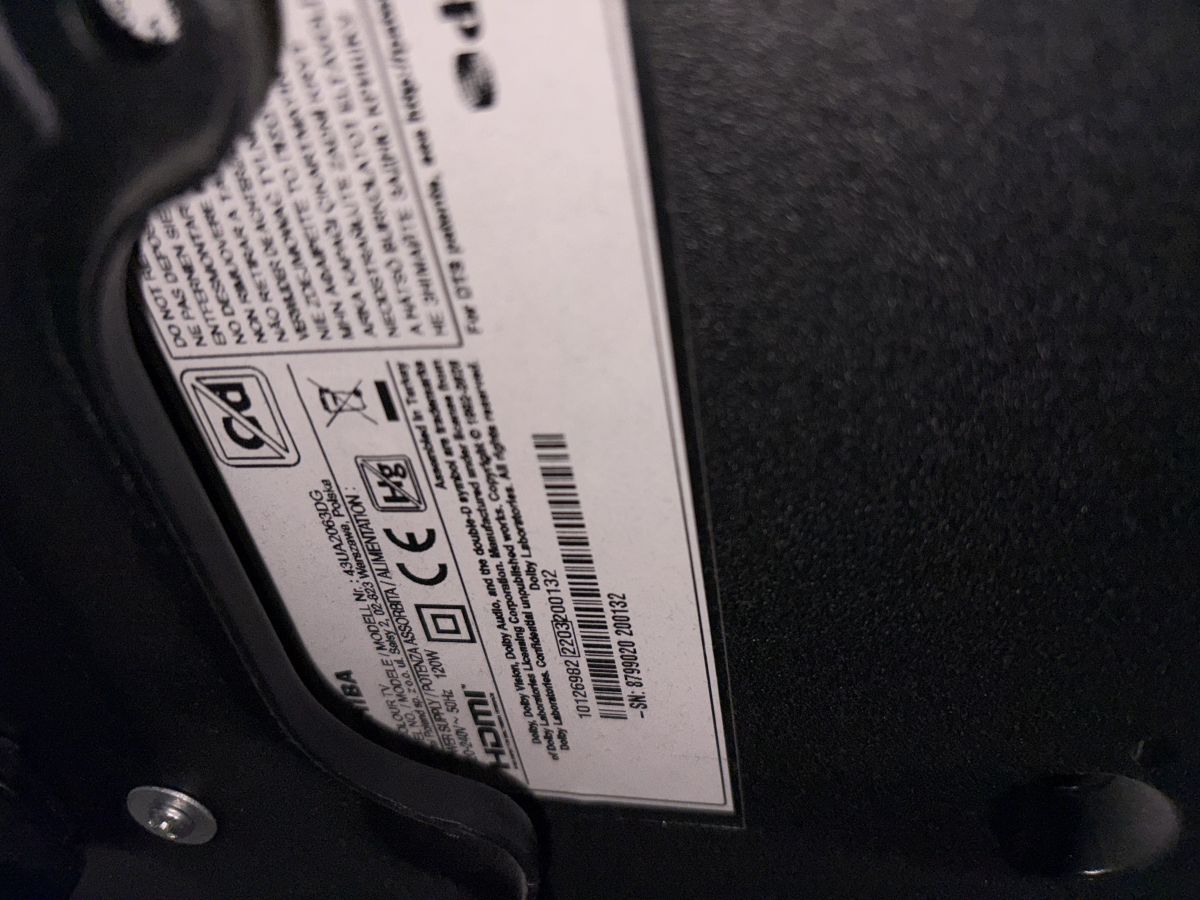

    post a photo of the sticker on the back of the tv

    Here is the sticker from the back of my TV.

    you need a software for panel VES430QNDH-N2-N42

    You entered the wrong panel code. The code you posted is the one displayed *after* the software was incorrectly rewritten. The original code is the one posted by our colleague billobirillo.

    Thank you very much. Could you please send me the correct software for panel VES430QNDH-N2-N42?

    I found this one, for an Electronia model: same mainboard and same panel, but never tested by myself
    here is the software link
    it works, but I don't know the final result on the image, because the tcon is little different: PT430GT01-3 instead of PT430GT01-1

    I wanted to sincerely thank you for your help and for taking the time to find the correct software for my TV.
    I installed the firmware you provided, and it worked perfectly. The TV is now working correctly, and the duplicated screen problem is completely gone.
    I really appreciate your kindness, patience, and expertise. Thank you very much for your help!
